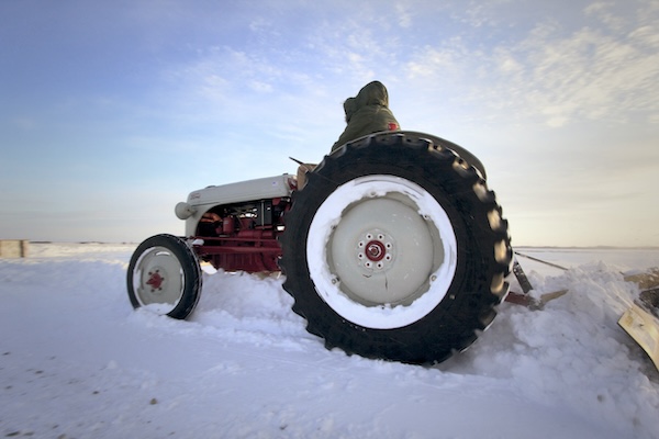

Shorten the top link to roll the blade forward a bit. I never tried the pipe trick, but it sounds like it would be a good idea, too.
I had it rolled a bit too much in the pic below, but it was still moving snow! -10°F, was thankful for that mil surplus parka!
