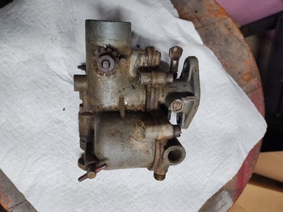

My 1954 TEA -20 has a cracked carb body.
Just getting it ready to try, as I got it in seized condition.
My Q is,
If this carb is not going to work, does anyone know what the carbs are like we see on Amazon for the TEA 20?
THey seem a bit less expensive that those out of the UK.

Replacement carbs of overseas manufacture get mixed reviews on this forum. The bodies will be alloy instead of iron, quality control questionable. The price is right....
About three threads down on this Harry Ferguson forum is a thread about TEA carburetors. It was revealed that while most had Zenith carbs, at least some came with Marvel-Schebler. Which does your tractor have? I'd be inclined to search for a used OEM unit and purchase new as a last resort.
If it is an alloy bodied Zenith then replacement is probably the only long term option . The replacements from the UK are made by the same company and to the same standards , by all accounts they are well worth the extra money and are a straight bolt on replacement.
If it is a Marvel Schebler carb then consider having the cast iron crack repaired by bronze . It is a simple task for an experienced welder and will save you time and money .

The one I have is an alloy bodied Zenith.
If I Do require one Charles, I will go with the proper one then.
I have been messing with it a bit, had it all apart and cleaned it, but it seems it was cleaned and no fuel through it, then sat a lifetime and engine seized through standing.
In other words, no gumb in the carb, all dry and clean.
However, after I checked it all out, it still floods, but hard to say if it is the repaired crack causing this, (Looks like JB weld) or whether it is the needle valve/float.
Will take it to bits again, see what's up.

Only very late carbs were cast iron and very few at that in the UK and most overseas markets .
Check the needle and seat for leaks and the float for sticking and pin holes . They are simple carburettors and don't take much to fix . If the crack is in the bowl then a repair is most likely going to hold , butterfly shaft and jet seat areas are more difficult .

Took this one off again, and it doesn't seem to be leaking from repaired area around bowl.

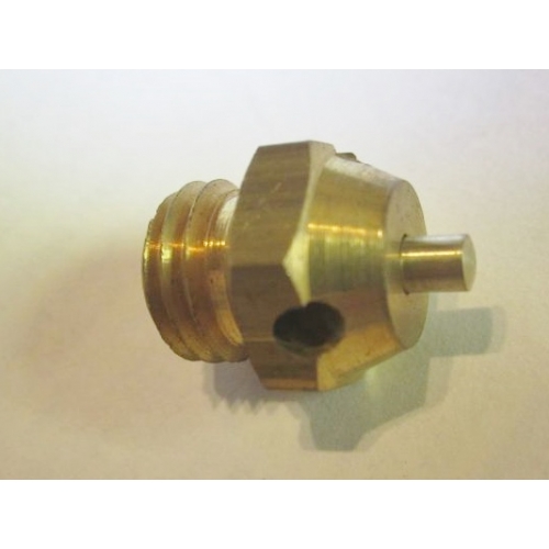

Thing is, this one has the needle and seat arrangement where you can't get them apart so it seems. the needle goes in from the top of the brass fitting, then the seat seems to be pressed into place over it.
No holes in the float, and its the right way up.
Put it back together and tried it, and it ran!....But only for a few seconds as no water in it.
stopped it, and the petrol poured out again from the choke butterfly area.

Needle not sticking and float not sticking. Pours fuel out like water though!
An extremely rough and ready ' Farmer's ' diagnostic not recommended but works as a diagnostic . Once out smack the needle down onto the seat with a piece of wood , this deforms the seat and helps it seal . It's a last ditch field repair to use when you are sure the seat is clear of debris . It won't work permanently and probably won't stop the leak completely but might help until you can replace the needle and seat . Be sure the float pivot isn't snagging as well .

Edited to show needle valve /seat set up.
Richard, if you were using the choke to get it started, and you only ran it a very short time, the engine did not have enough time to clear the spare gas out of the intake that was created by using the choke. Don't be too concerned about that until it does it after warming it up and running it for a while. Then, if it is still doing it, check the float level.
Thanks Charles, Tom , and Stevie.
This type of float doesn't have a pivot Charles, it just floats up and down in its chamber.
I did give it a bash as you suggested, and providing l don't choke it too much. It doesn't seem to flood!
Early days yet though!
Nothing to interfere with the float. Steve,
The repair seems to be where main jet fits.

Ah yes the Zenith free float . I sometimes get confused between the TEA 20 and FE 35 Zenith carbs , both very different .
Glad the bash it and see stop gap worked , even if it only slowed the leak down a bit it points to the seat and needle being the likely culprit . Be careful in unscrewing the old one , they sometimes gall in their socket and take a bit of colourful language and patience to remove . Once a new one is fitted also true up the mating surface of the bowl on a piece of plate glass and wet and dry paper to ensure the joint doesn't weep .

Thanks again, and needle and seat screwd out clean as a whistle.
