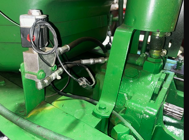

All my John Deeres that have the closed center system has an electric destroker installed. The cost of this is cheaper than beating and replacing batteries. Pic of the destoke kit on my 4520 in question
