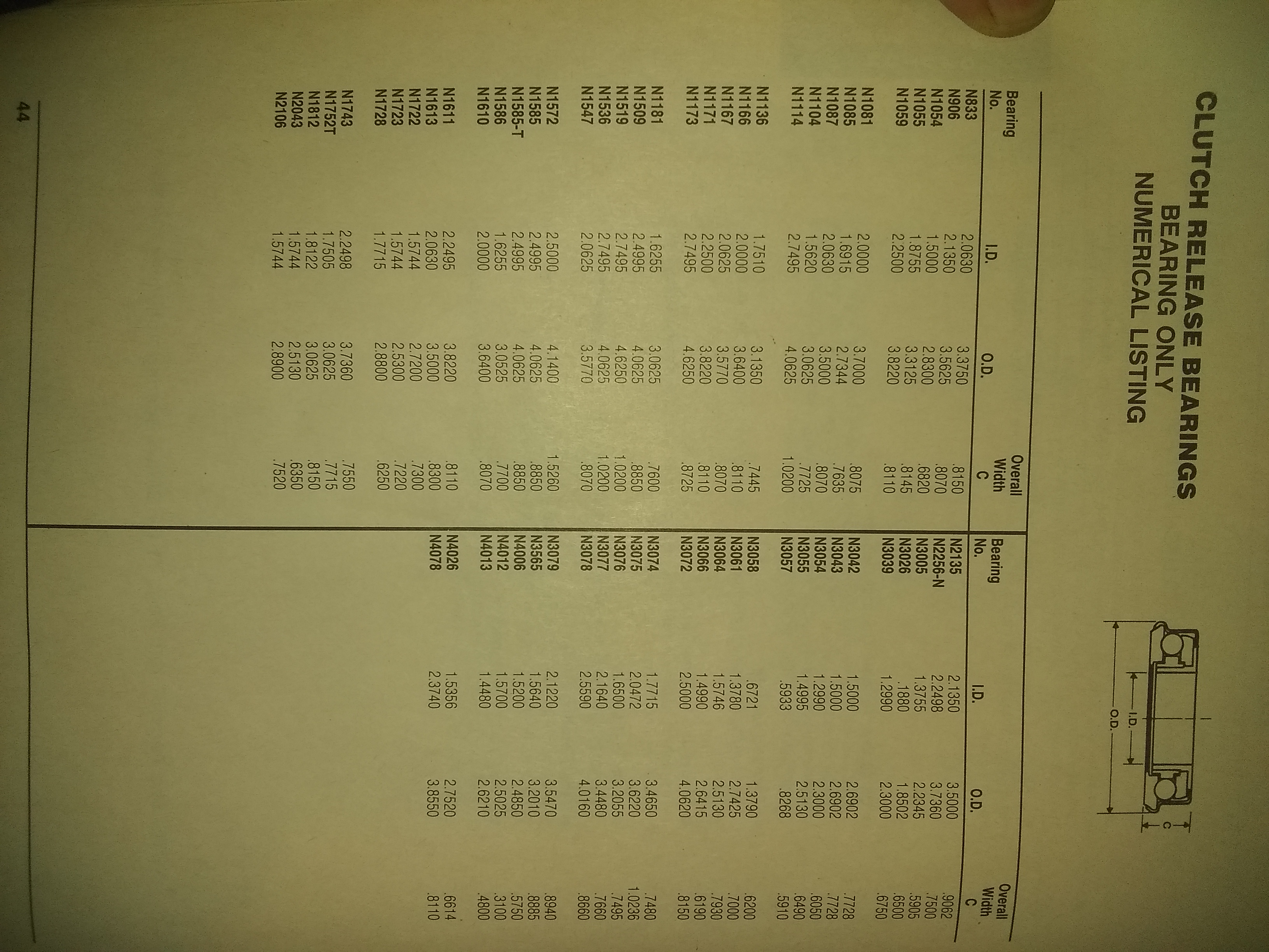

Can you find something by dimension in the chart above?
I'm probably going to machine a top hat bushing/sleeve this weekend in the shop, to the bearing size that was sent with the new clutch kit.
