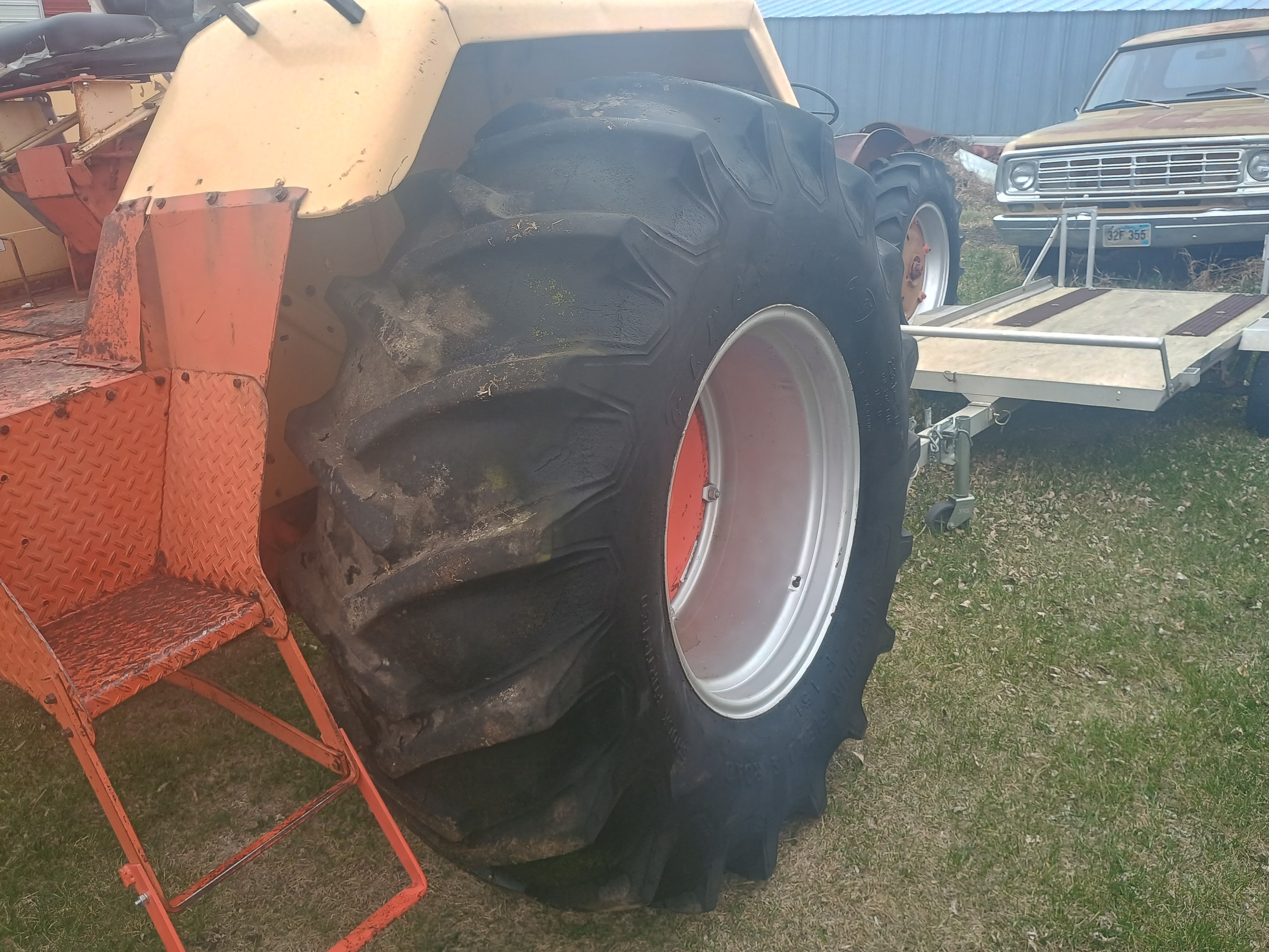

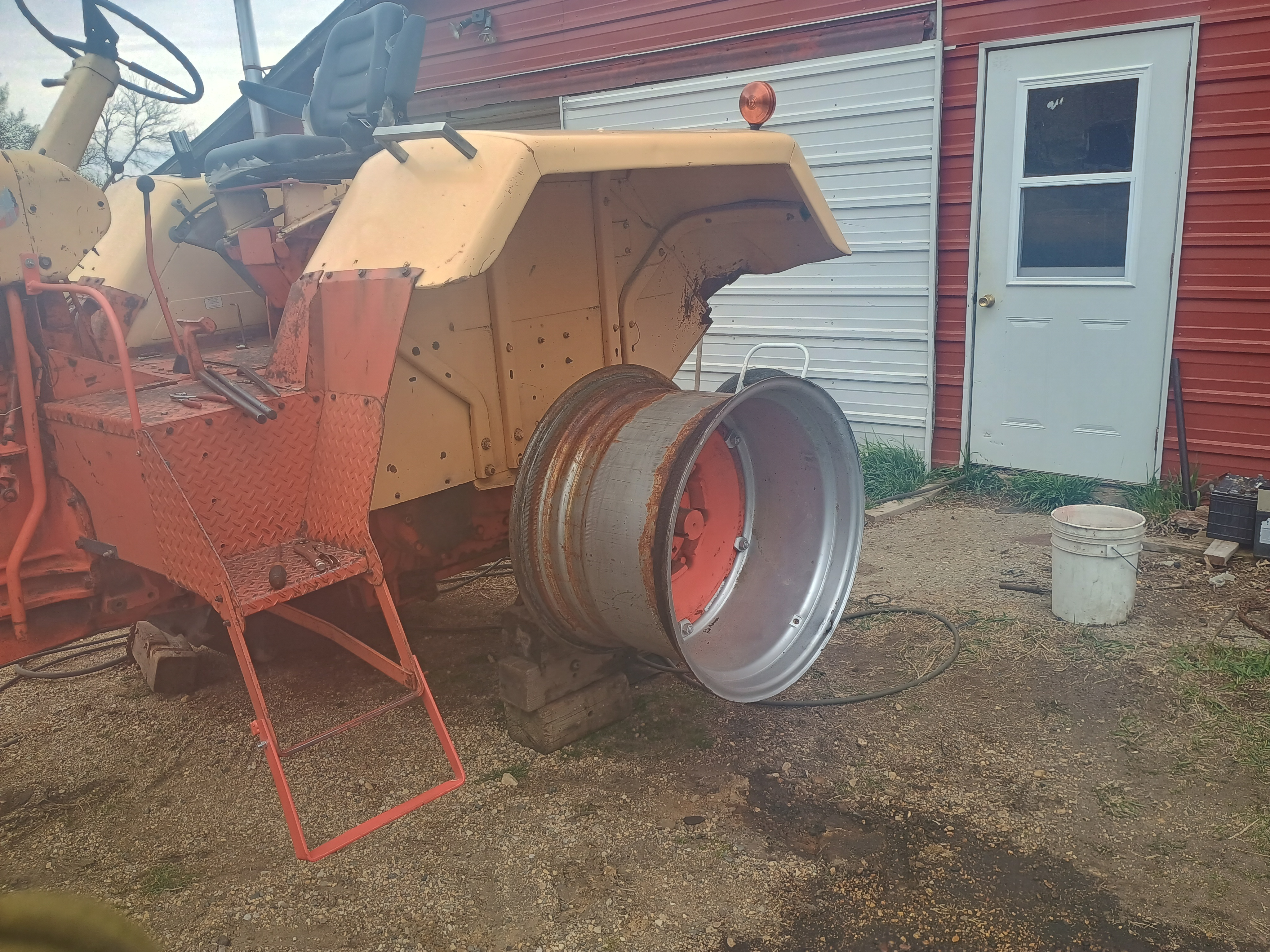

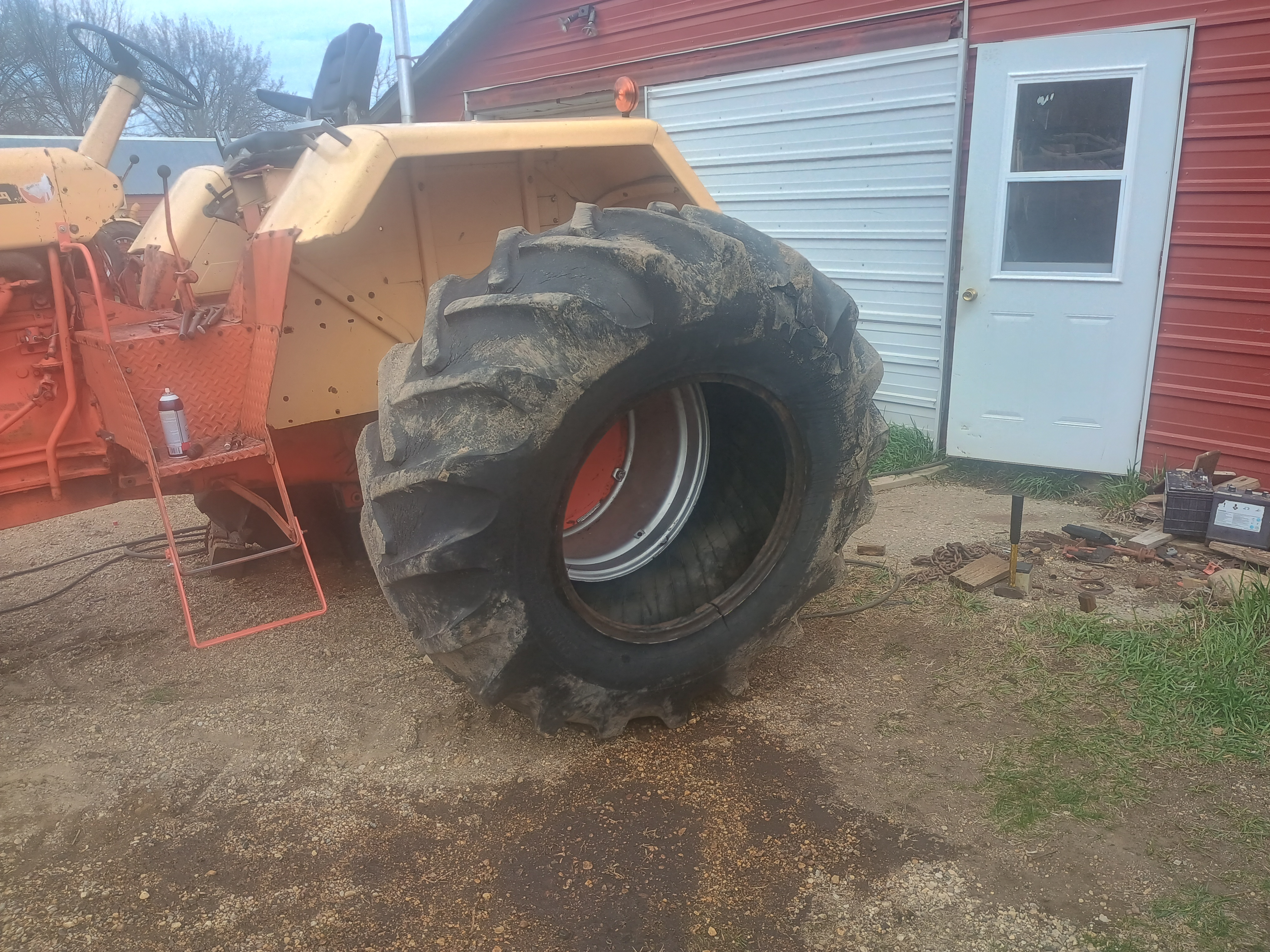

Have had trouble with the entire assembly, but replacing the core stops the leak a lot of the time. Yesterday had to change a 23.1x30 tire. One on the tractor had large cracks so put a used one on.
