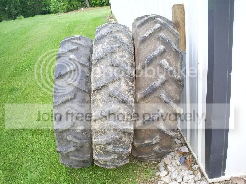

Heres a 11.2-28, 12.4-28, and a 13.6-28 side by side by side
WOW! looks like the new sizing would convert to something like 420/85R28. Nothing confusing about all this! Sad part is the tires will cost more than the tractor is probably worth.

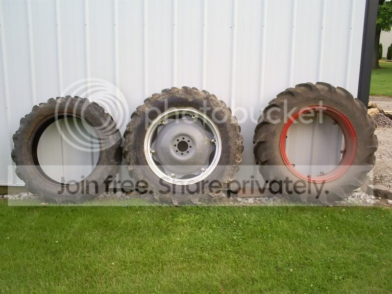

Thanks for all the info.. I have to ask, I hte pictures posted above, will all three of those tires fit on the same size rim? Looks like the same diameter hole.
I am a little confused. The numbers you read off your tire were 13-28 and 11.25-28. The first number indicates the width of the tire according the standards in place at the time of manufacture. Going by the chart on the Miller Tire website: 11.25 is the width of generation I tires, 13 is the width of a generation II tire, and 14.9 is the width of the generation III tires. All of these tire are the 'same' size, they were just made under different standards. I'm not sure where you pulled 420/85R28 from...

If you had 13-28's originally, then I believe that will change to a 13.6x28 in the newer numbering system.
The simple solution to this is to measure the rims you have, inside bead to inside bead. You've probably got 12" rims. You can put a 12.4x28 or a 13.6x28 on that wheel. A 14.9x28 is getting wide, and a 420/85R28 would probably not fit up properly.
