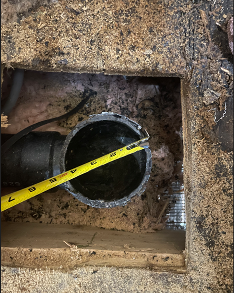

Had to pull up this toilet and replace the plywood floor because it keeps leaking,
Slots for hold down screws were also cracked in the flange.
That is a 3 by 4 toilet 90 in the floor and it had flange that glued to the outside of the 90.
I was able to remove most of the glued on part of the flange but not all of it.
Either way I do not see removing more of the flange will do any good as I can not see me getting a water tight fit.
So my question is do they make a flange that would fit on the inside of this 90 as the inside still looks to be in good shape.
