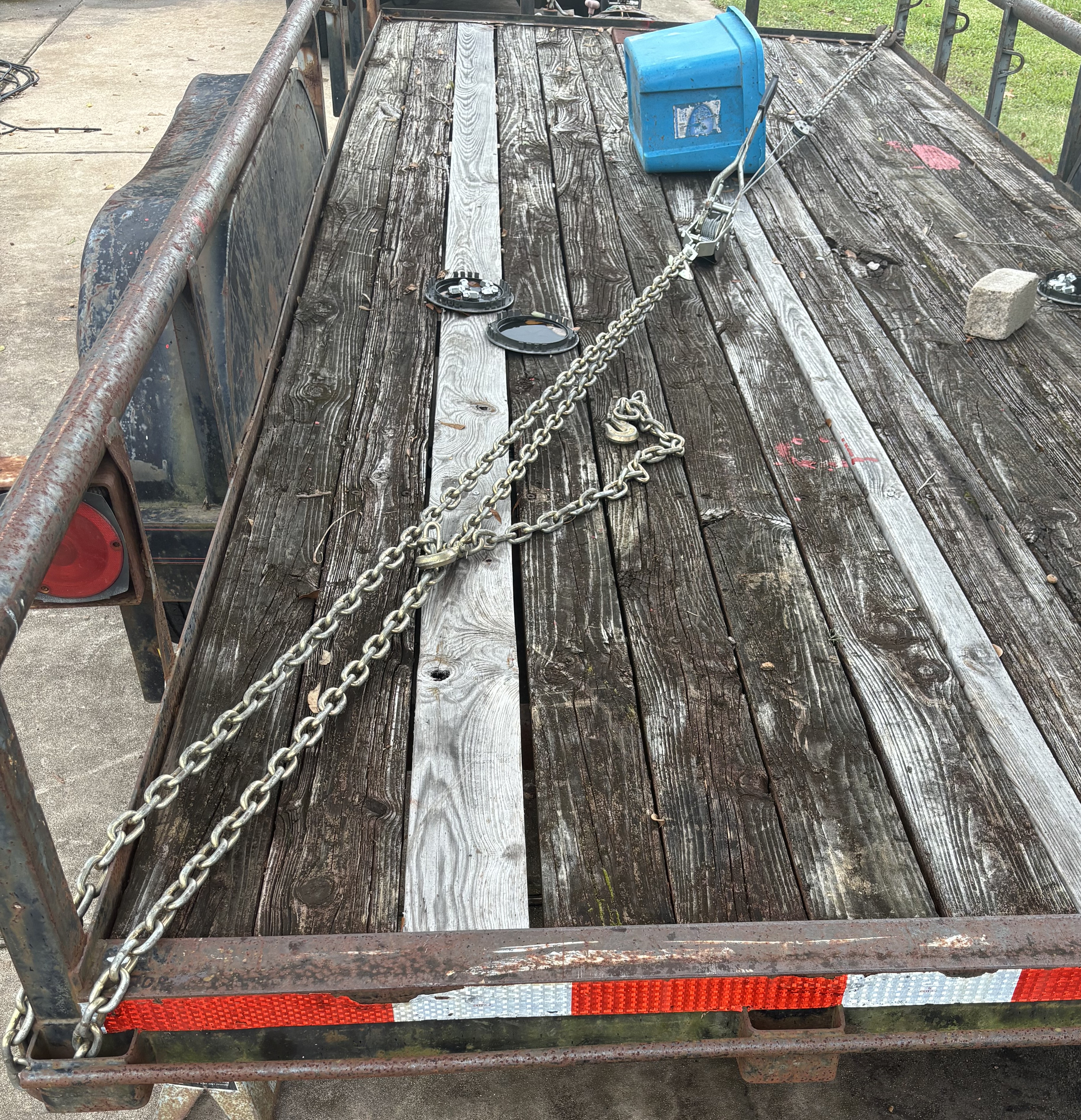

I hooked up a come-along across one diagonal and pulled it tight and went around banging on the corners to see if I could get some relief. After releasing the tension, I measured about 1" difference. I don't have a torch hotter than MAPP gas, so getting the joints hot enough to relax will be a problem.

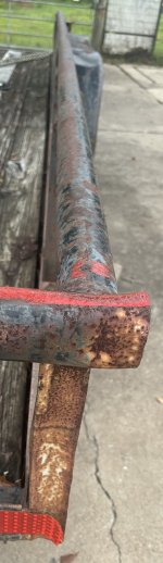

There is also a slight bow on both sides. This can be seen in deck angle on the left side around the front of the fender. Running a string from front to back down that, it bows out ~1". The opposite side bows in the same direction. Thinking about it as I type, I probably need to correct this 1st. Not sure how best to do that....
Any recommendations on what tools or methods to use to get this back in shape? My last resort will be to cut welds and then reweld after squaring, which is fine but I'm hoping there's another option. I do have 1.5 ton chain winch that could be used instead of the come-along, which I'd rather not stress any more than I am now.

There is also a dent in the top railing on the side opposite the bowing that I could see resulting in the bowing. The dent is the center of the bow of that rail. Zooming in to this picture shows the dent. Maybe its more likely that the corner impact would have caused the bow. Don't know.
