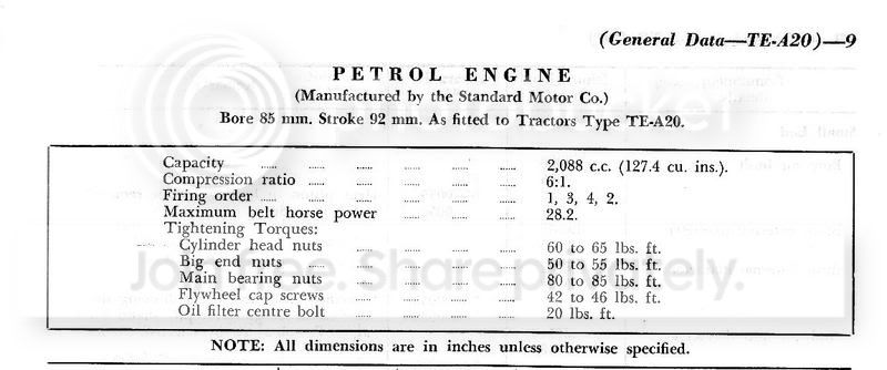

I am currently restoring a TED20 and am in need of the torque settings for the engine and flywheel also if anybody can tell me the head tightening sequence it would be great help.

[b:d6ec8e90c7]Gregory's Manual[/b:d6ec8e90c7] - Does not give different torque settings for the TEA and TED engines (at least I couldn't find them!):

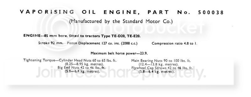

[b:d6ec8e90c7]Manufacturer's service manual[/b:d6ec8e90c7]:
Interesting differences - first time I've noticed that! I'd use the manufacturer's figures, as McKay suggests.

Cylinder Head 60 - 65
Main Bearings 90 - 100
Big Ends 42 - 46
Flywheel 42 - 46
