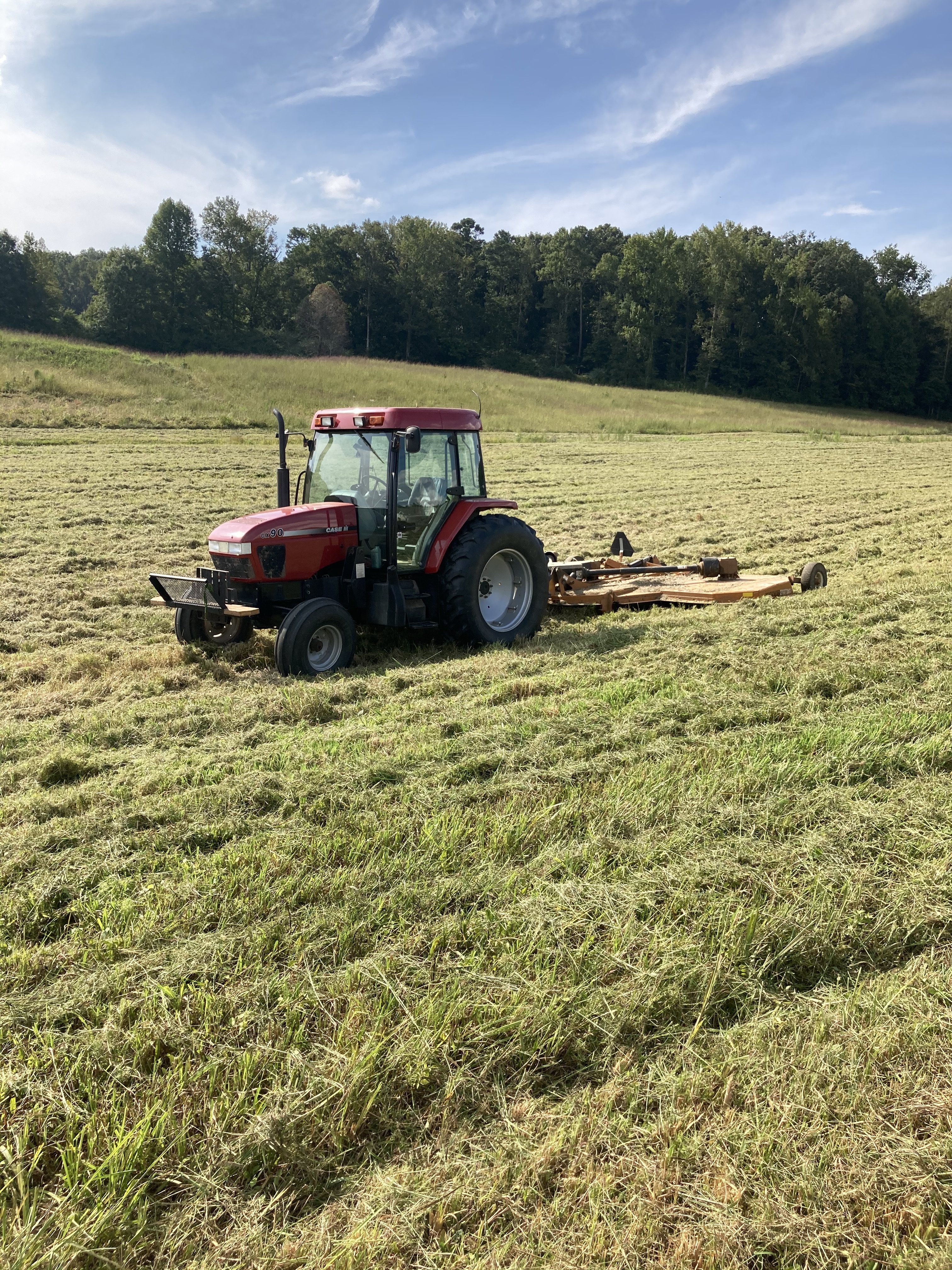

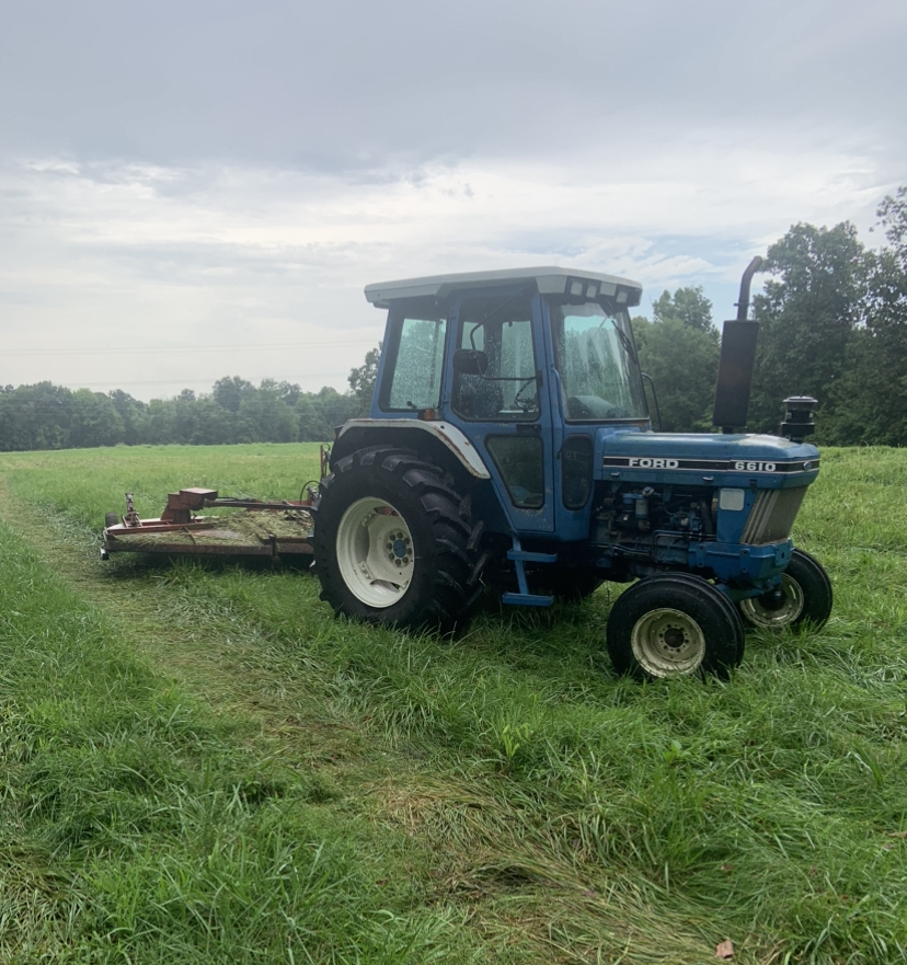

Get serious. 90 hp and 15 ft batwing!! Get in- get done!!!
