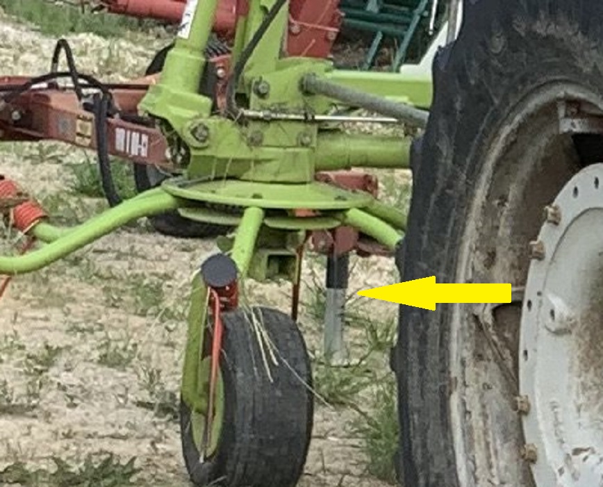

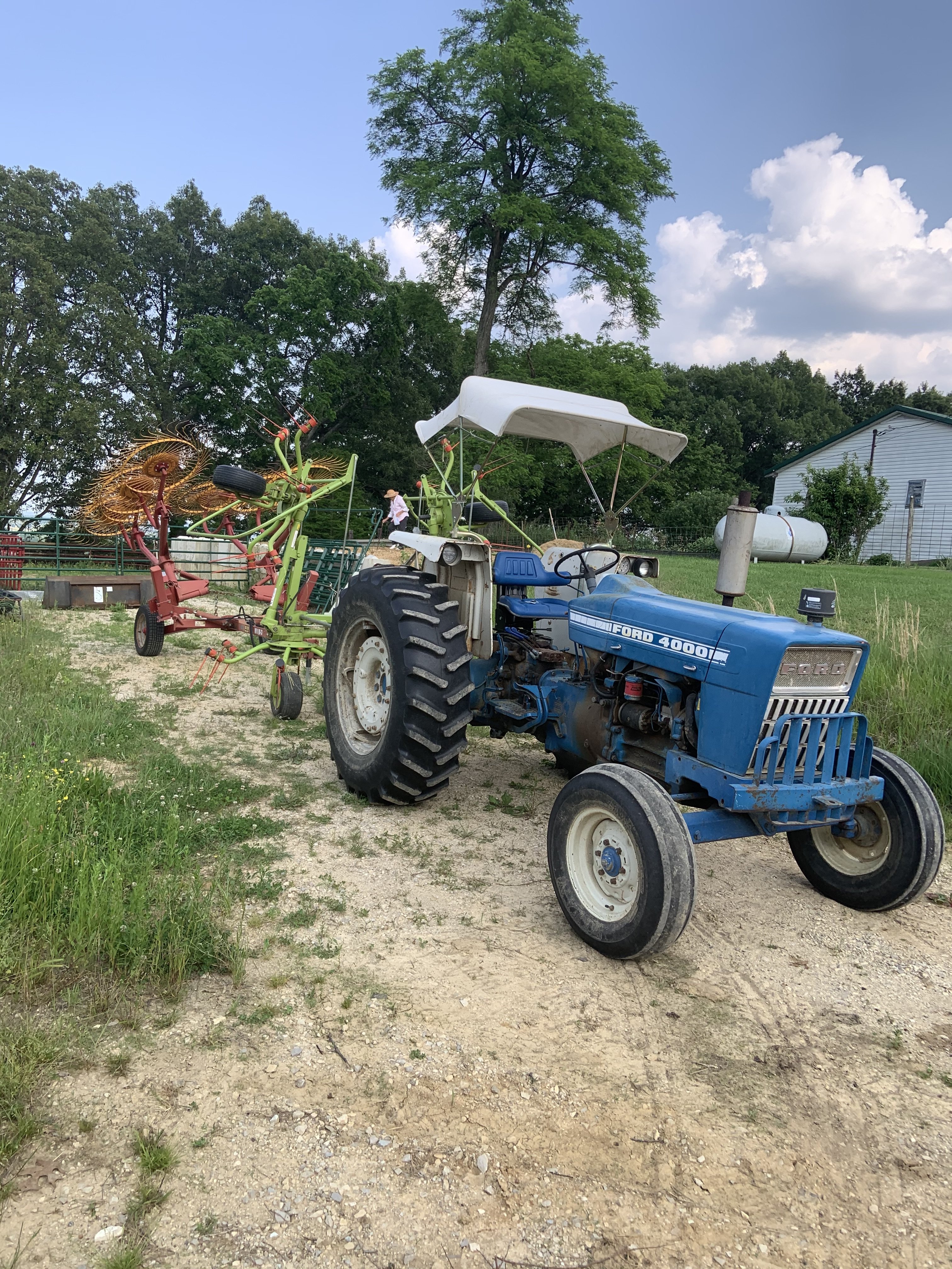

Huh? What? Photoshop? Is that hay rake connected to the tedder to be pulled behind in tandem? Or have I been into the alcohol too much this weekend? Inquiring minds need to know....
Will this help? I can see the tongue jack is down on the rake, so I doubt it is hooked up.
The tedder was a new purchase and I had parked it in front of the rake
Photo was from 2022 when every piece of haying equipment I owned broke
