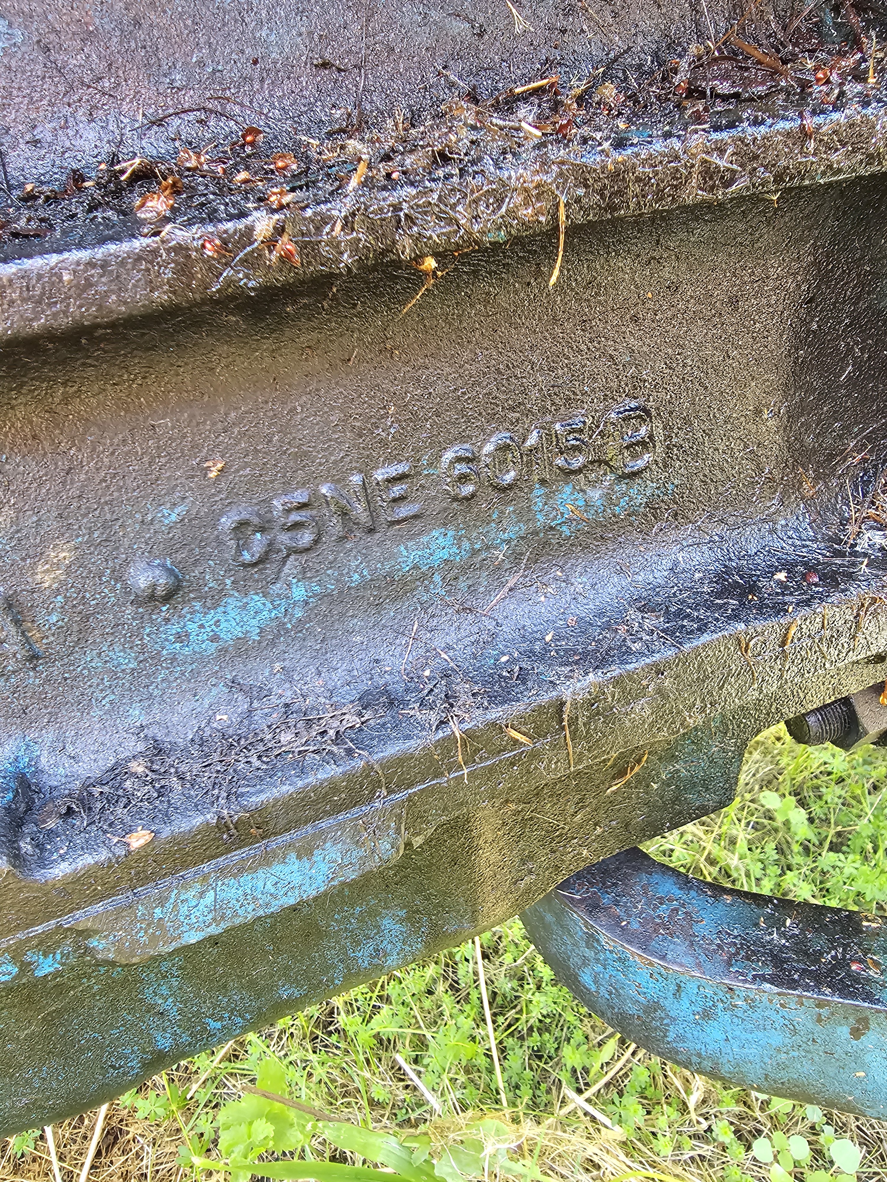

Looking at purchasing a tractor not sure what it is. These are the numbers I got
Shawn, I can see part of a yellow wheel in your photo - John Deere, Massey? It would help a lot if you mentioned what brand you are looking at instead of us guessing that. Or a couple of pictures of the whole tractor. Or is this just a challenge to see how good a knowledge base we have here? steve
NAME THAT TRACTOR You now have 3 photos, and a hint that it is a Ford. Can you name that tractor in one more photo? One more casting number? How about one photo of the Serial Number plate? A closeup of the dash? This might be more fun than the big tomato contest!!! steve
Don’t need any more info, it a 5000 Ford built May 1965
Axle pined to the oil pan and photo of the right floor board along with early build date was enough info

Hi, Destroked. My question is could you have guessed that with only the first photo of the stamped numbers? Some people do know their tractors that well.

Now my answer to your question is without a actual standardized model code I could not say what model the tractor is
Looking at the 1st and 3rd rows as date codes I can say the tractor was built May 1965 on one of two possible dates
I have only seen that odd looking 0 on European models and the Basildon export tractors were the only ones that started the serial numbers with 0
Domestic use serial numbers started with 8
