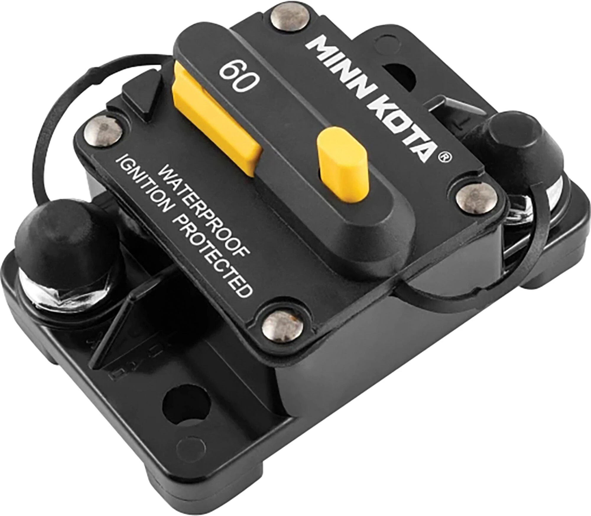

I am finally getting around to mounting the wench on my flat bed. THe question is should I have a switch between the power(12V) and the battery? 12V is the charging circuit for the battery. 7 wire standard hookup. We never had sons but 8 grandsons are catching up with me. Grandpa can I use the trailer ,sure. It came back with a broken tail light lens,(ok) two weeks later can I use the trailer gain? Sure,this time it came back with the wires hanging from the marker lights and a single out. I have a new set of lights setting on the table right now. The last set made it a year,maybe two. I have never wired for battery charging before,just lights and brakes.
I would install an on/off switch of the size to carry the maximum current of the winch motor current draw, and fused.
