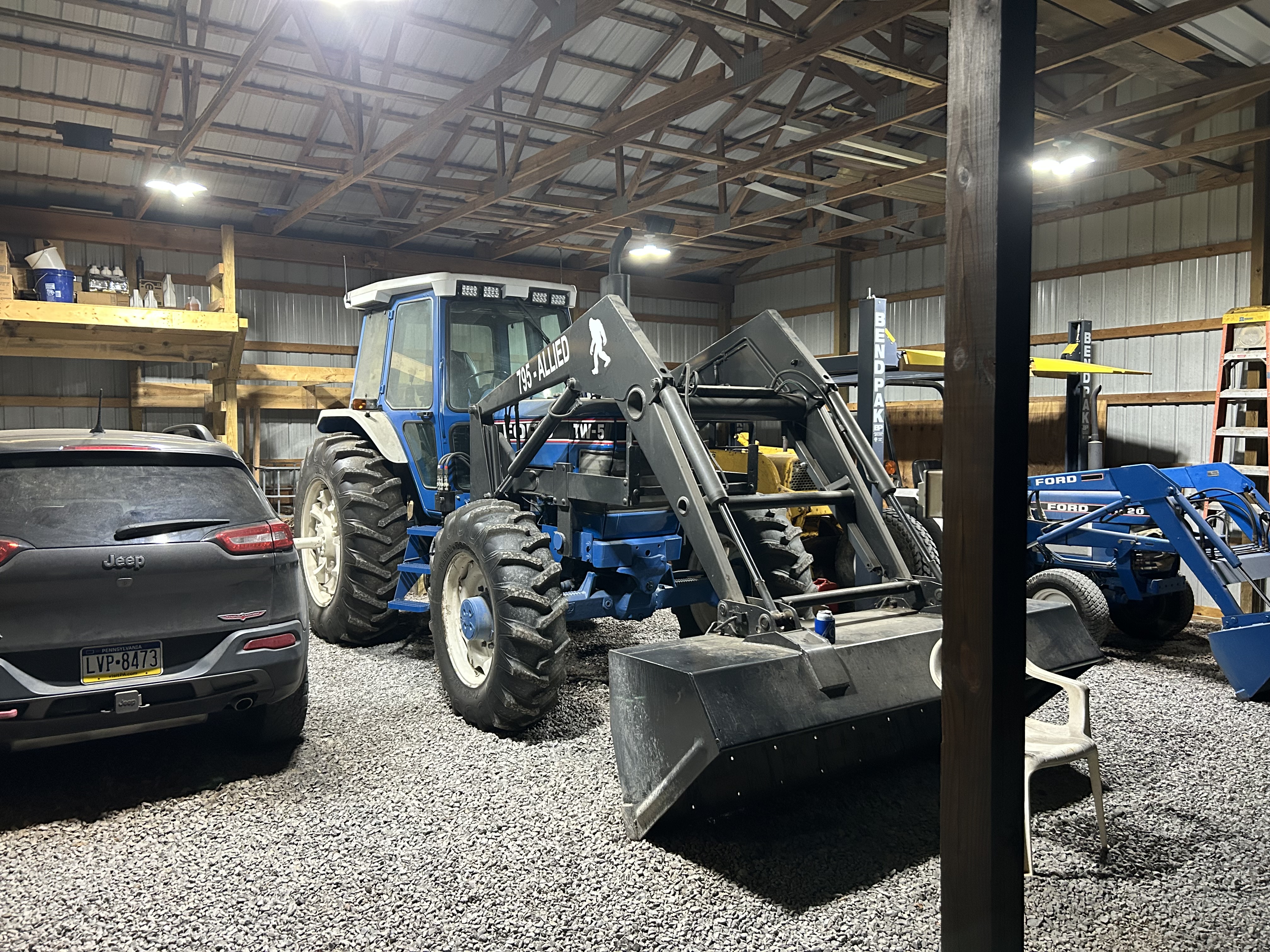

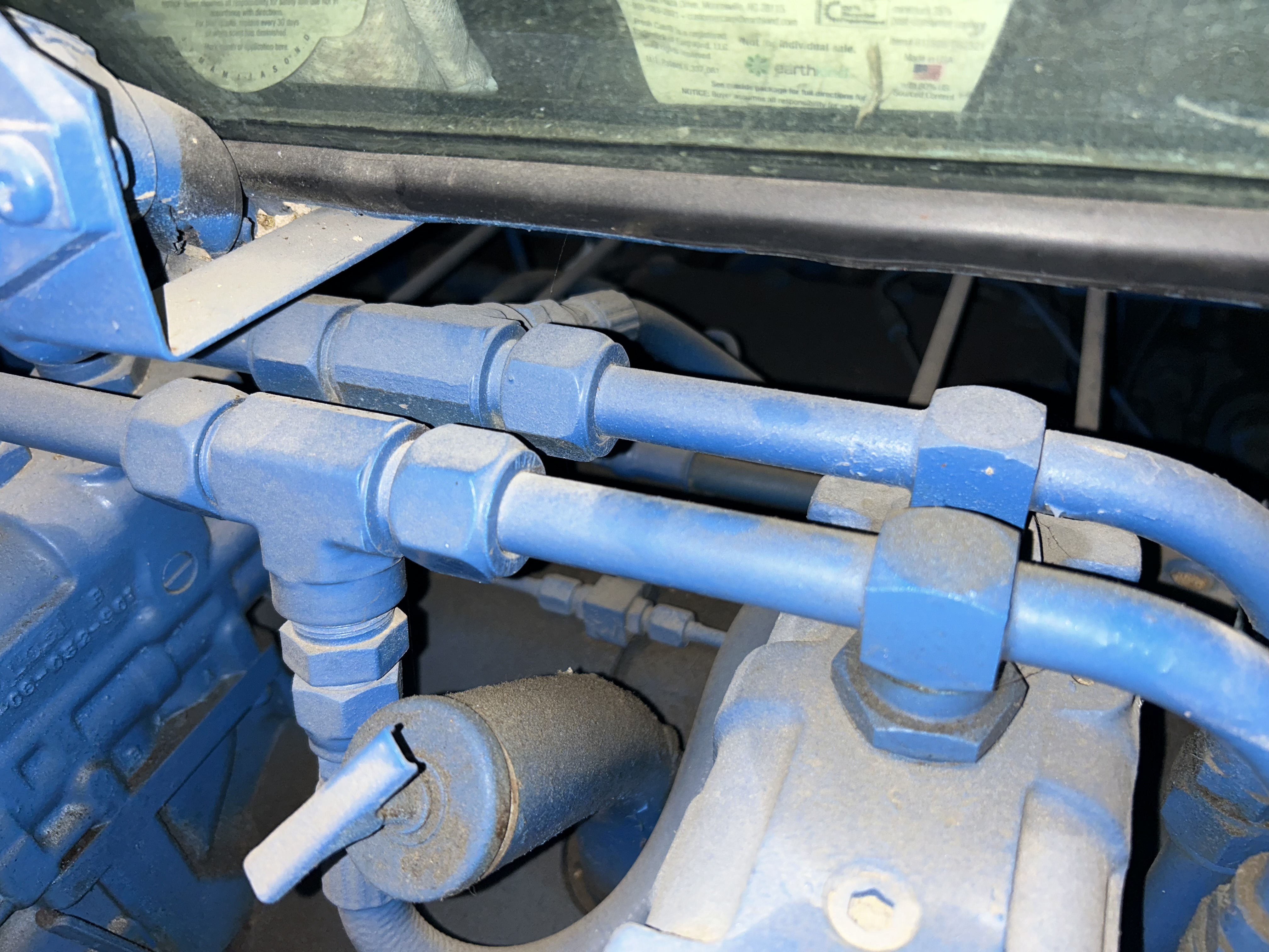

Howdy all. I’ve read a lot about leaking remotes but have a question. My tractor has 4 remotes on a series 2 TW-5, I never use or have used them, this tractor is used for road maintenance so they never get engaged. Levers on the couplers are in the vertical position but they still leak out of the drain hose. Would this require a control valve or a coupler assembly rebuild. They is a loader plumbed into the pressure, return and pilot tube. I’m guessing even they the remote levers never get moved the loader is putting pressure on the remote assembly when to loader pilot tube pressures up. Any info on rebuild kits would be appreciated. Thanks
