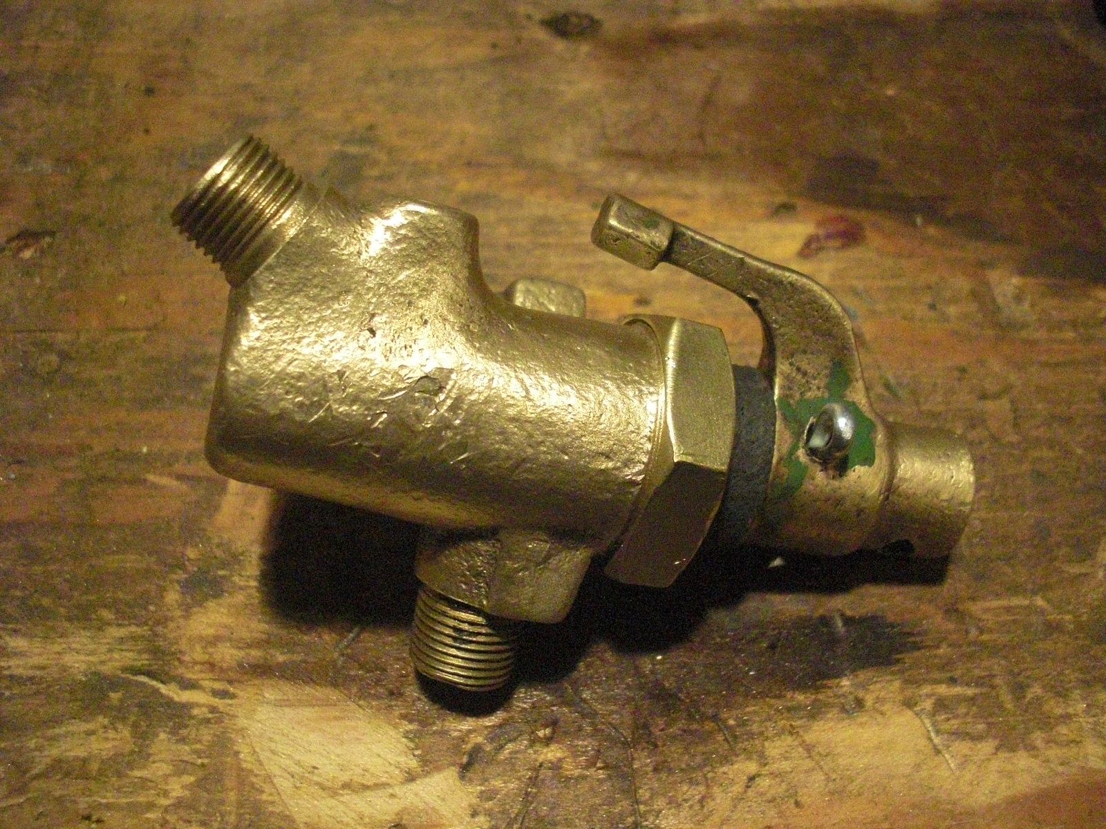

Here's another update. I disassembled, cleaned, overhauled, and reassembled the three way-valve. I was going to dissemble, clean , oil and resemble the tappets today but the three-way valve took to long. I'll deal with the tappets tomorrow. You'll see in the pics that I left the small patch of original paint on the three way valve. I decided to leave it their because that will be the only part that won't be repainted, so it'll have an original touch. I also put anti-seize compound on the tappet studs.

It looks like you have done some fine work. I know you are a young man learning as you go, here is a tip. It is maybe not a huge deal but I would limit the amount of anti-seize you place on internal parts of an engine that could eventually find its way into the lubricating oil. A portion of the ingredients of anti-seize is actually finely ground metals like aluminum and copper. Probably not something you want circulating through the engine bearings.

That cork seal goes under the nut on
the 3-way valve. Should also be a thin brass washer between the nut and cork seal.
