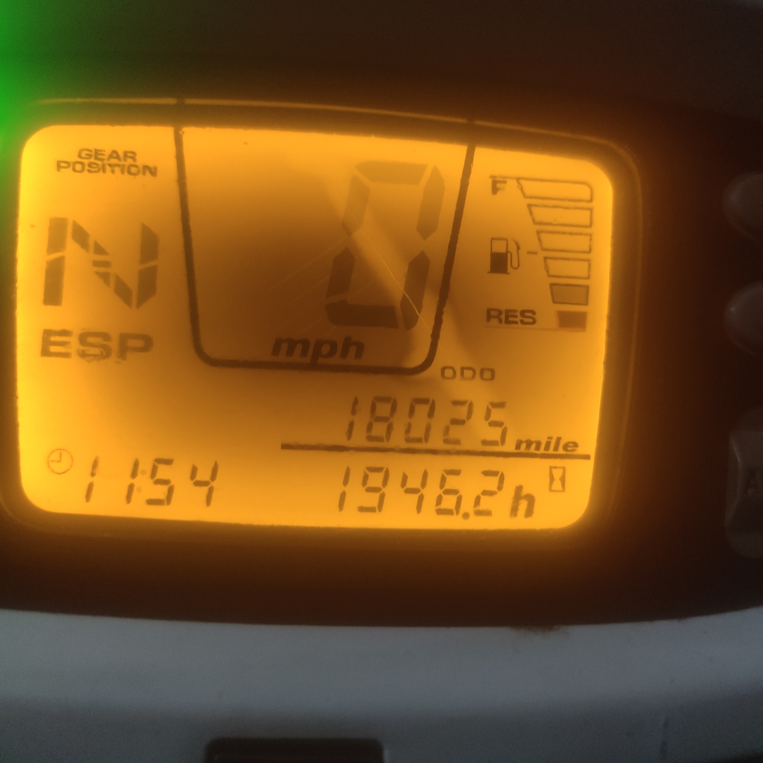

Daughter has a 2008 Honda Rubicon 500 that has over 18,000 miles and nearly 2000 hours on it. It's never had the plug out of it nor the valves adjusted. Only thing that has been replaced with OEM parts are the front wheel bearings, swing arm bearings (got busted towing a kids170 RZR about 20 miles to get him home) and a starter.
