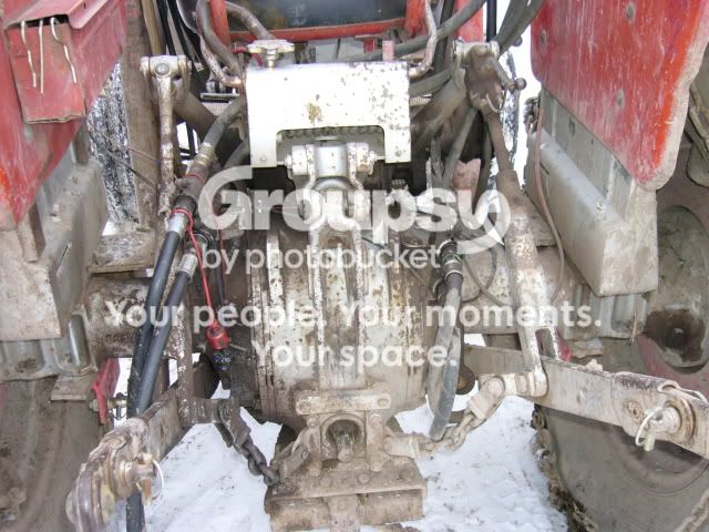

Here's a picture of the back of our MF 165-
The shaft sticking out near the bottom is the 540 PTO shaft. The arms on either side are Category I 3 pt. arms. The 3rd point to hook on for a 3 pt. connection is the U shaped bracket above the PTO shaft. The hoses on either side are the remote hydraulics. On this tractor they are plumbed in to run the loader on the front of the tractor.

i have a question for don-wi.i have that same remote (the one to the left)on my 165 and i always seem to have a hard time getting it to couple just right.makes me say words i cant repeat on here.i am usually about worn out by the time i get something hooked up.i push the ball down first on the male end letting off some pressure but its still a battle. thanks RICK

Thse are remotes that I installed myself after installing the hydraulic pump on the front driven from the crank.
Some remotes can be hard to work with. The remotes on our 285, you have to pull on the hose on the tractor end to pull the coupler out, then push the hose into it. No way you can just push them together, atleast not with lots of trouble and swearing.
