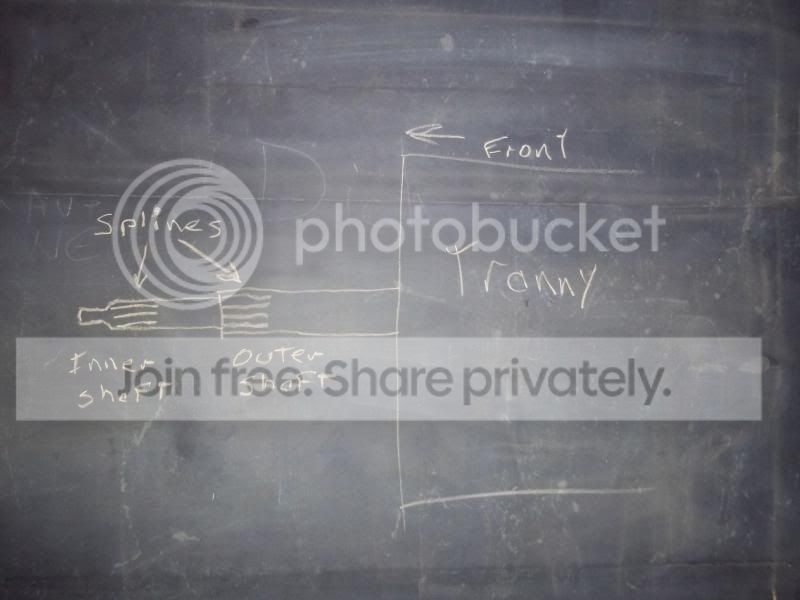

Let me add a little to it.
In addition to the dual clutch discs a live pto tractor has dual input shafts into the tranny.
One is inside the other. The inner shaft only propells the tractor. The outer one only propells the pto.
On an Independent PTO the setup is similar. One input shaft inside of the other. Except the outer shaft is not run through a clutch disc.
It turns constantly whenever the engine is turning. That is why it is Independent of the clutch.

I've rebuilt a couple of 1990 Ford AOD trannies and that looks like the input shaft on them, more or less.
