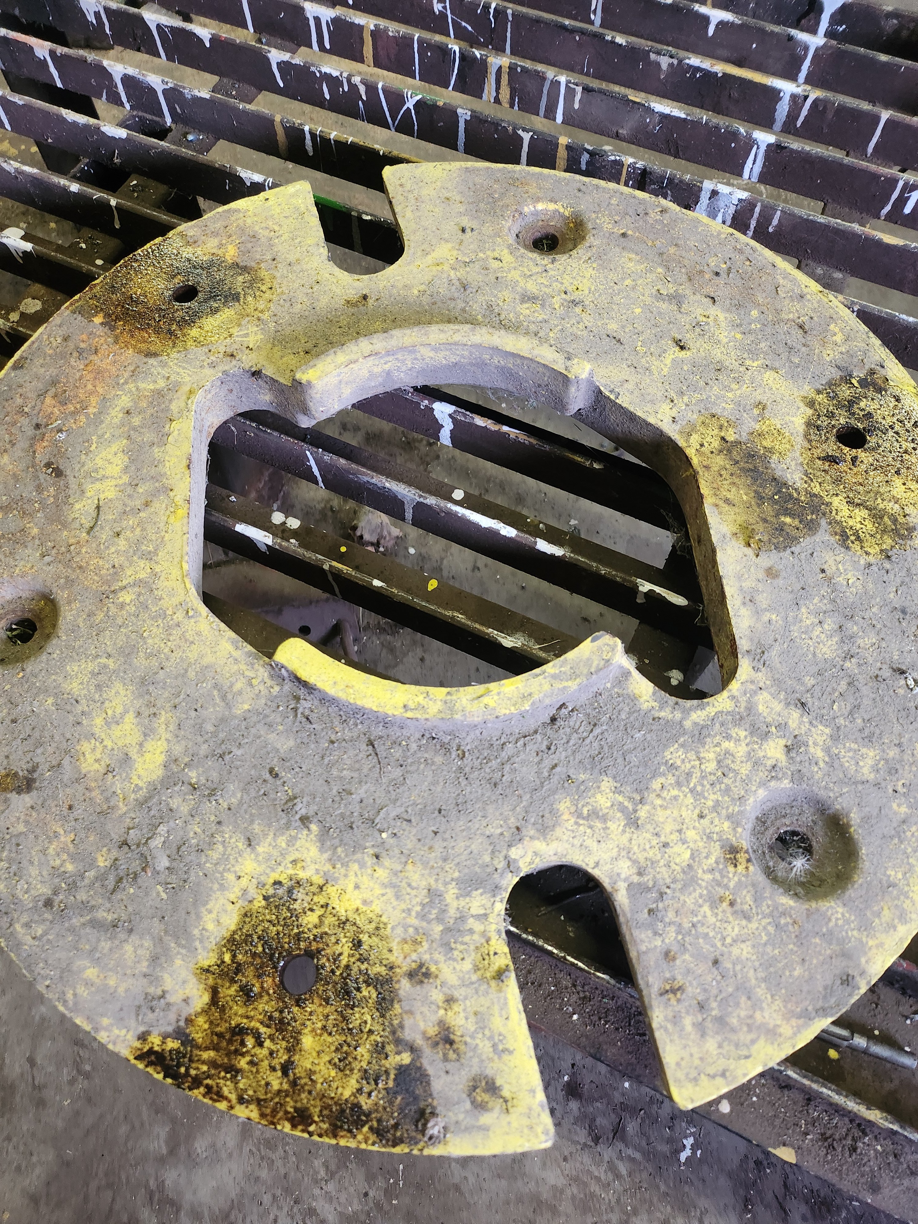

How can I cut the center out of these JD wheel weights? Want to mount them on a Farmall 65.

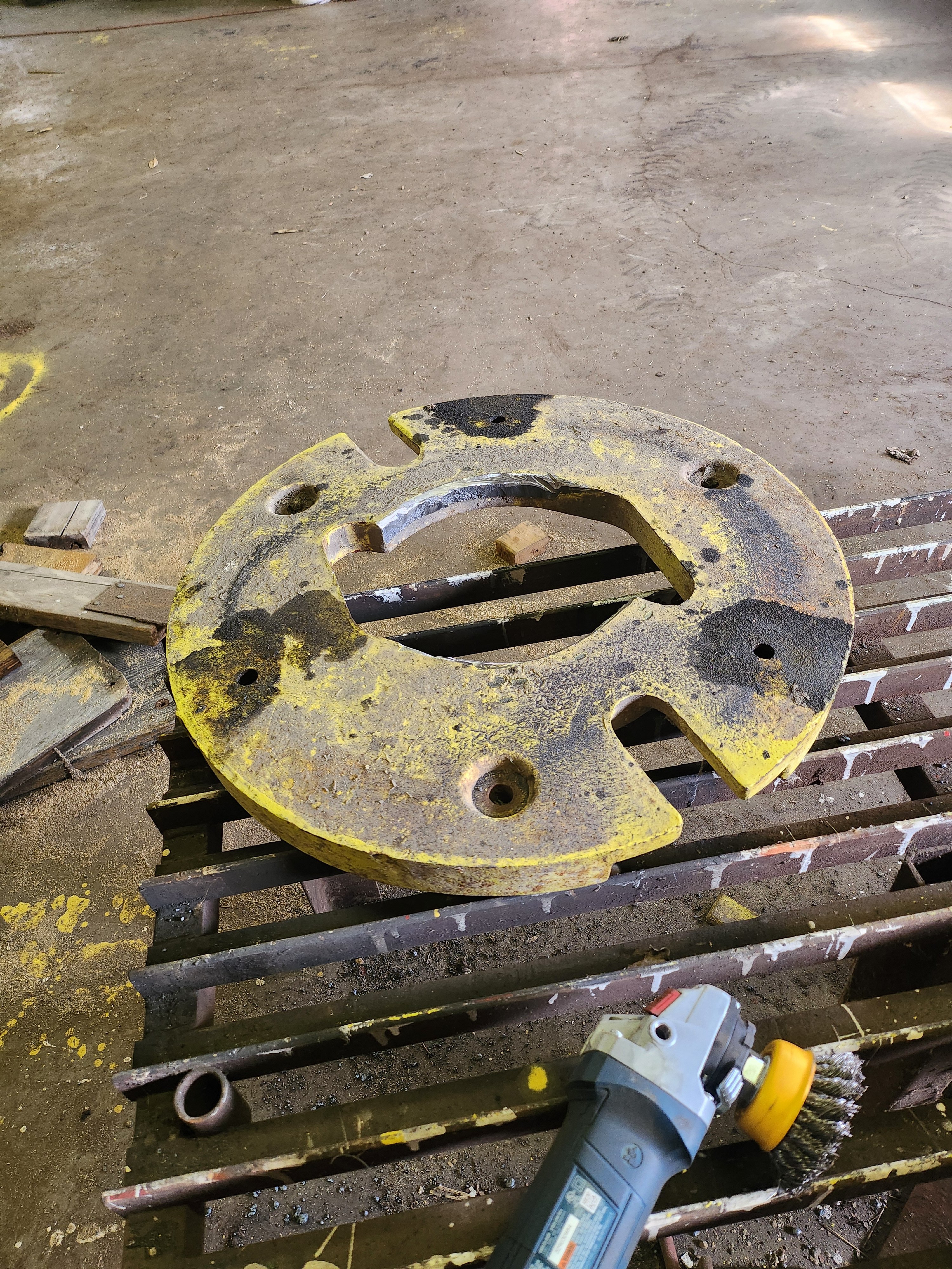

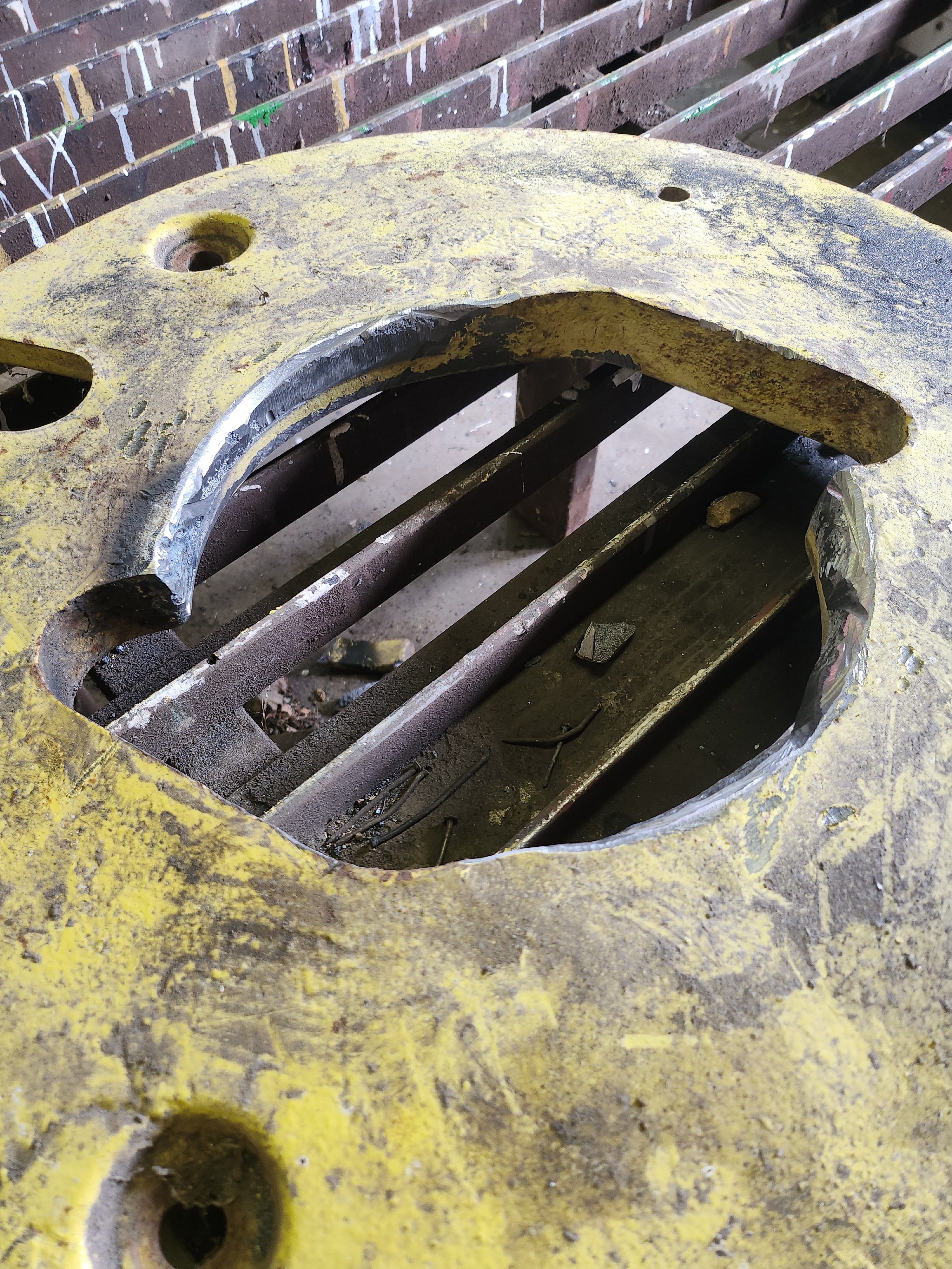

Scored it with the diamond wheel and knocked it off with a sledge hammer.View attachment 65412View attachment 65413

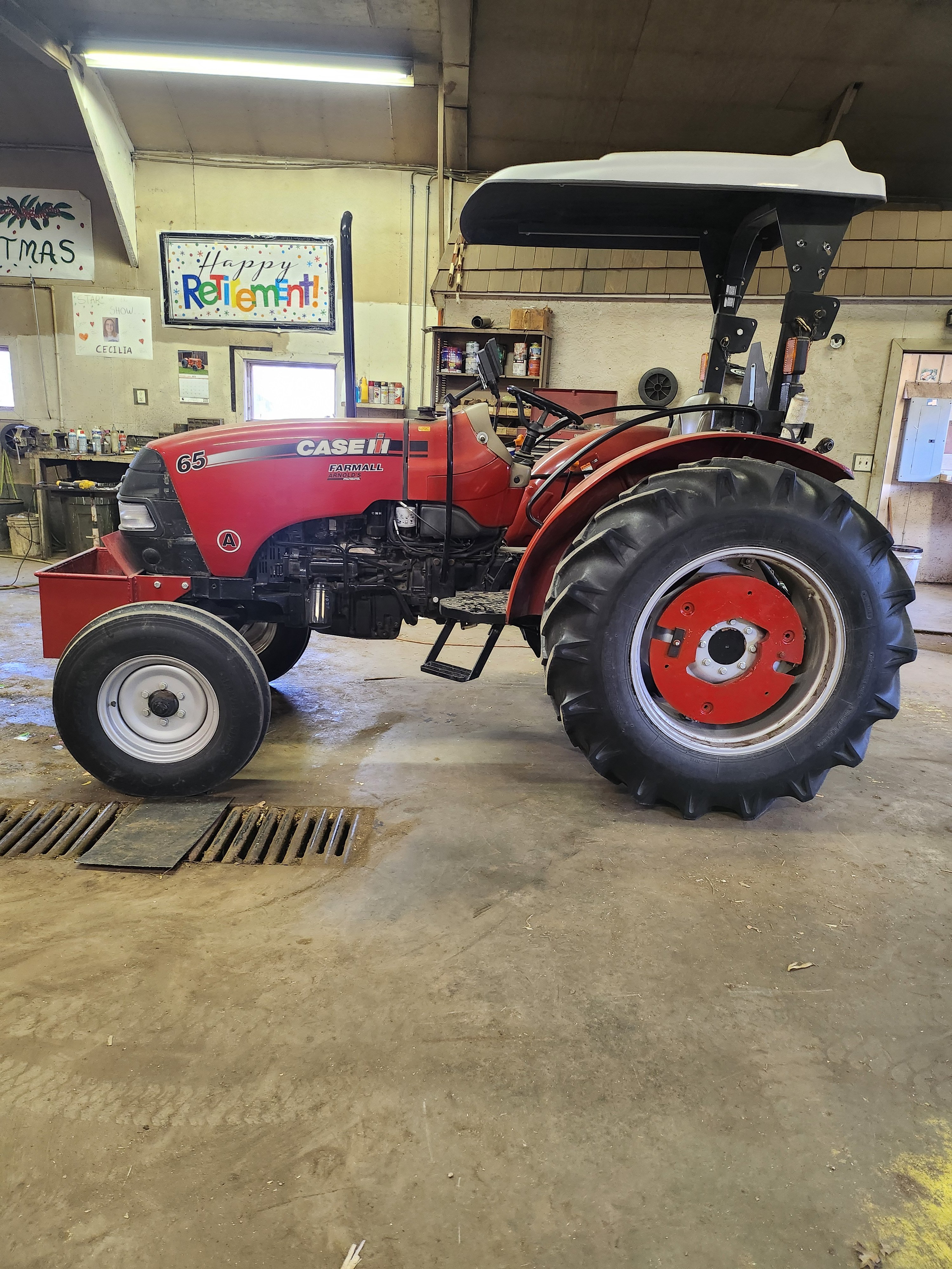

Yea, same as my Blue one. May I ask where you got the monitor bracket, or did you fab it yourself? I was planning on putting my baler monitor on the fender rail, but that looks slick setup….I got them on the tractor. Stil have to touch up some of the paint I scuffed while mounting.View attachment 65657
