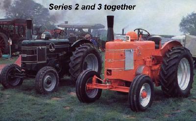

The model M is basically a Lanz Bulldog in all but name, the livery is as standard fern green with red cast wheels or steels, the front is very square and the exhaust best described as a squat pressure cooker shape. the Series one, is easily discerned by the snub nose of the front and lack of the bulbous air cleaner on the bonnet. It also has the later taller coffee percolator exhaust. Early Series 1's shared M wheel centers, whilst the later ones had pressed steel centers and flat half shaft ends. The Series 2 whilst being the same fern green was turned out with pressed steel wheels which were silver in color. The addition of the bulbous air cleaner to the top of the bonnet is another differentiating feature. The Series 3 was altogether a taller machine and even if in fern green paint it cannot be mistaken for the 1& 2. This machine was turned out in bright orange and silver livery and this machine had a more pronounced hopping effect when on tick over.
