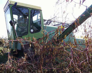

I walked towards the combine through the heavily weeded lot. It was choked with six foot burr plants and thistle. With the digital camera in tow, I trail blazed a path back to the combine. To my surprise it was a John Deere 4400 model. It appeared to be in fairly good condition, but rusty, from my initial view. All 4 tires had air and appeared to have good tread. A strange feeling dawned on me. Here stood a machine that had probably seen many hours in the field collecting and separating grain. There are still many 4400s running to this day. Could I possibly bring this machine back to life and return it to the field where it belongs? After this passing thought, I pulled down the steps and climbed aboard. The cab was in fairly good shape. The tachometer indicated a little over 1,500 hours. A switch on the console was in the gas position. This combine had an option to run gas or liquefied petroleum. The cab contained two toolboxes still full of rusty tools on the floor. A rusty hammer was on the outside deck next to the door. After examining the cab, I opened the small door that lead to the deck in front of the engine. The engine cover was folded in the open position. To my surprise, the engine was a 6 cylinder gas model. It appeared in good physical condition with nothing broken nor missing. A 12 volt battery was still connected on the engine platform. I closed the cover and climbed up on top to look into the grain tank. The tank had rust spots but was empty. The loading tank augur was rusted on the top end from exposure to the weather. I snapped some digital pictures, closed the cab doors and proceeded home. After arriving home, I telephoned Earl Cantrell, the owner. He informed me he thought it was a 1968 model (turned out to be a 1971) and that he last harvested with the combine in 1993. He said the tachometer was functioning and that the 1,500 hours was a correct reading. He ran the combine only with gasoline. I asked if he had an interest in parting with it and his answer was yes. I mentioned if I could get it running, that I would take it off his hands but for only a token amount of money. I told him that I thought it would take up to $3,000 to get it field ready. To my surprise he agreed with my assessment. He told me to stop by anytime to look over the combine and help myself to cutting down the weeds around it. After having a late lunch, I was back over at the combine lot around 2:15 P.M. with bush clippers and branch cutters in hand. I spent 2 ½ hours cutting the brush around the combine. It was a hot afternoon with a record high 75 degrees, and I was sweaty. As I cleared the brush around the chopper at the back, I discovered the rear tires had sunk in the dirt approximately 6 inches. One rear tire appeared to be almost brand new. The belts appeared in very good condition with no visible cracks. The combine appeared to have had regular maintenance. There was a broken 8 inch spring laying under the combine. As 5:00 P.M. approached, I snapped more digital pictures and returned home for Halloween duties. I called Earl Cantrell Monday morning with questions on the type and quantity of oil, was old gas still in the tank and other problems he could think of. He mentioned it had a slight engine oil leak and the choke rod had a bad connection when he last operated it in 1993. He had never started the engine since that time. I told him my game plan of changing the oil, installing new spark plugs, check the distributor cap rotor and points, and filling the tank with fresh gasoline and installing a new battery. If I could not get the combine to start and run to my satisfaction, he would at least have fresh fluids, spark plugs and a new battery. He told me to help myself and to advertise his remaining implements on the YTMAG site. He had 2 John Deere plows and two cultivators for sale buried amongst the weeds. During the first week of November, I had several conversations with YT members on the Tales board and the Deere board at harvesting.com. I decided that my best strategy would be to make Mr. Cantrell and offer on Thursday while it was still not running. I was willing to take a huge gamble on getting the combine running. If I got it running, Mr. Cantrell might not decide to sell it or ask a substantial price for it. While talking to Mr. Cantrell on Thursday, I asked the dreaded, how much do you want for the combine? question. His response surprised me. He said since I was bearing the risk of trying to get it running, that he would offer it at $600. I verbally agreed and did not counter bid the price. A check was in the mail Friday. I was at the lot 3 times on Saturday, November 6, to start assessing the mess I had gotten into. The first thing I did was cut a trail to the combine from the adjoining lot. Now I could pull my pickup within 25 feet of the machine. On my second trip out, I tried to turn the engine over with a large wrench on the flywheel pulley. It would not budge. After returning home I had more conversations with fellow Talers and the Deere board members at harvesting.com. Jim McFarlane (320U) from Tales suggested I change the oil and overfill the oil pan with 2 extra quarts and let it sit for the night. He and a friend planned on driving down to Indianapolis on Sunday, November 7 to look at the plows on the lot.

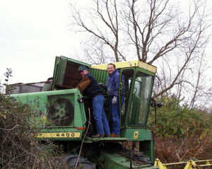

On Sunday, I met Jim and his neighbor Harold Posthuma at a McDonalds on the west side of Indianapolis and we drove to the lot. Mr. Cantrell had loaned me a 3 foot pipe wrench and Jim had brought along a 5 foot pipe to place over the wrench handle. Jim was able to budge the engine. We were relieved. Jim and Harold then pulled the spark plugs and shot WD 40 in the cylinders. Jim turned the engine several revolutions with the pipe wrench. It was turning much looser now. They re-installed the spark plugs and wires. Jim also removed the fuel strainer bowl and screen. They were slimed over with green gas. Old varnished gas slowly dripped out. Jim left the strainer valve open so the fuel tank could drain during the next week. The tank had some gas in it. Jim and Harold looked over the plows and then headed home.
