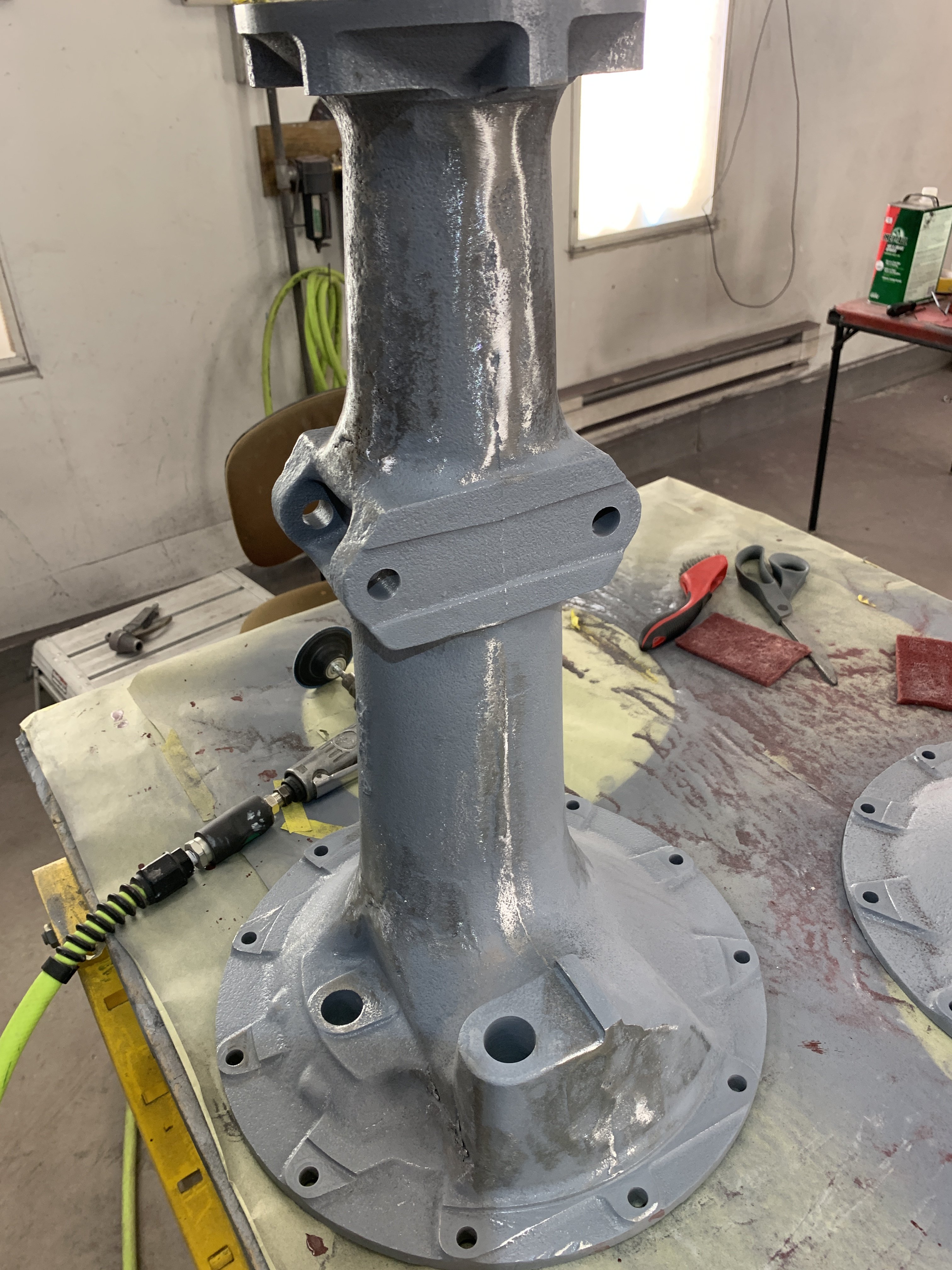

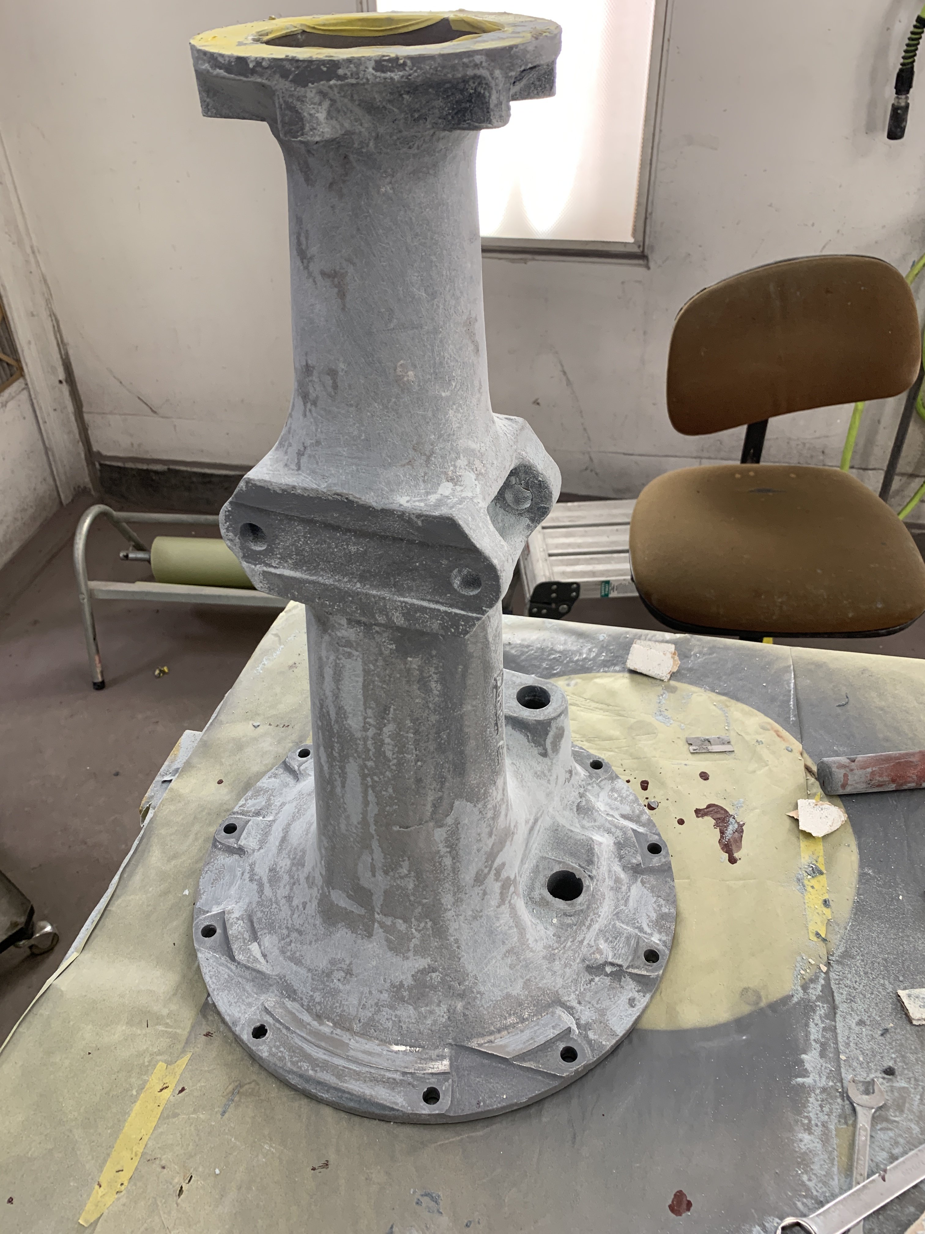

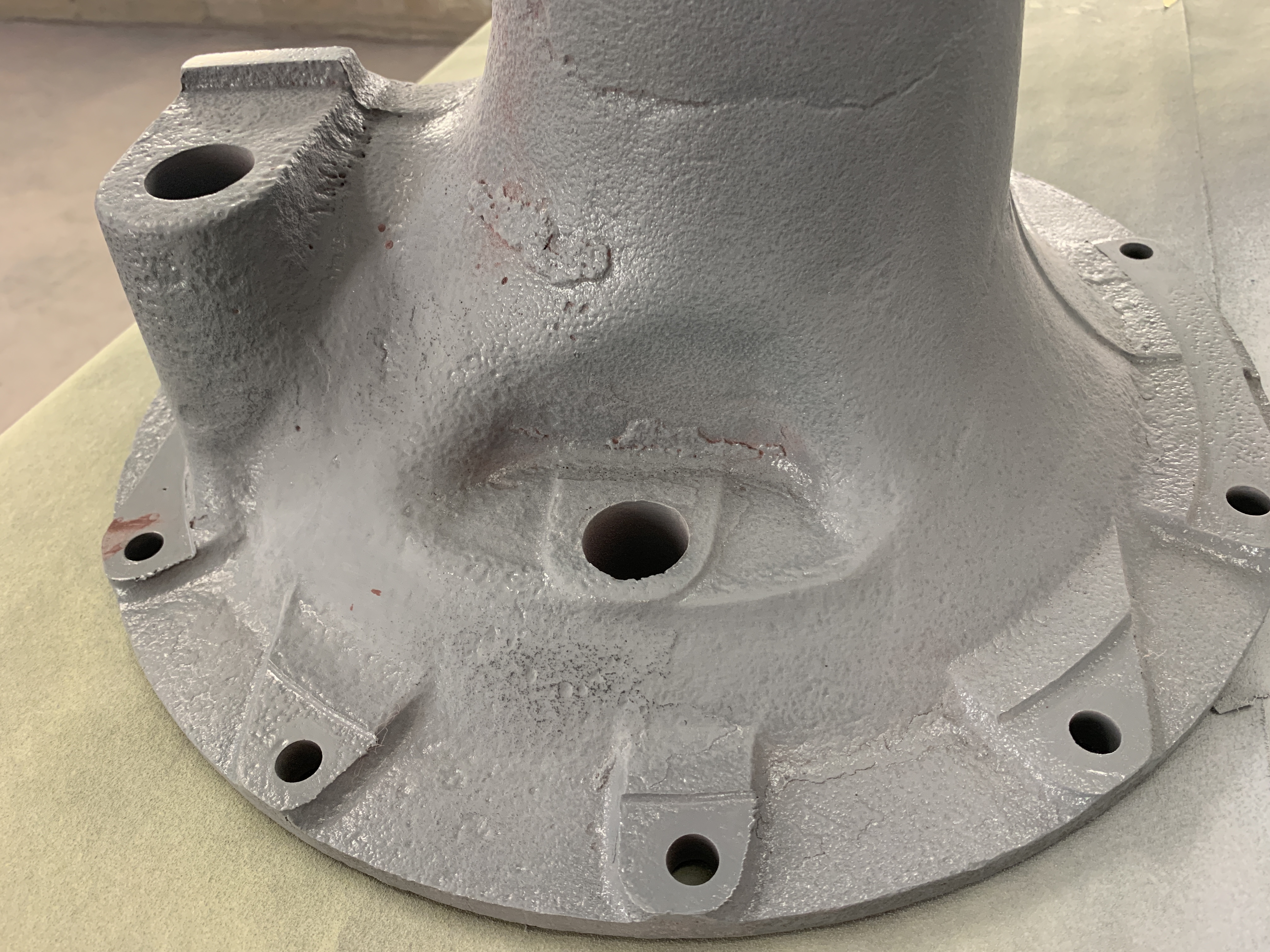

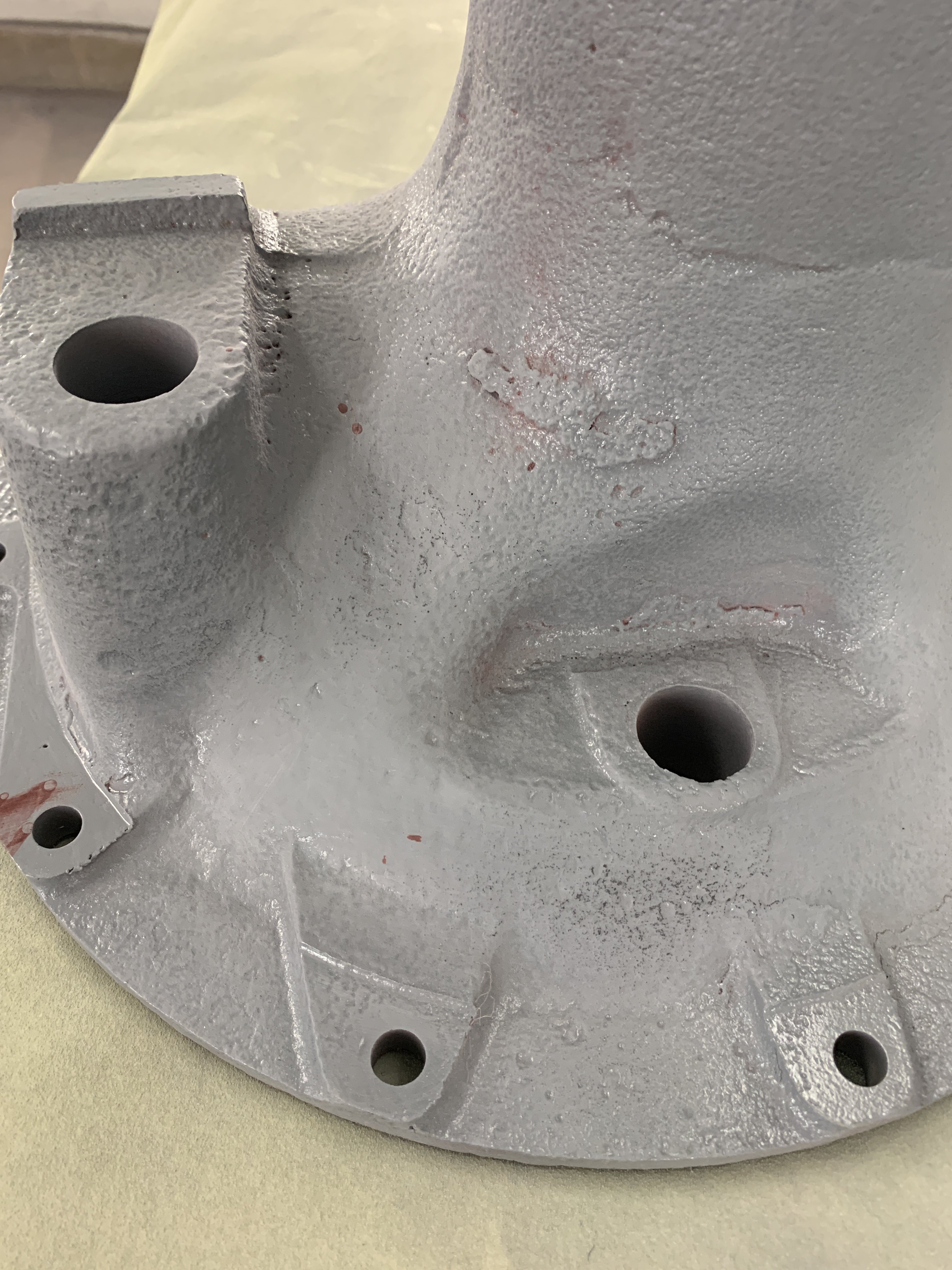

Starting to fill in some of the pits and imperfections in the casting.

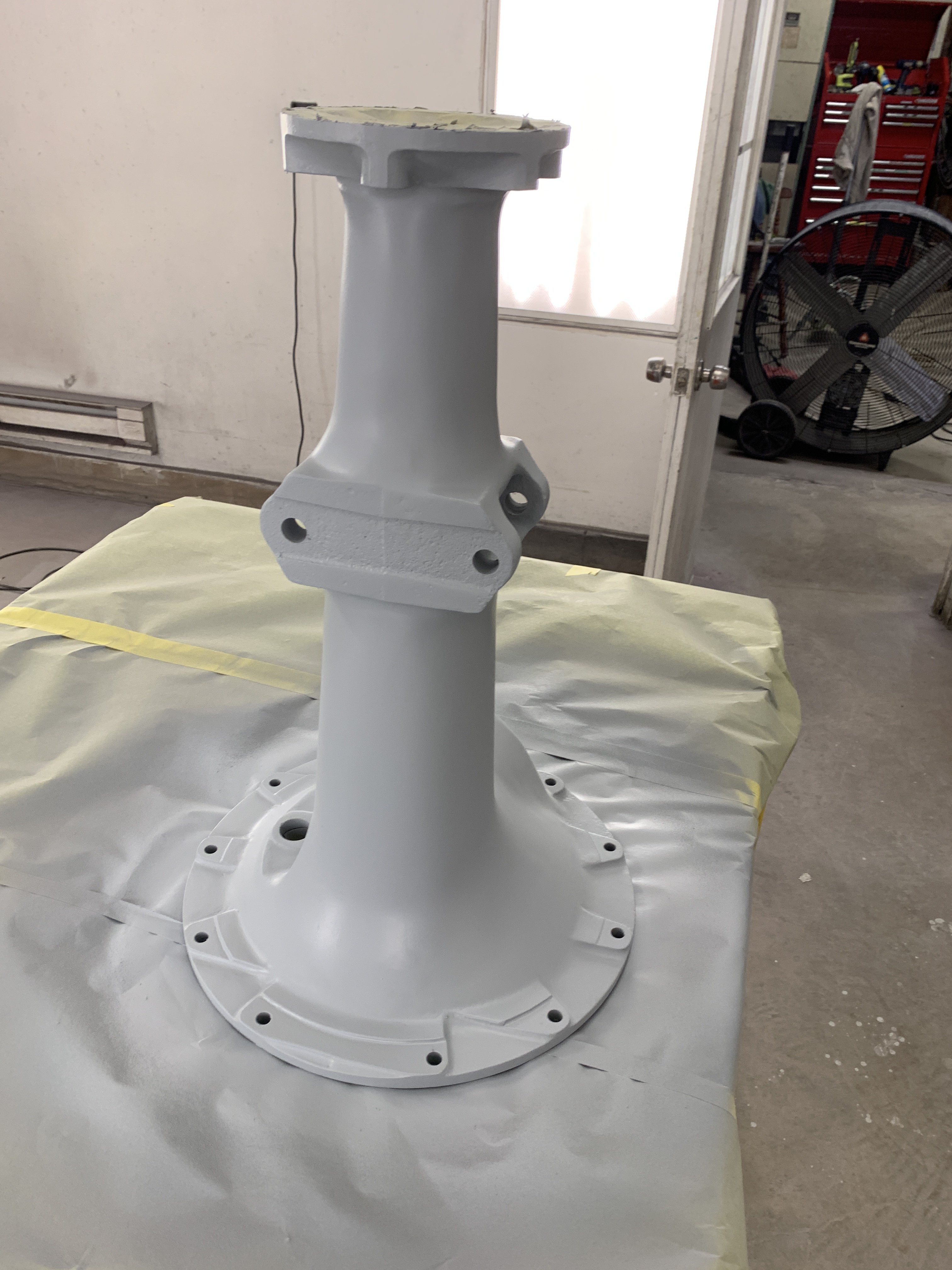

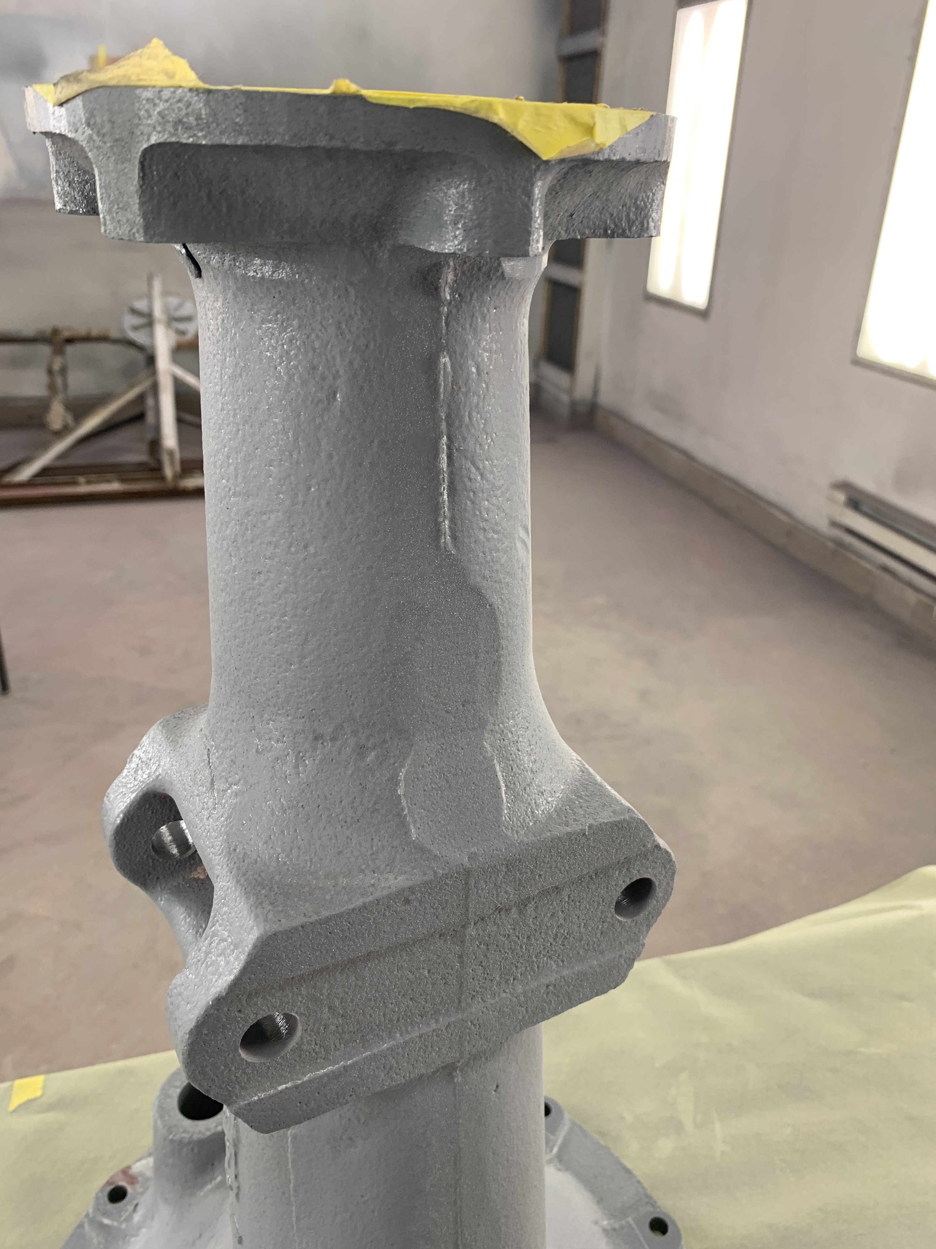

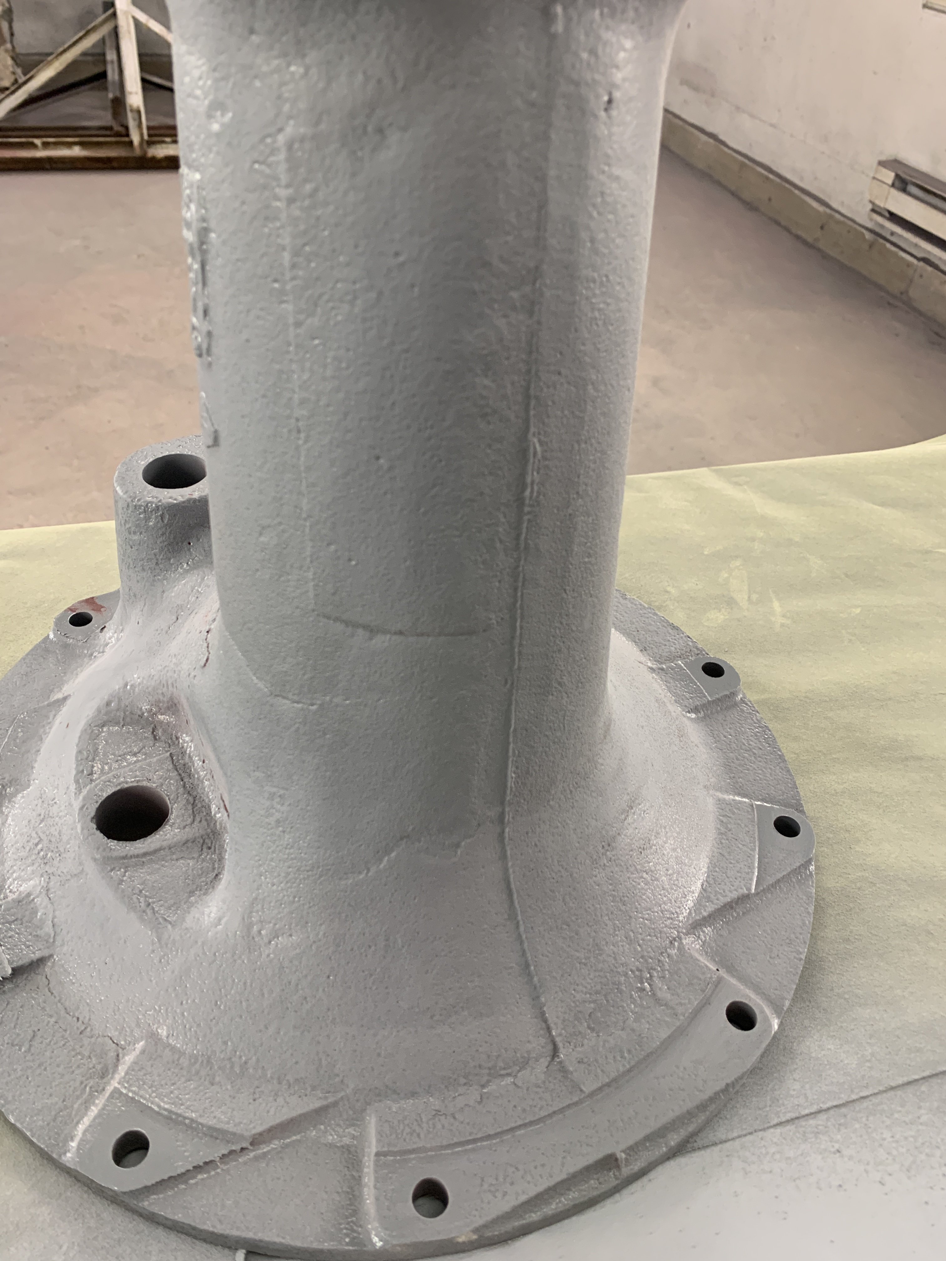

Got some filler primer on it today. Now I need to sand that with guide coat and maybe one more coat of filler primer.
You are going to have to dip all your tools in the rubber stuff so when you reassemble the tractor you don't chip that beautiful finish.
Lol. Assembly is always nerve racking with everything painted. You have to tape everything up you dont want scratched. Then if you have any mechanical issues or leaks its not fun.

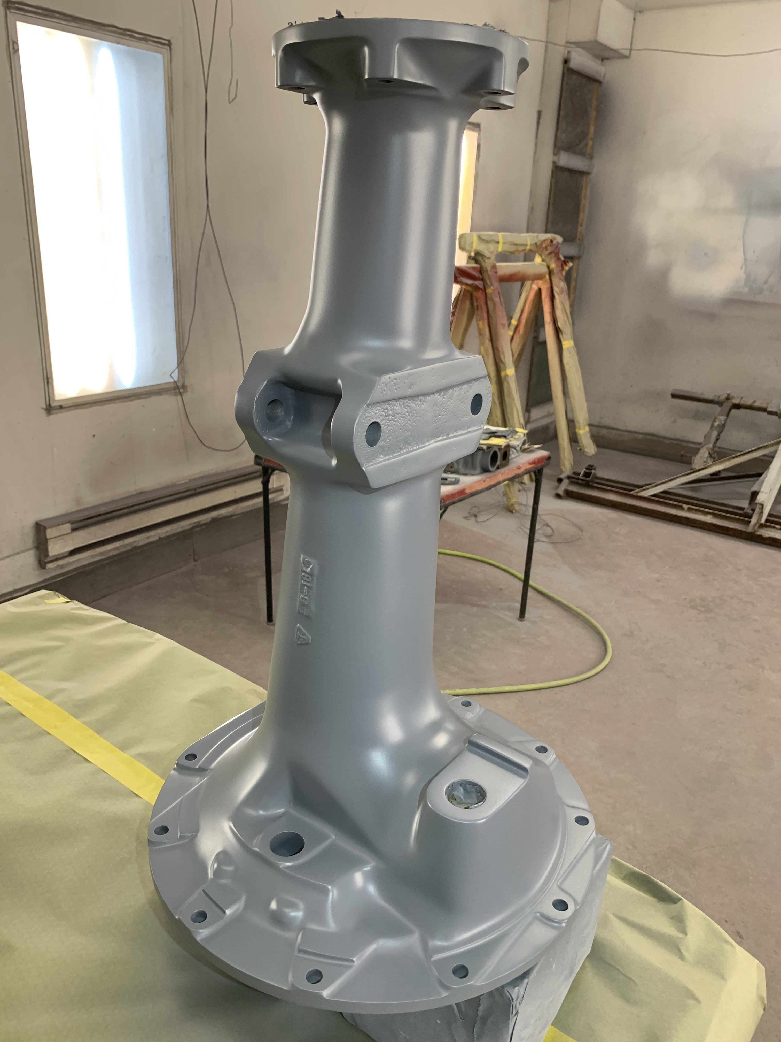

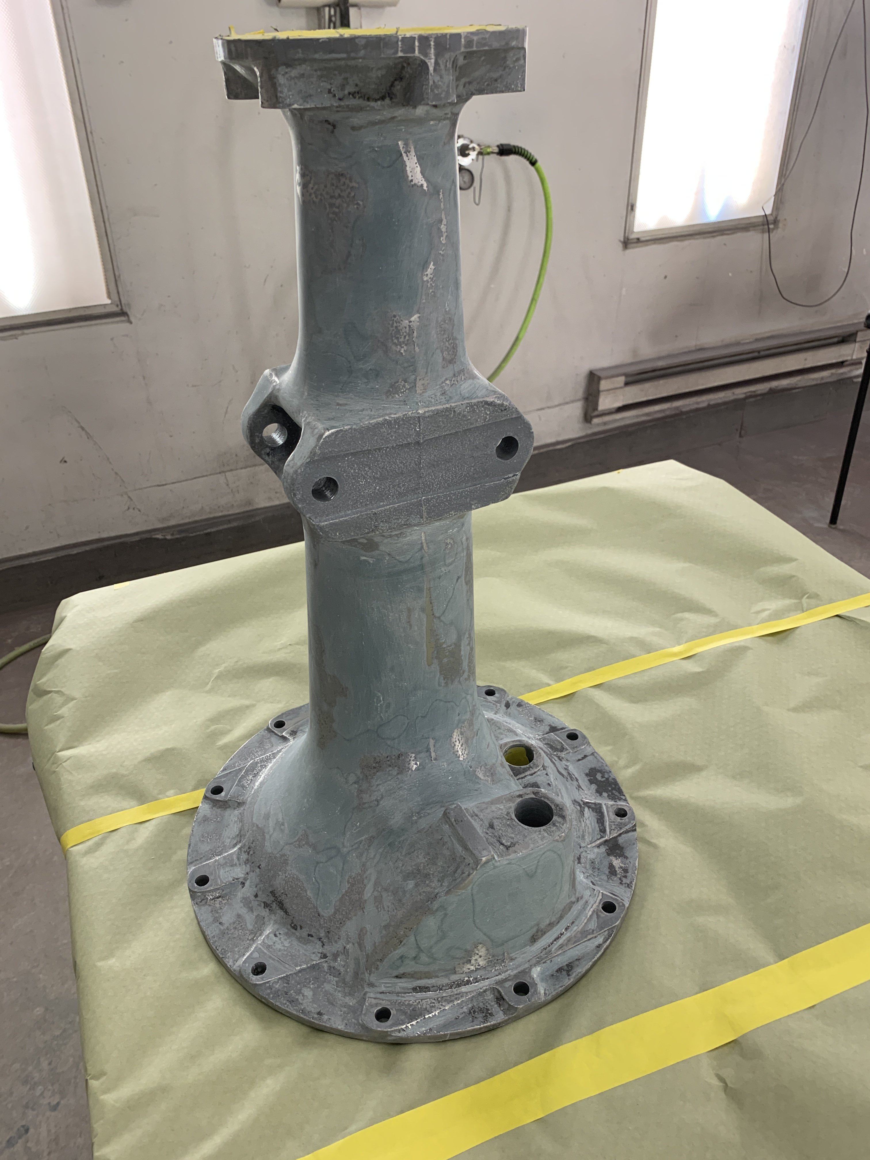

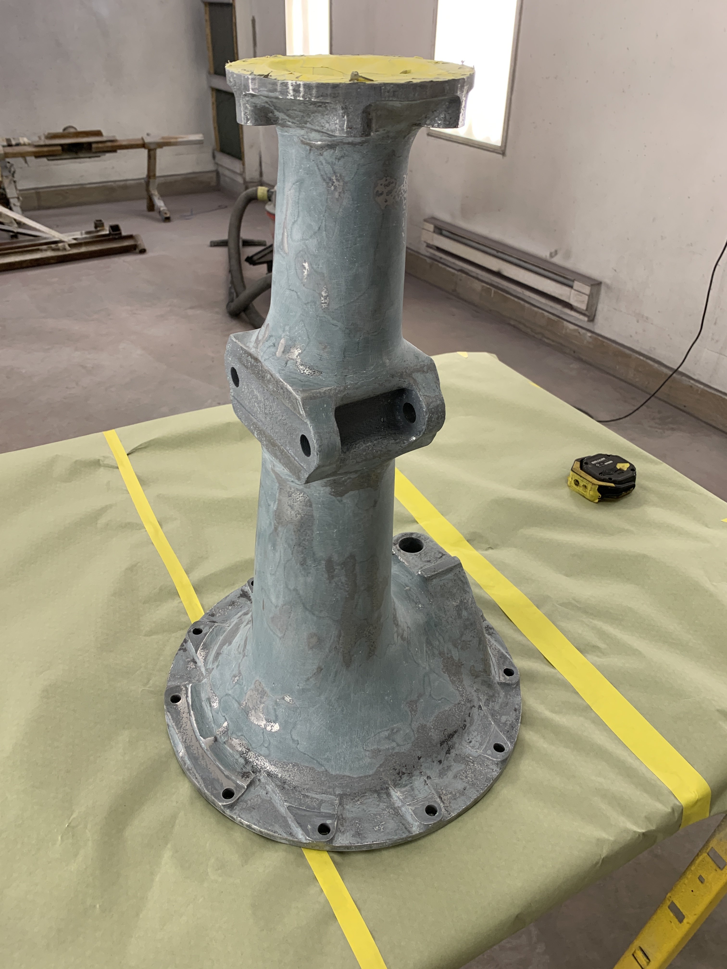

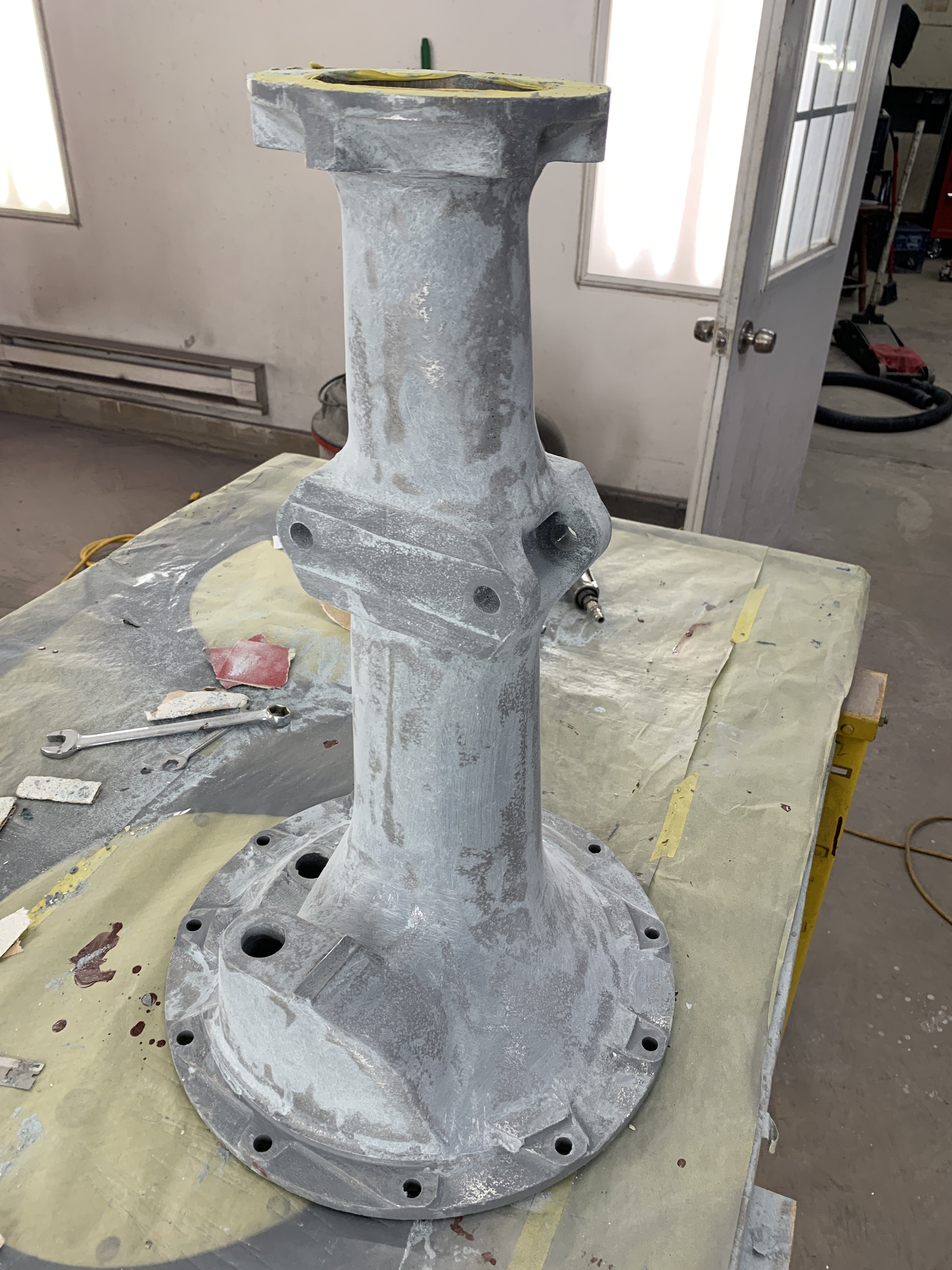

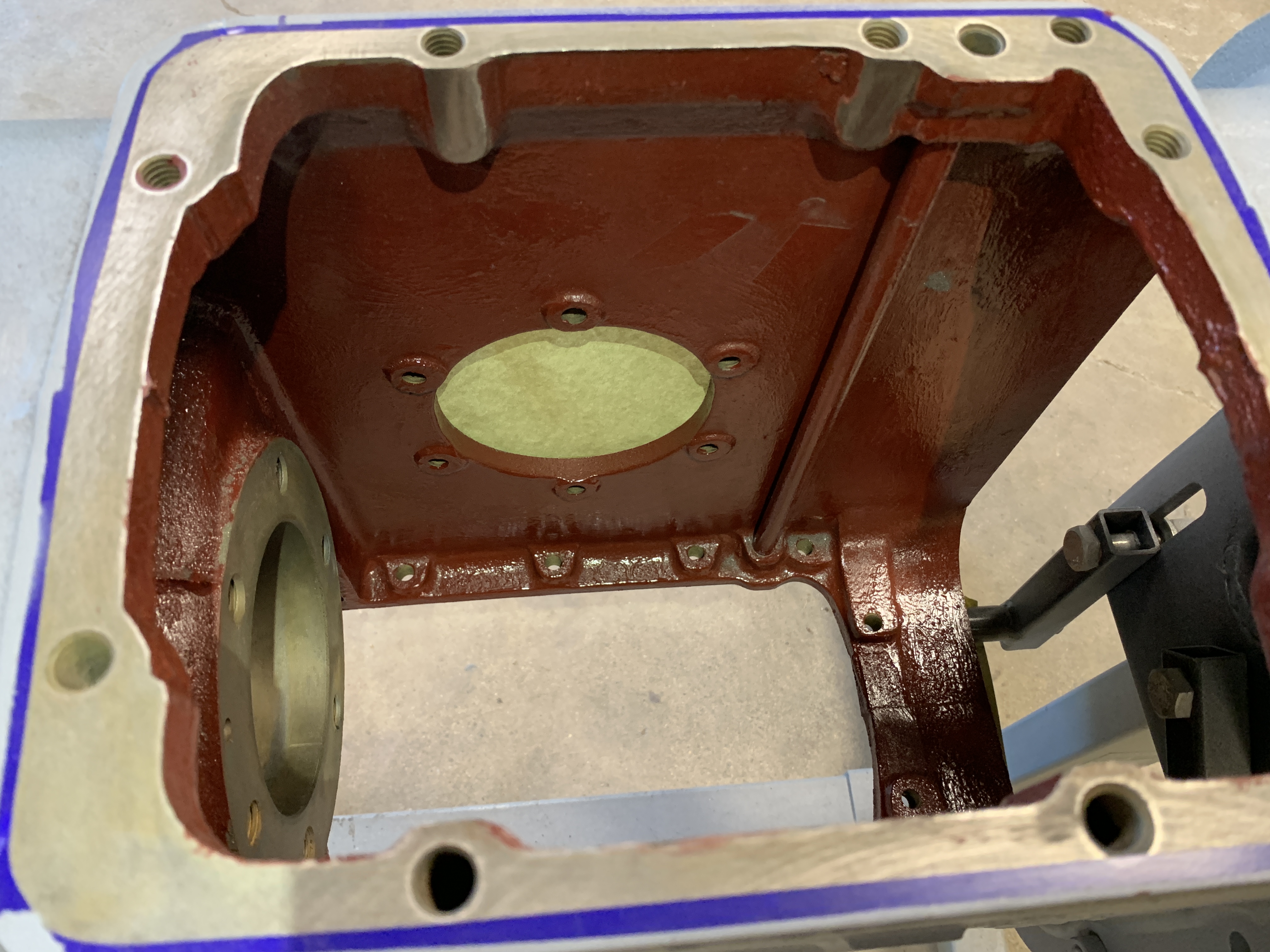

After lots of sanding the other side is in high build. You can see how rough it was before.

A lot of work going into this! Will it be a real working-in-the-field tractor or a showroom one? Going to look great when you are finished.
I don't have the patience to do this kind of quality work. For mine, if it looks half-way decent and runs well, good enough. Half of my running 8N is gray primer colored. No, not the one in my avatar. That will get a decent paint job, since it is (ostensibly) for the SO! zuhnc
I won't be using any body filler or trying to smooth anything but you have inspired me to try my hand at spray painting. Starting with small parts to get the hang of controlling drips and sags. Remains to be seen if I can get good enough to paint the sheet metal.
I plan to take it to some shows. It will not get much work as I have a bobcat and a 50 8N for that. If I needed it for work I definitely would just be getting it running and not putting a shiny paint job on it.

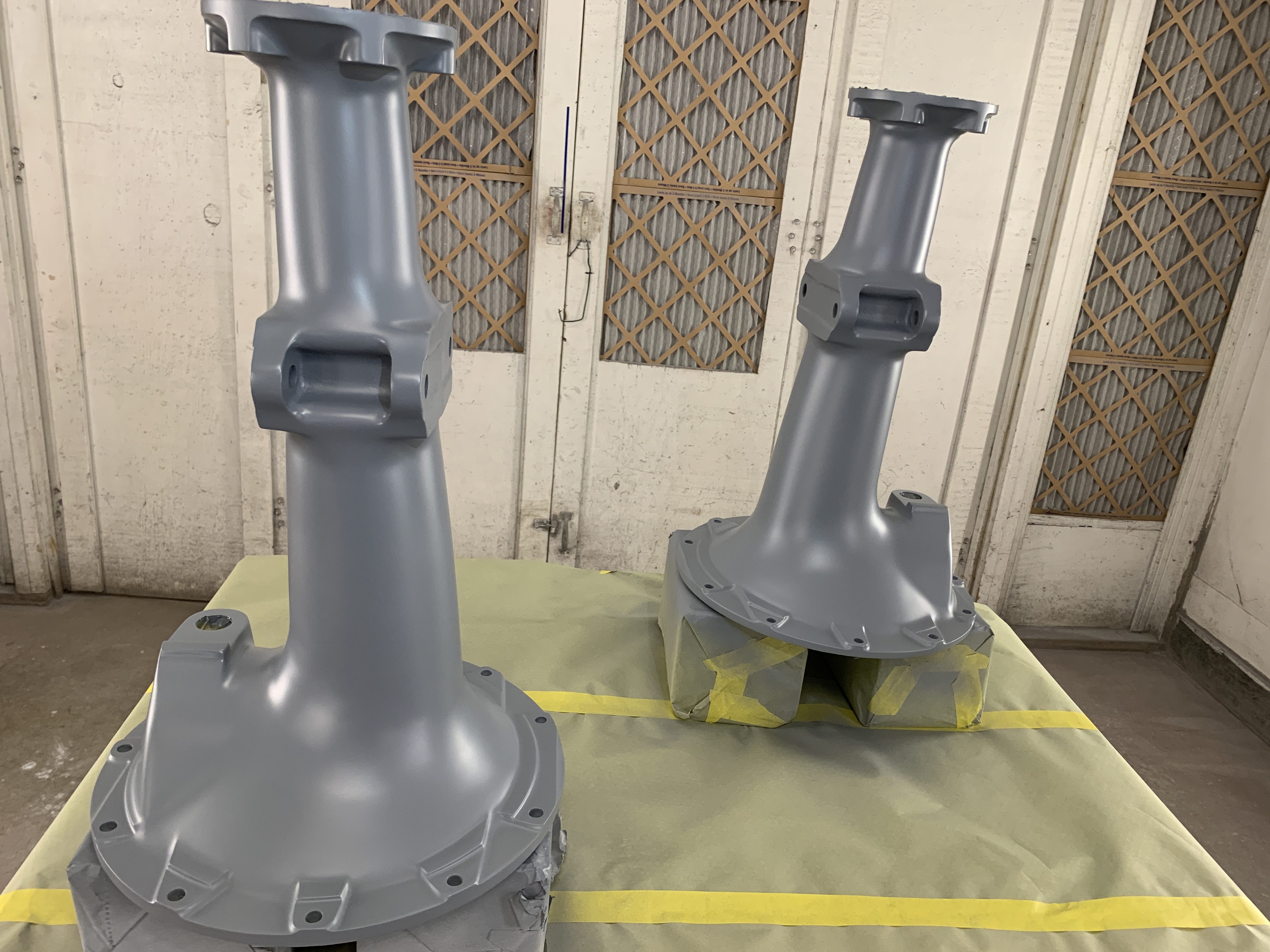

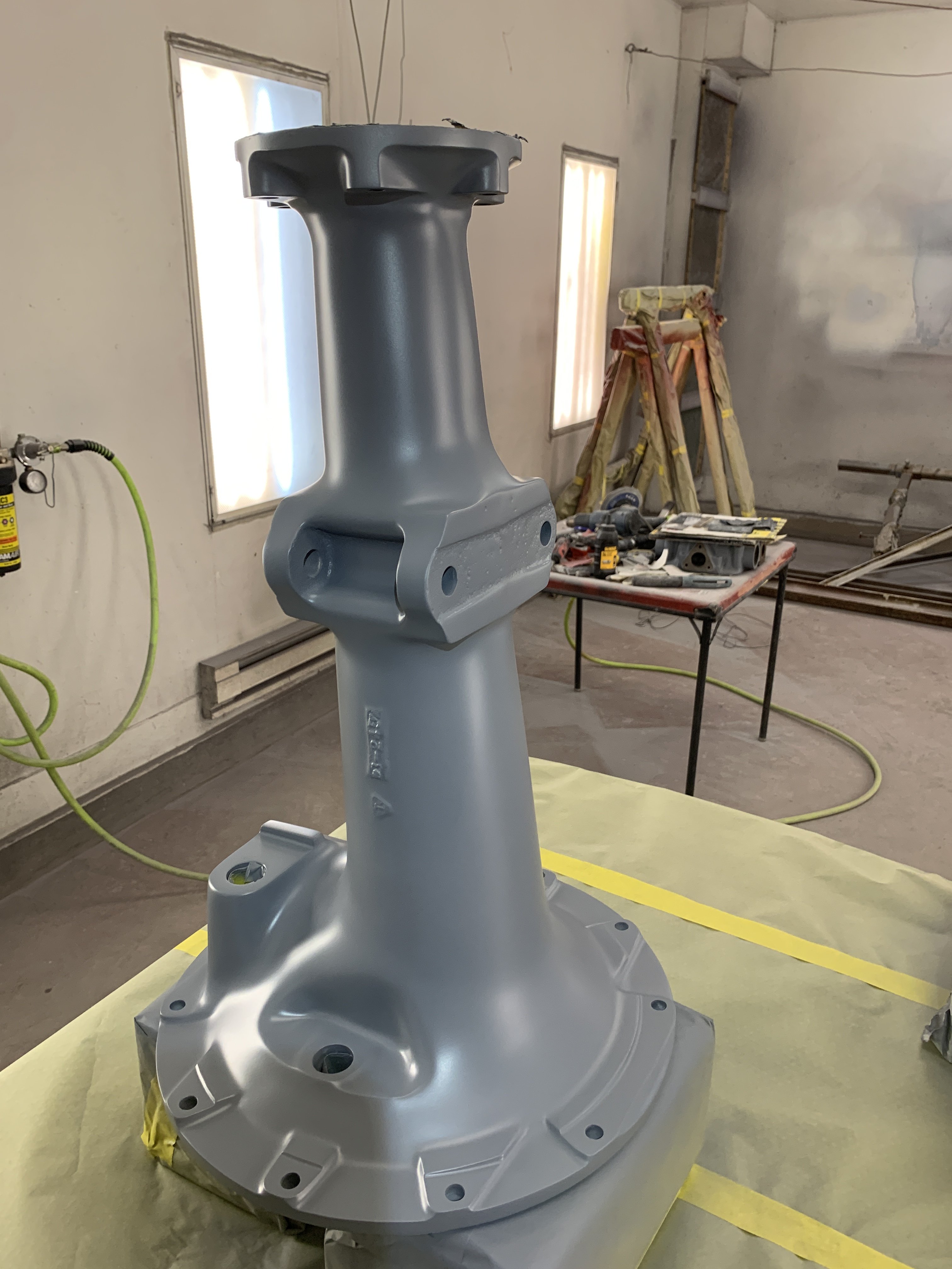

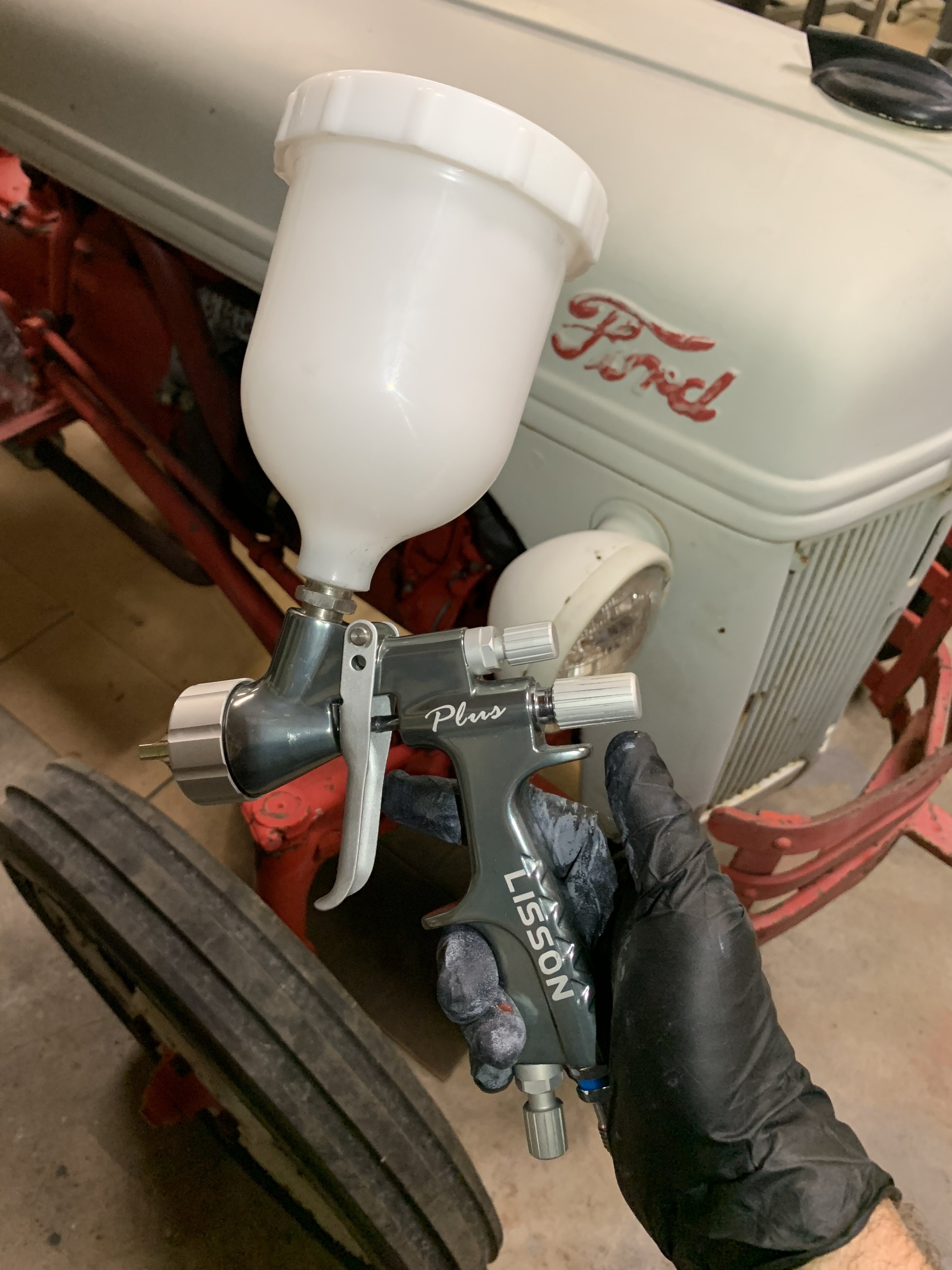

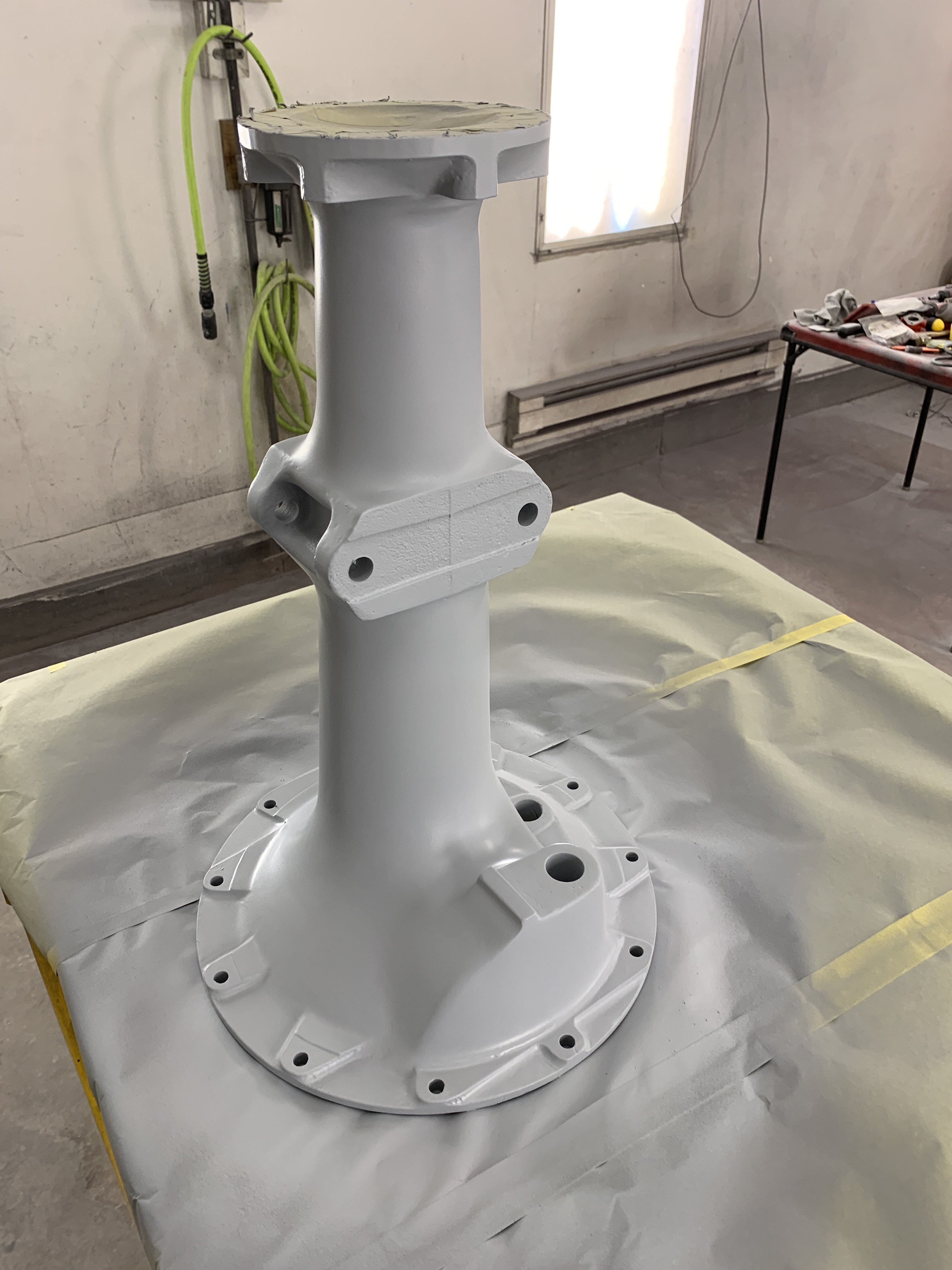

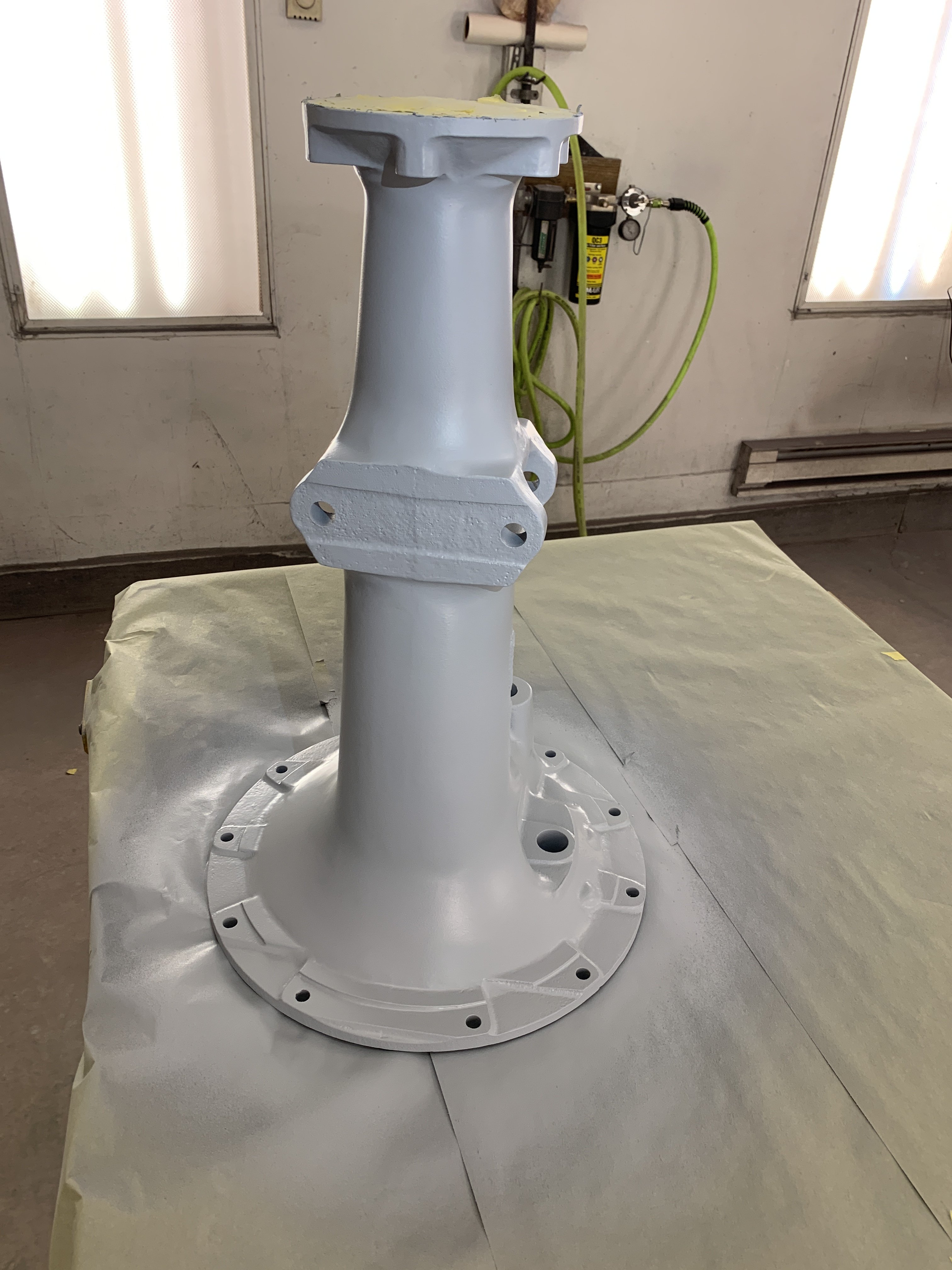

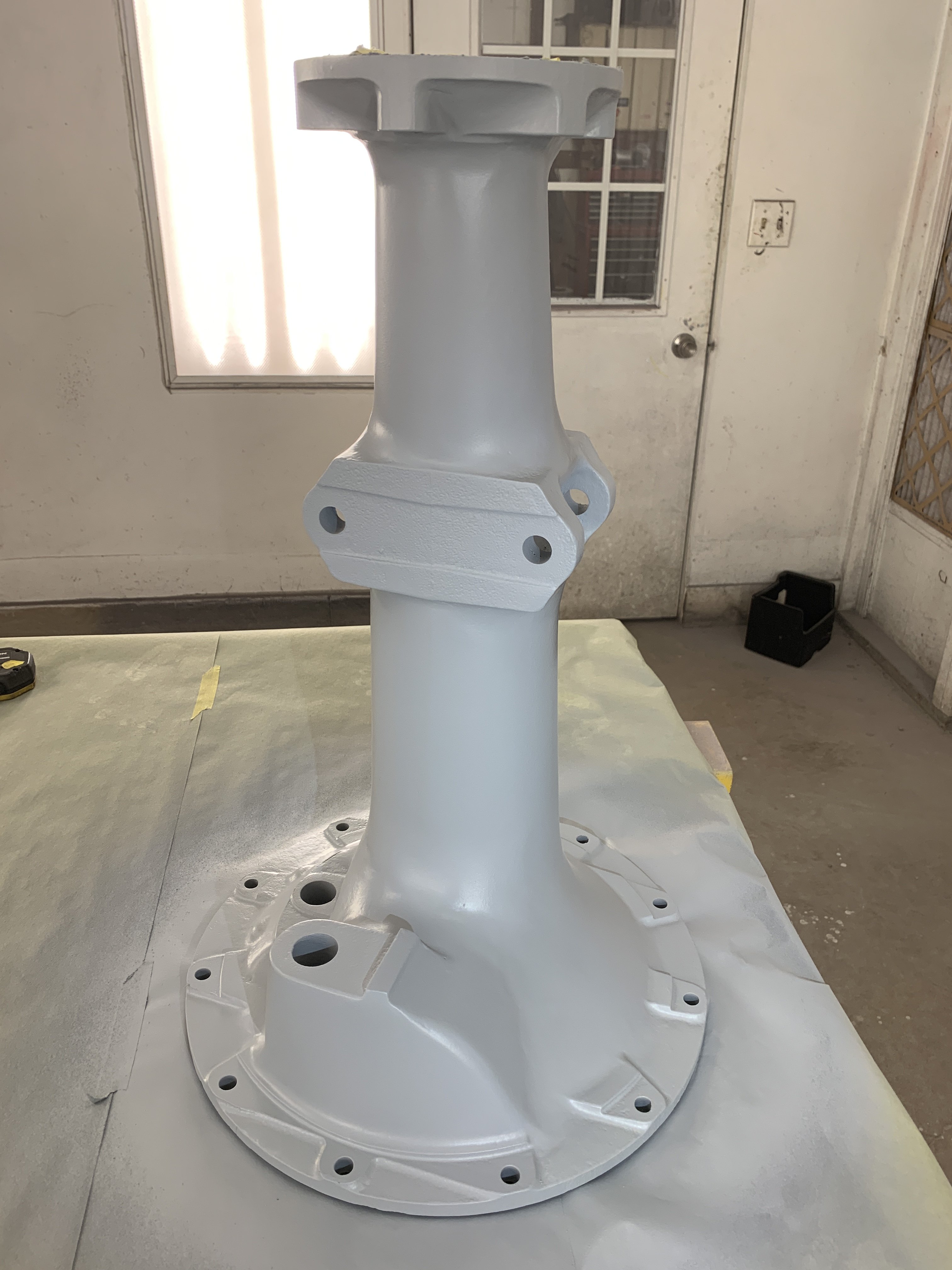

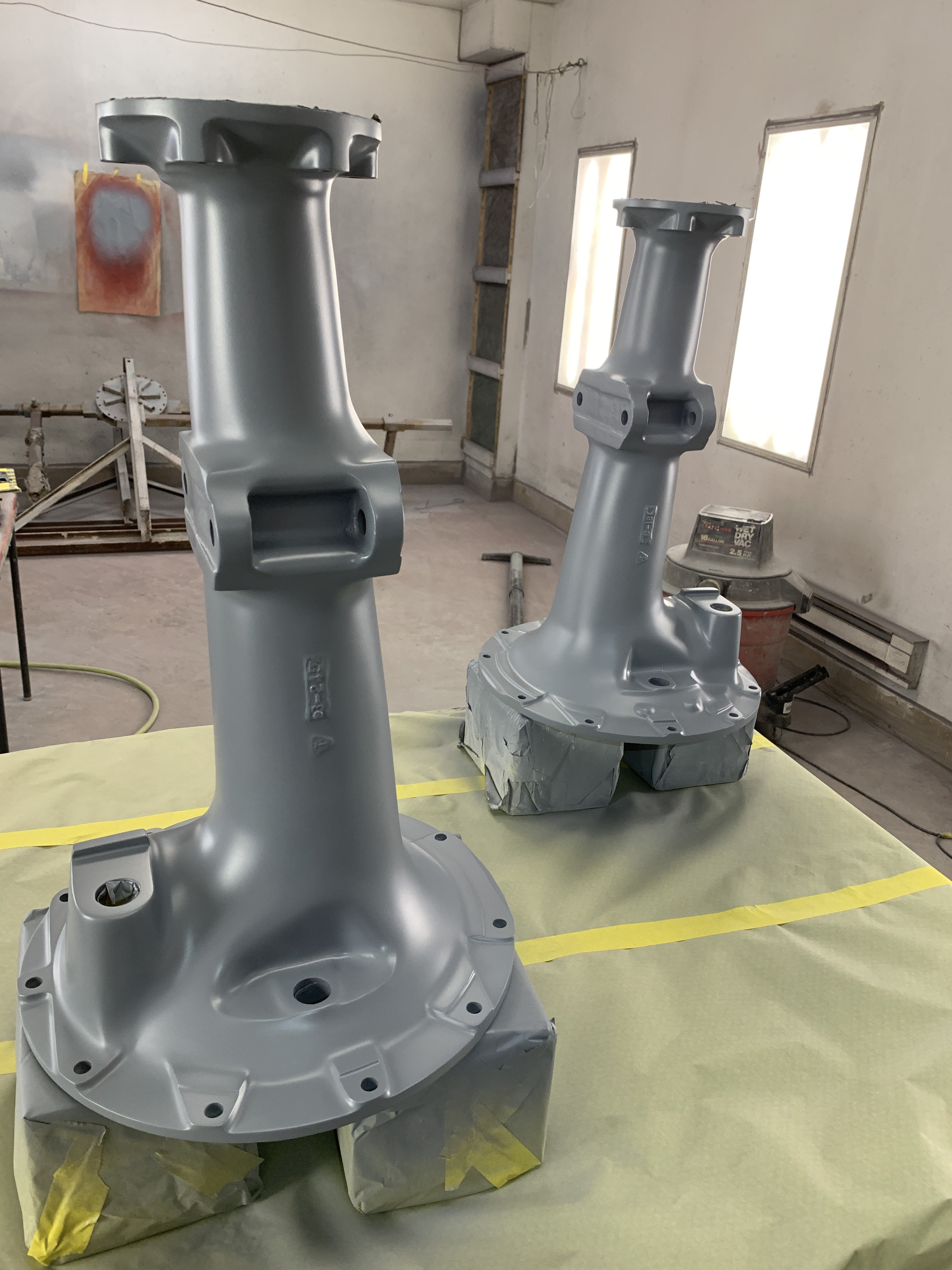

Had some issues with the high build primer hardener being wrong but finally got back to it and got the axle housings in sealer today. I also got to try out my new $20 spray gun I got from temu just to use for sealer and it worked great.
