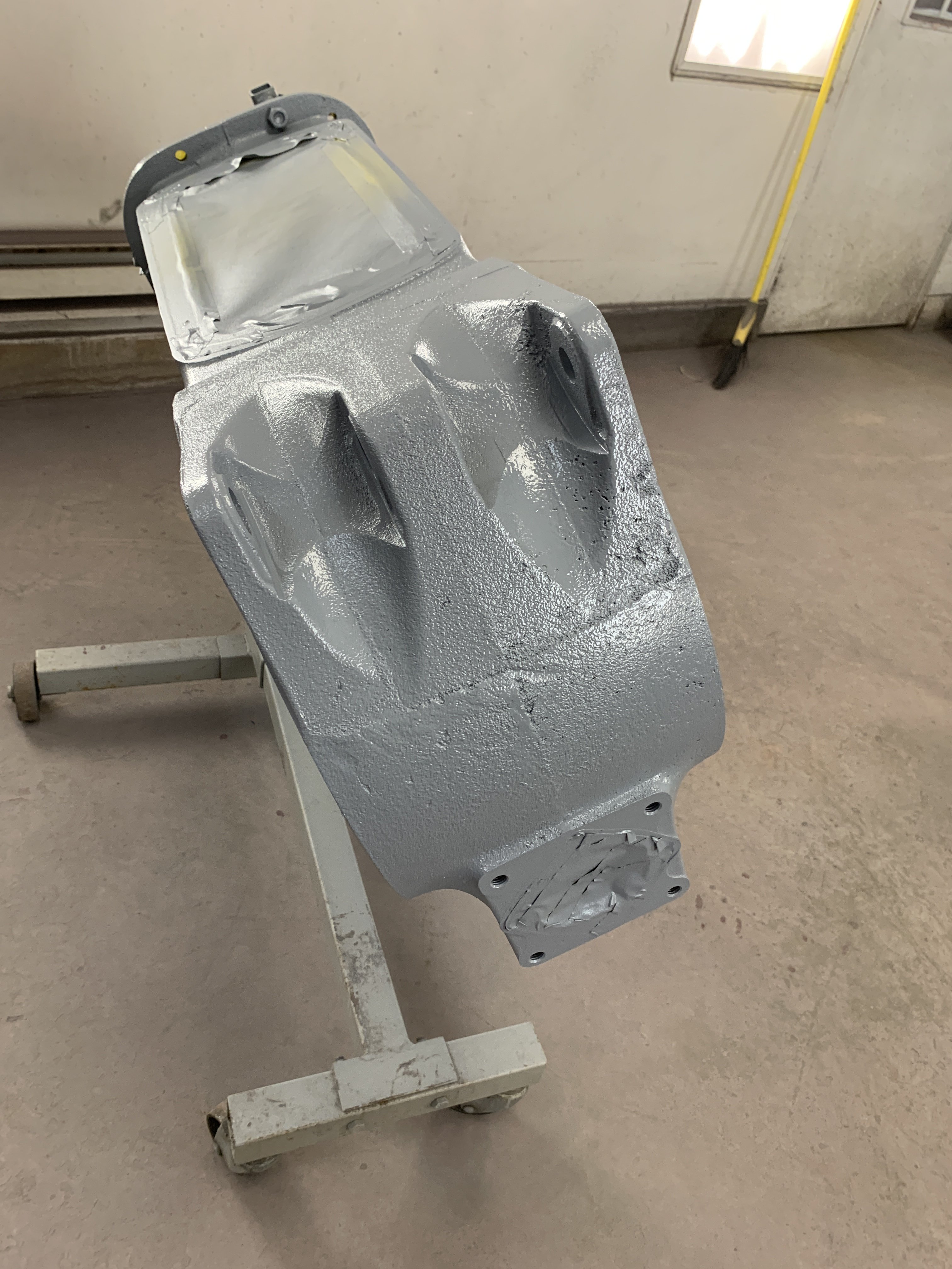

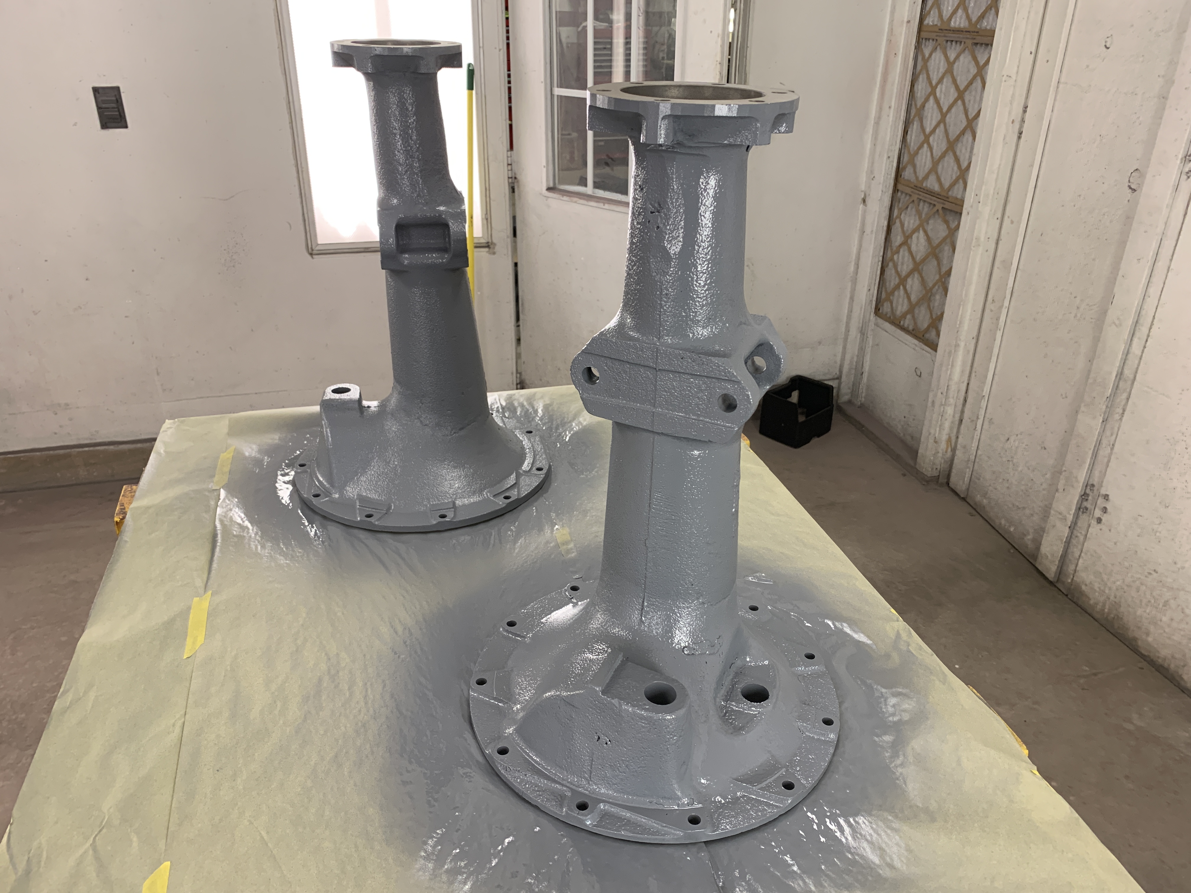

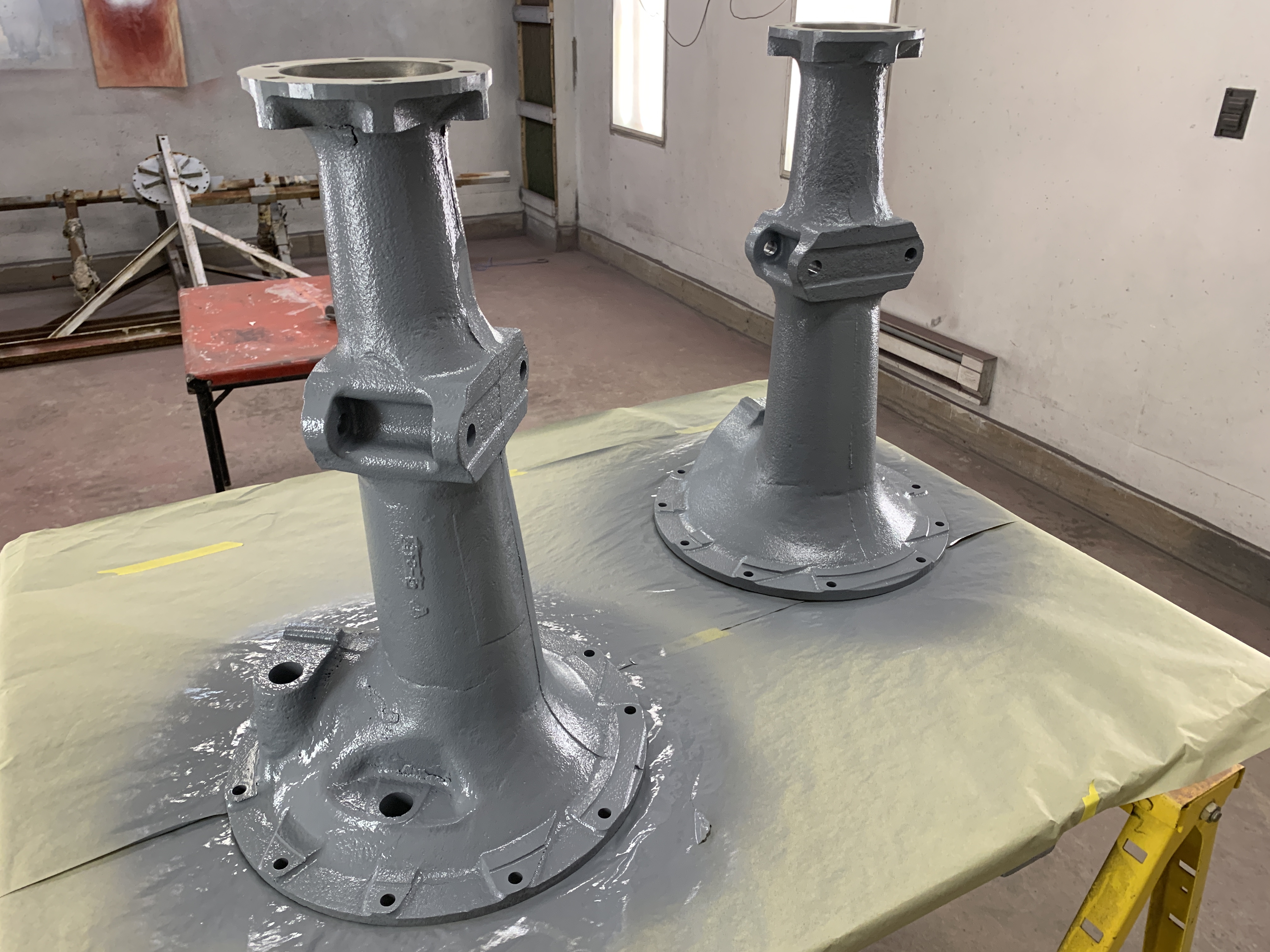

Got the axle housings coated with epoxy primer.
Went ahead and got them coated for rust protection. Smoothing out the surface will come later.

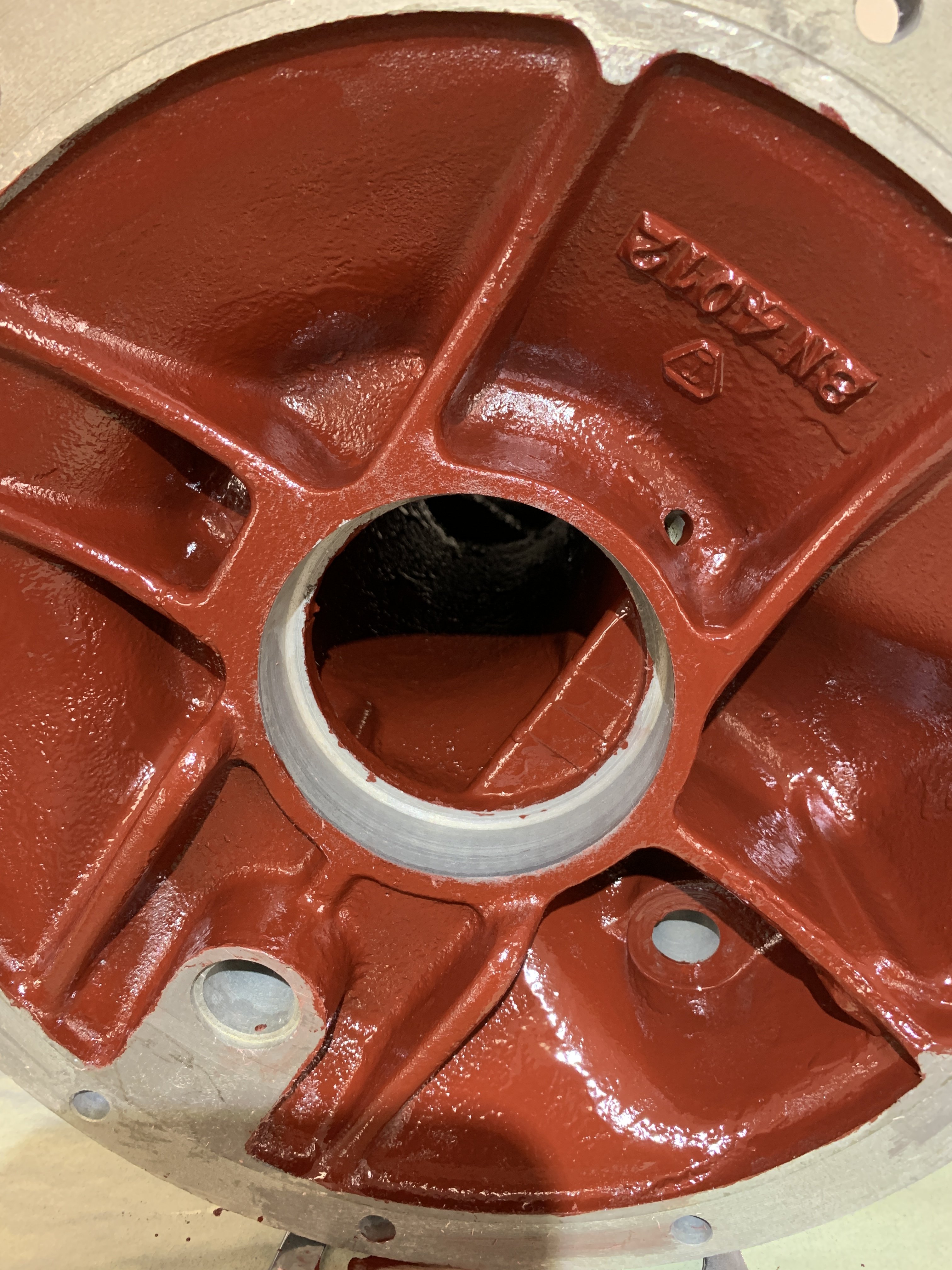

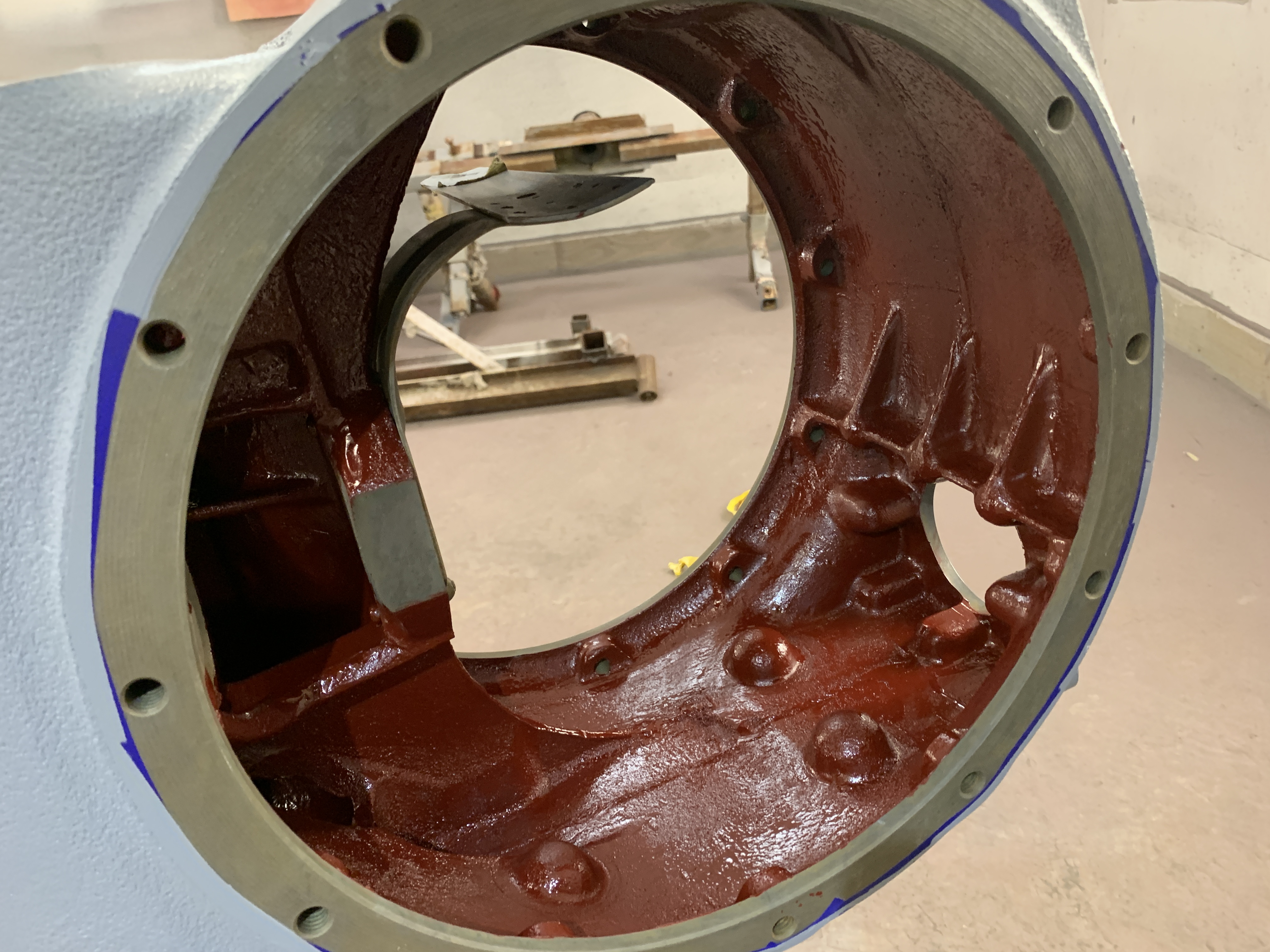

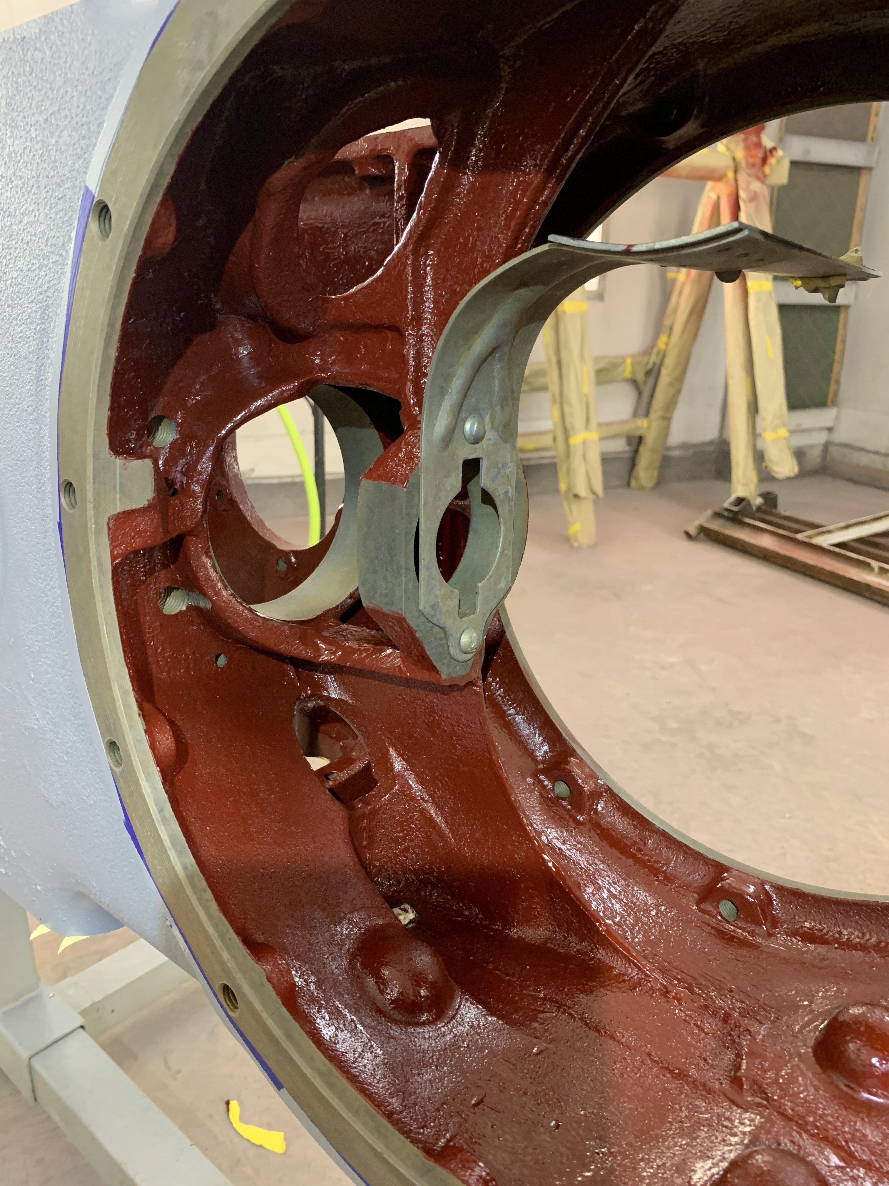

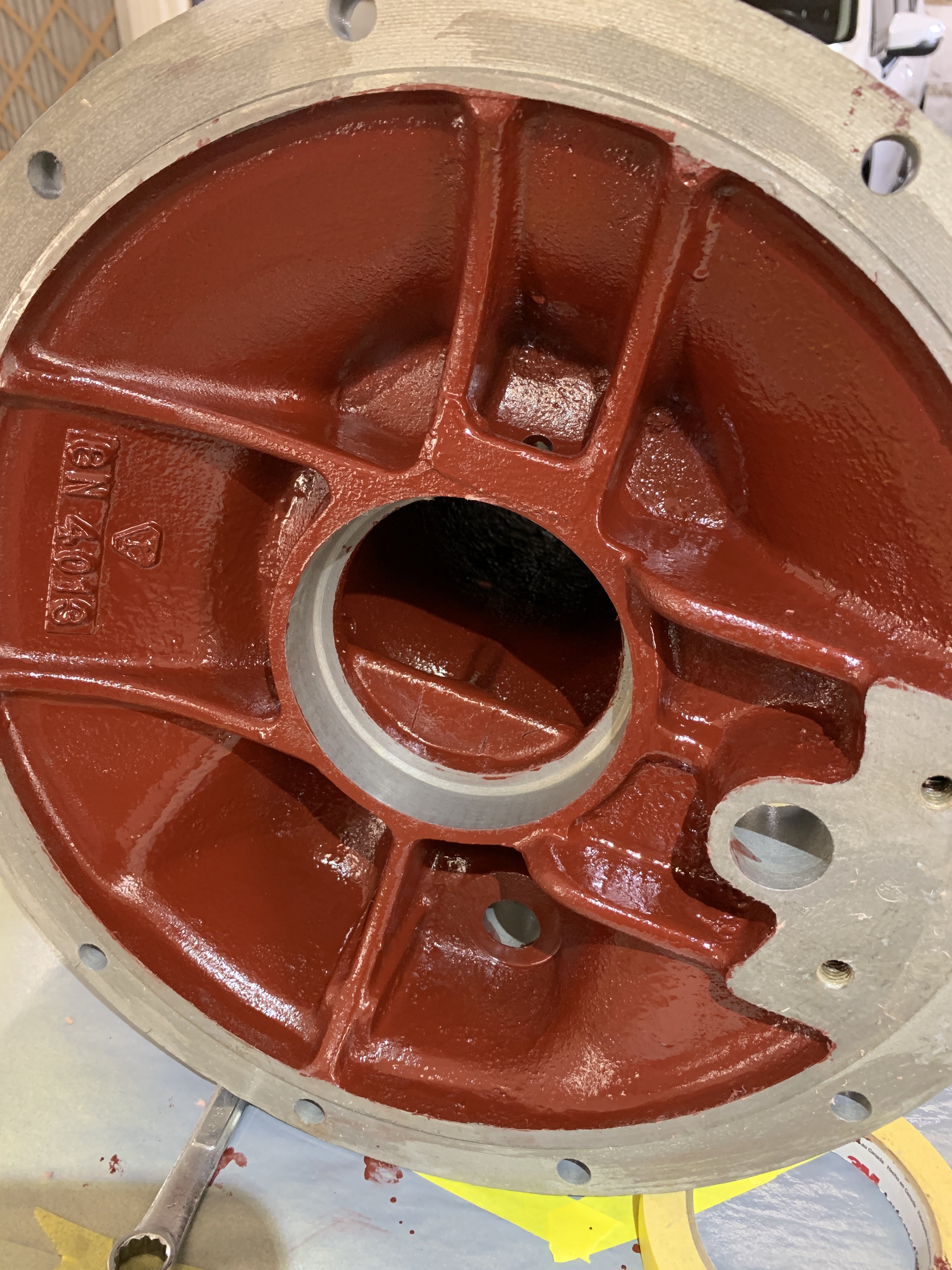

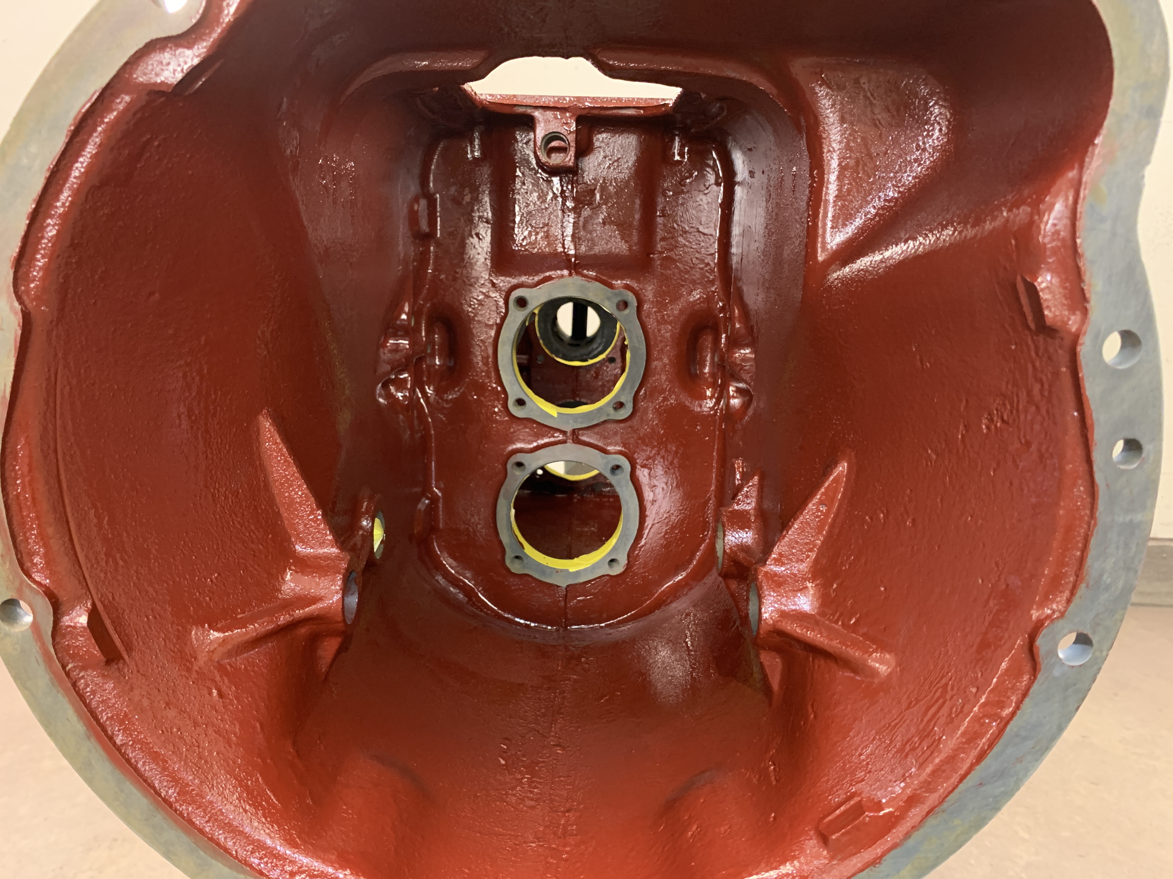

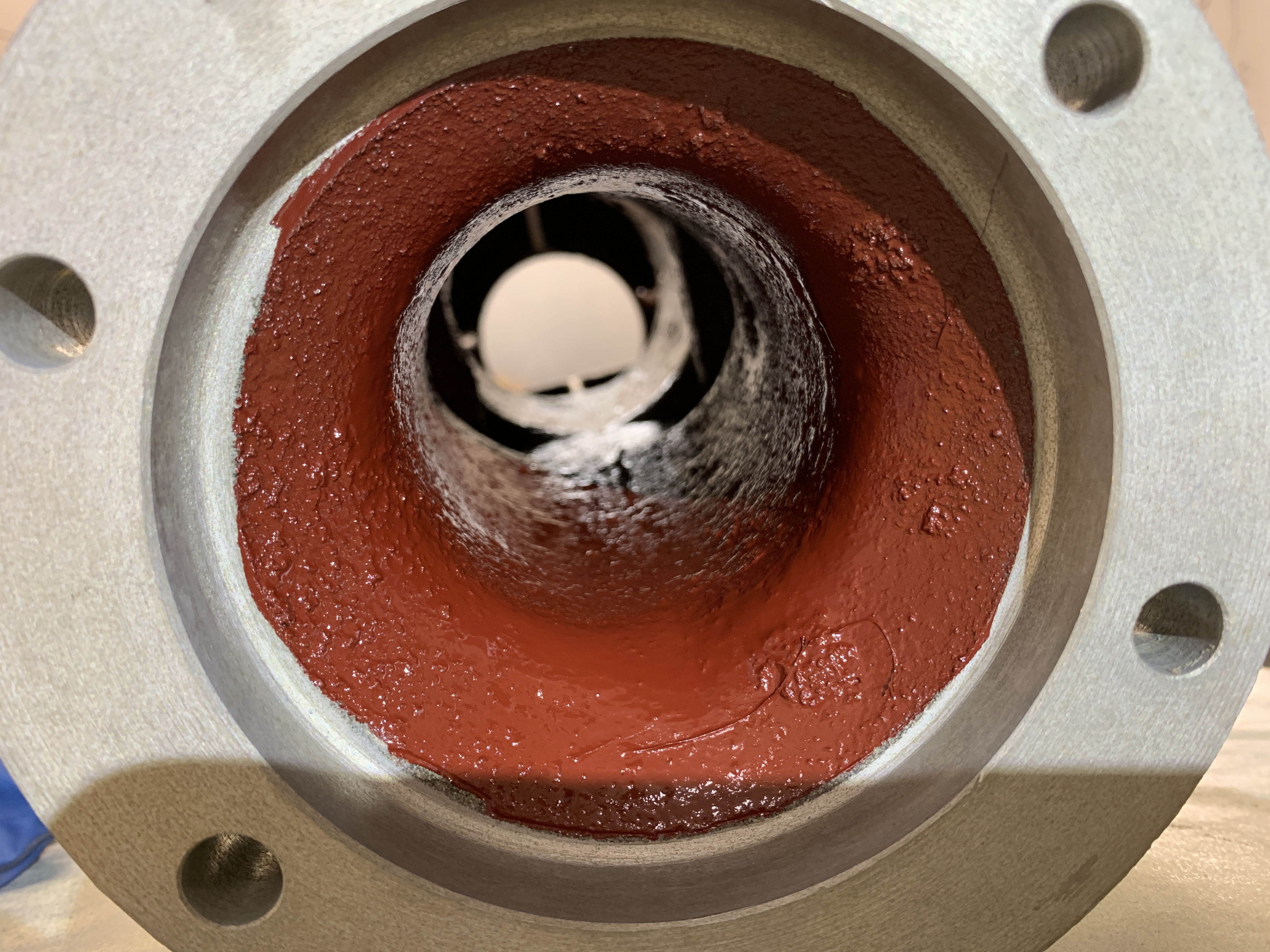

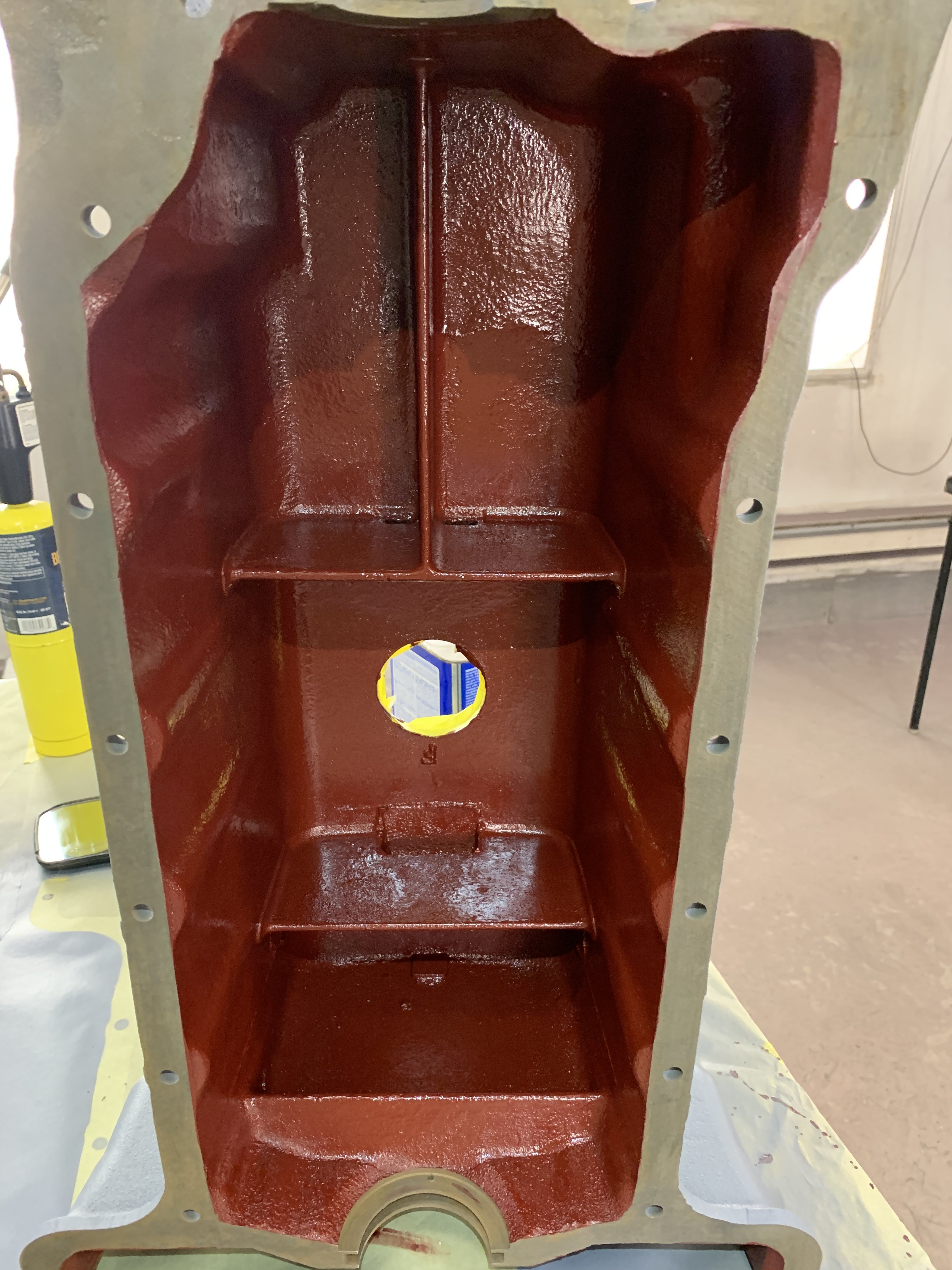

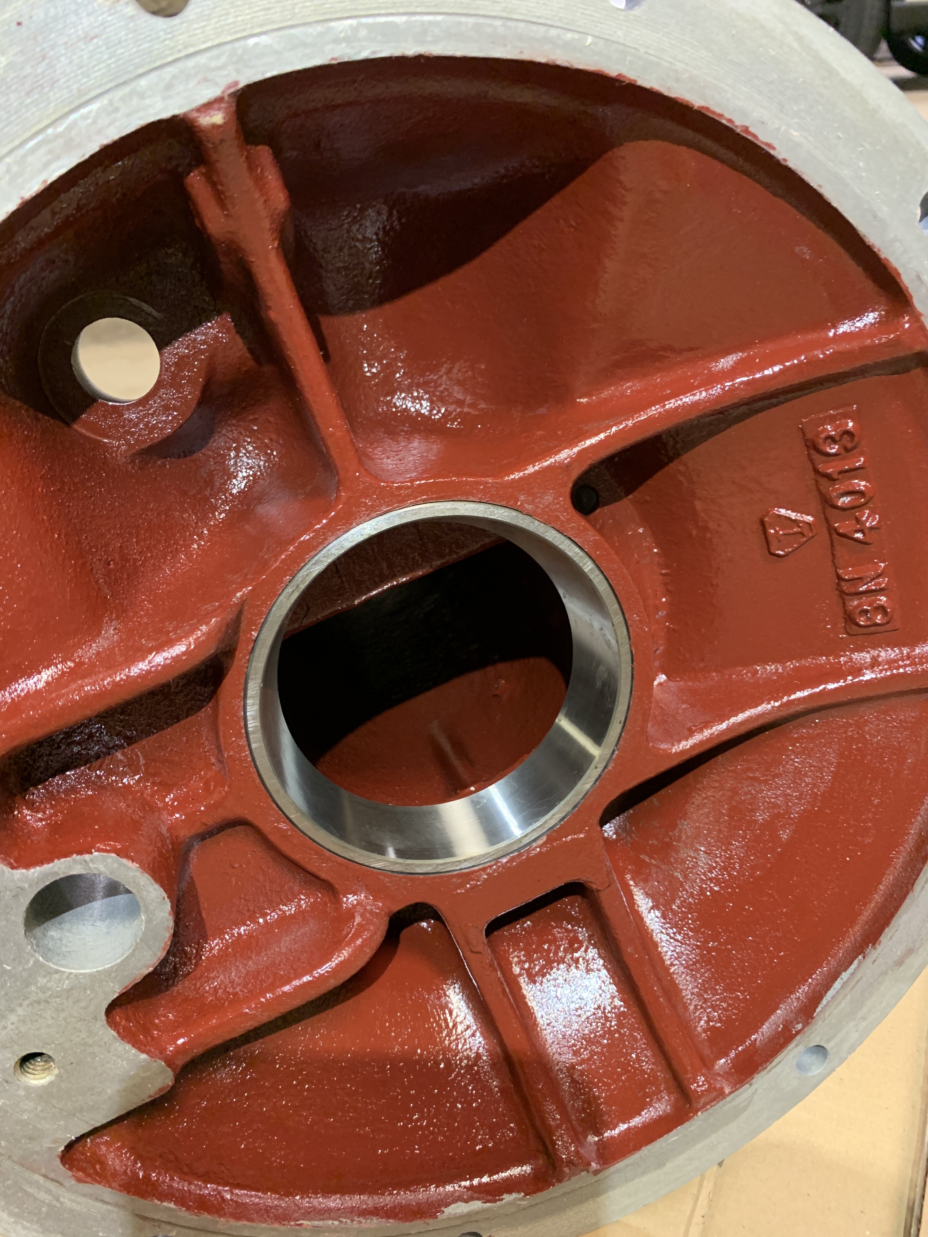

Got the glyptal brushed on the inside of the axle housings. Took awhile with a long radiator brush.

Looks nice. How does the Epoxy primer work? Do you mix small batches of resin/hardener and brush on? Another thing I need to Google!
Thanks, You get the Epoxy primer itself and a catalyst basically a resin/harderner like you mentioned. It mixes 2:1 primer to catalyst and you wait 15min before you spray it on after mixing. It seals off the metal to prevent rusting and does not fill like a high build primer. I use an HVLP spray gun just like I do when spraying the color.
I am using PPG Omni MP170 and the catalyst is MP175.
You can also put body filler right over top of it. No need to sand to bare metal. The epoxy does need scuffed though if waiting more than 3 days to topcoat.
You can get it in a spray can but if you dont use it all after mixing it goes bad.
My next step after I get these all in epoxy will be to scuff or sand the epoxy and then put some body filler over the problem areas. After that I will coat it with MP282 surfacer which is a filler or 2k primer which is also 2 parts.
I dont do this for a living so I am not an expert. My dad restored a lot of classic cars so I have been around it for a long time and worked with him some in my spare time.

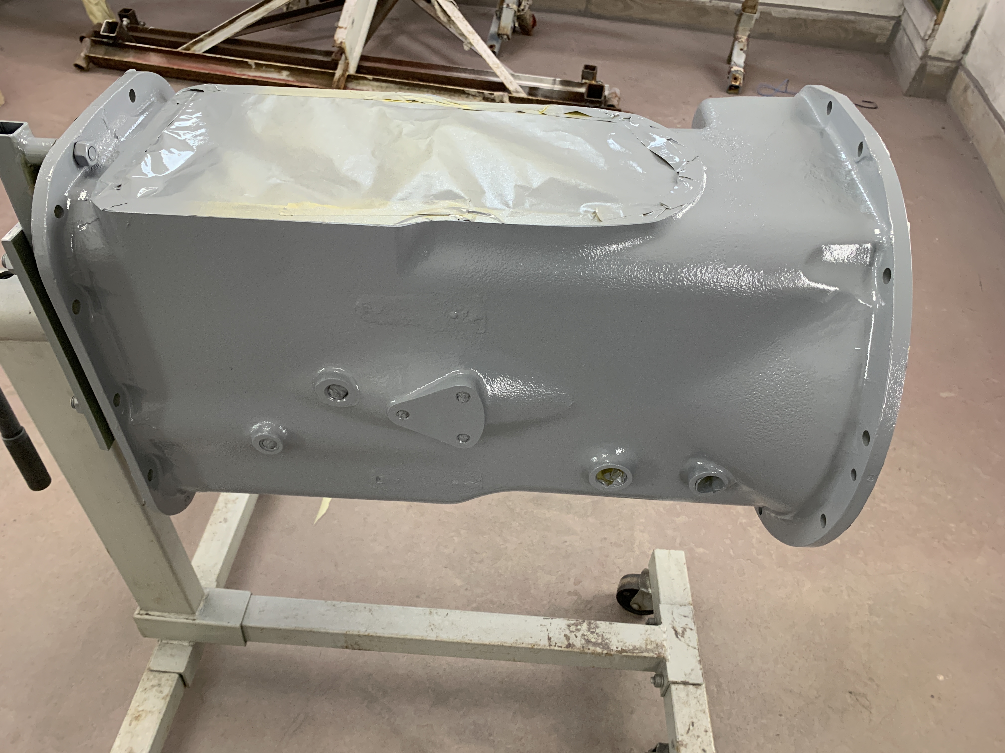

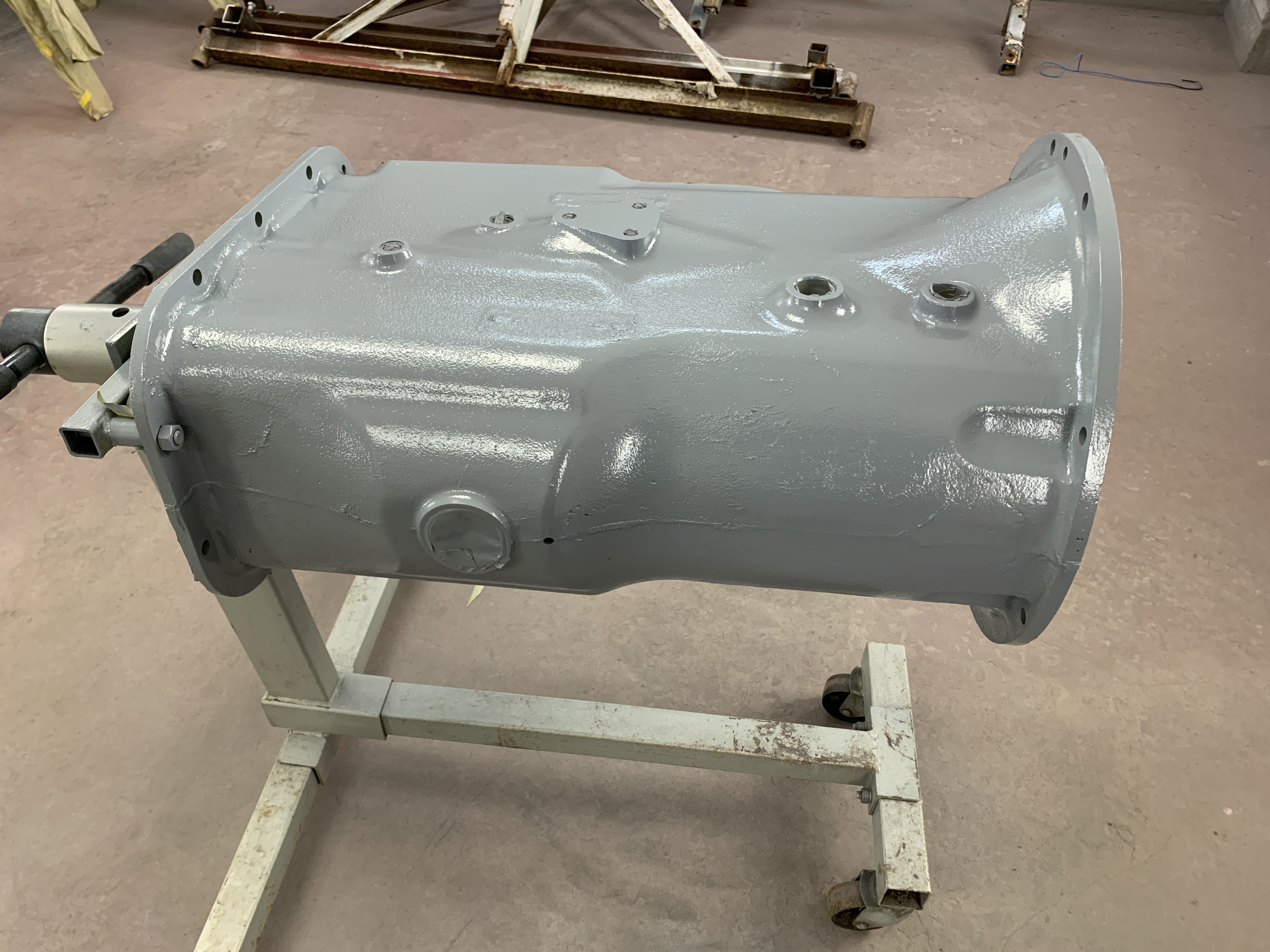

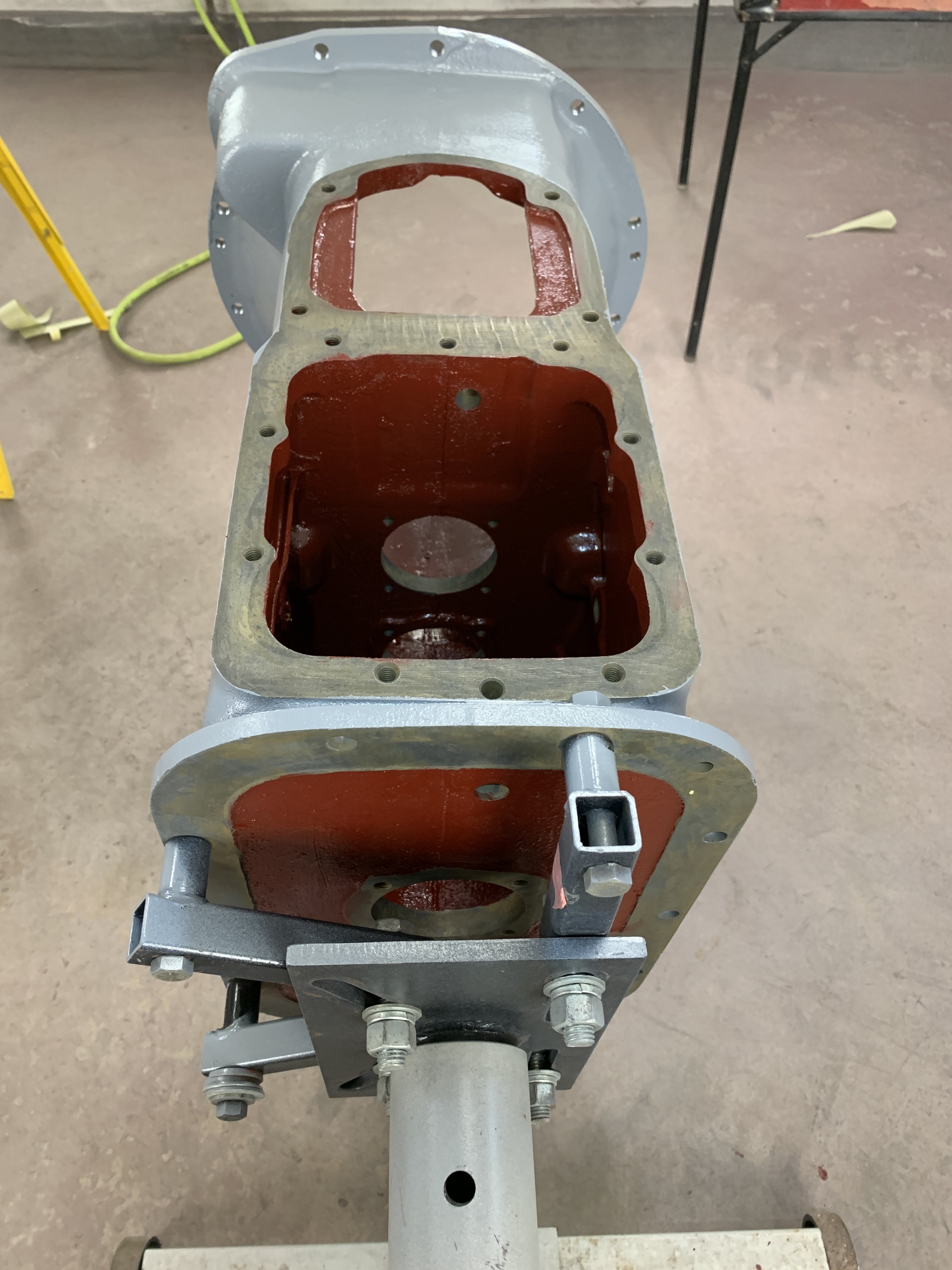

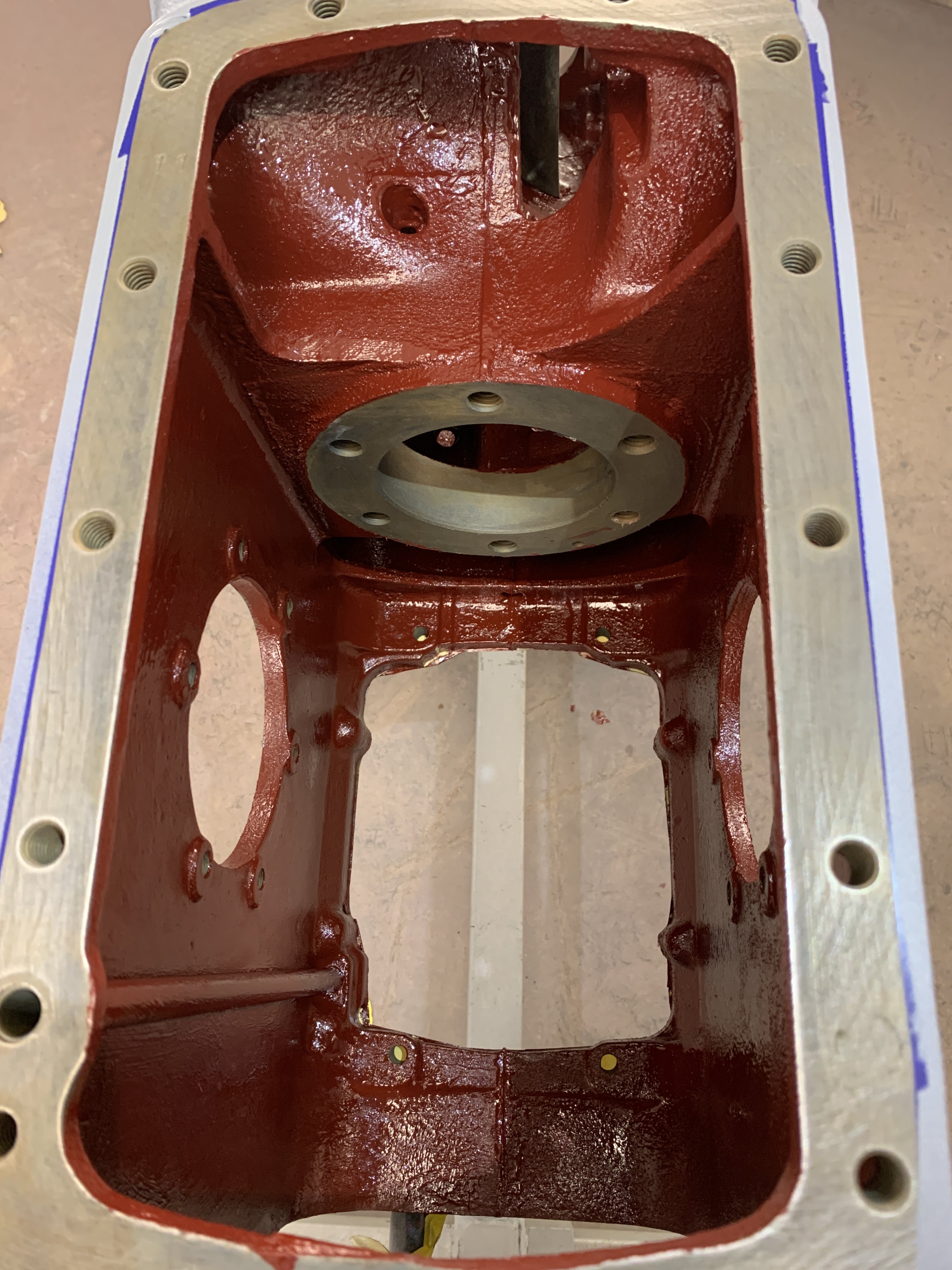

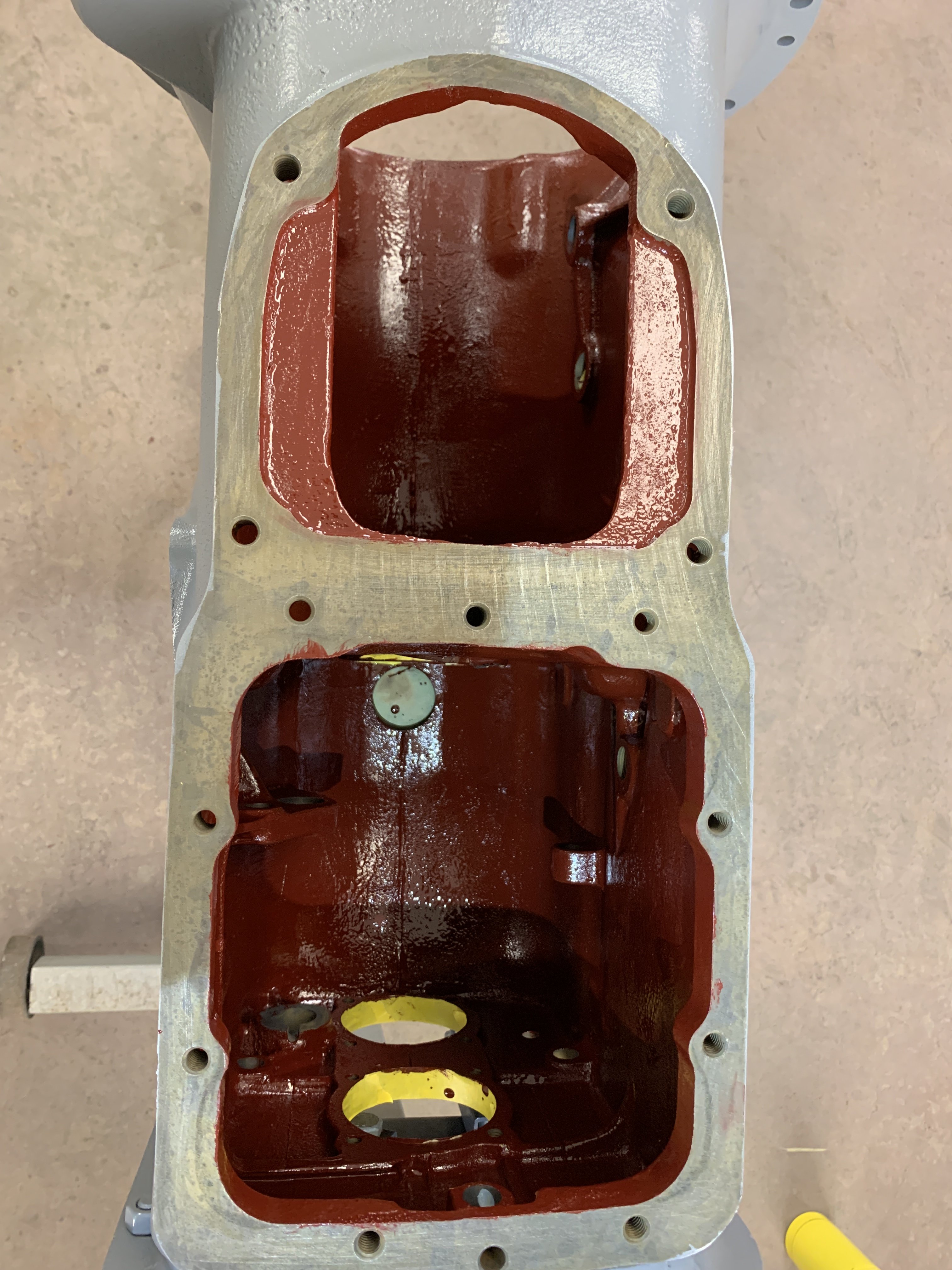

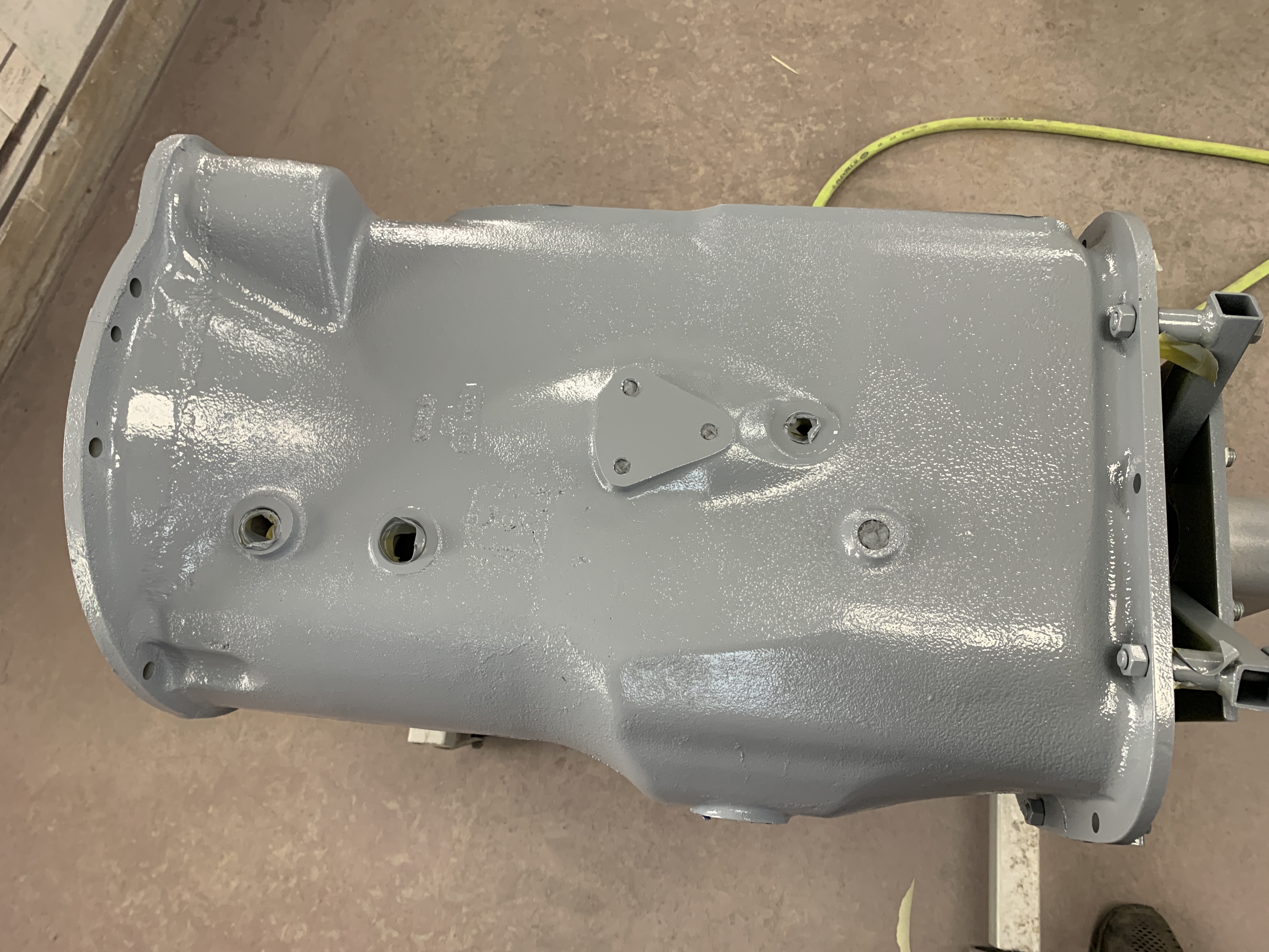

Glyptal on the trans is finished.

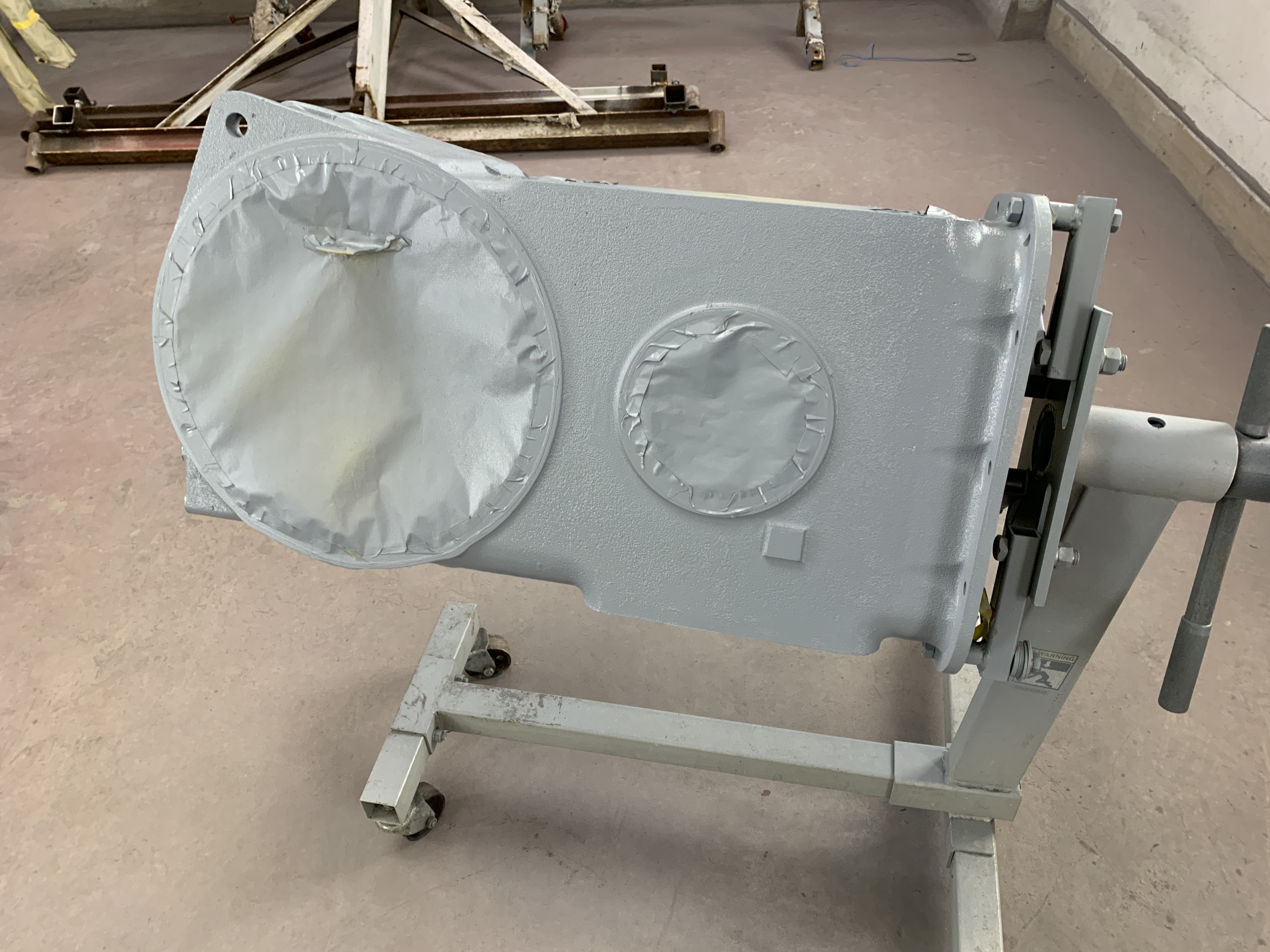

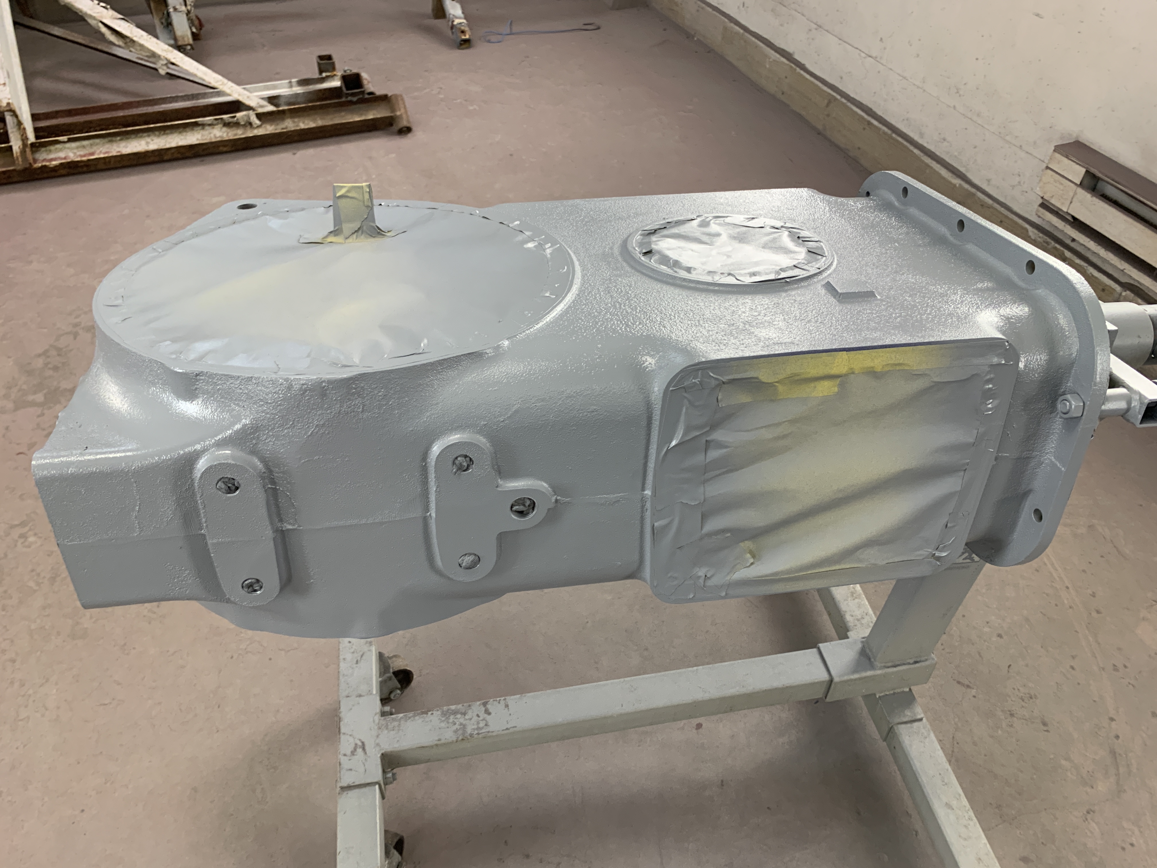

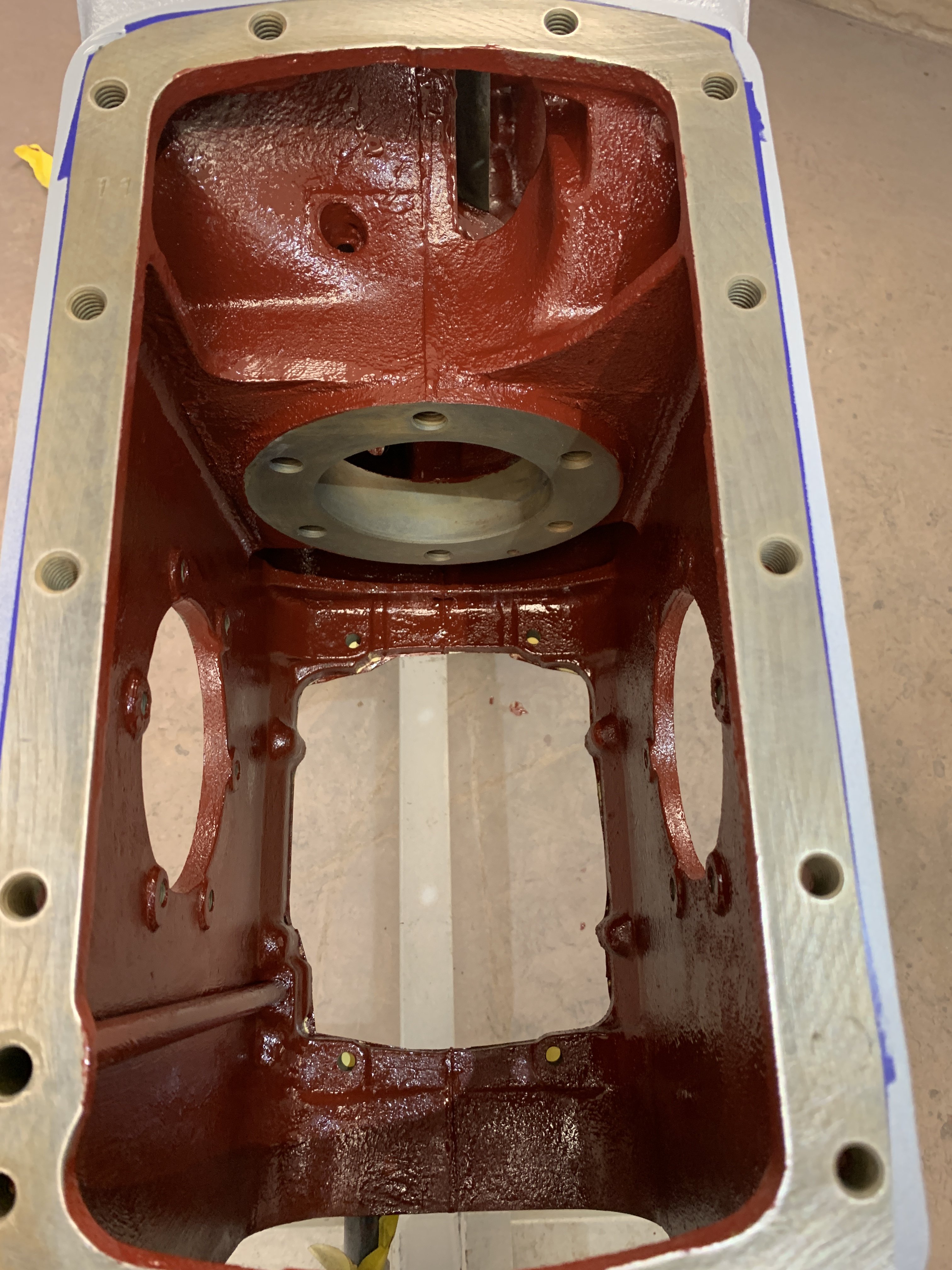

Rear diff housing. It was hot today and the glyptal was drying fast. This one also took the longest to get everything painted inside. I think if I got it in a spray can as well I could of sprayed some of the hard to reach spots and saved some time.

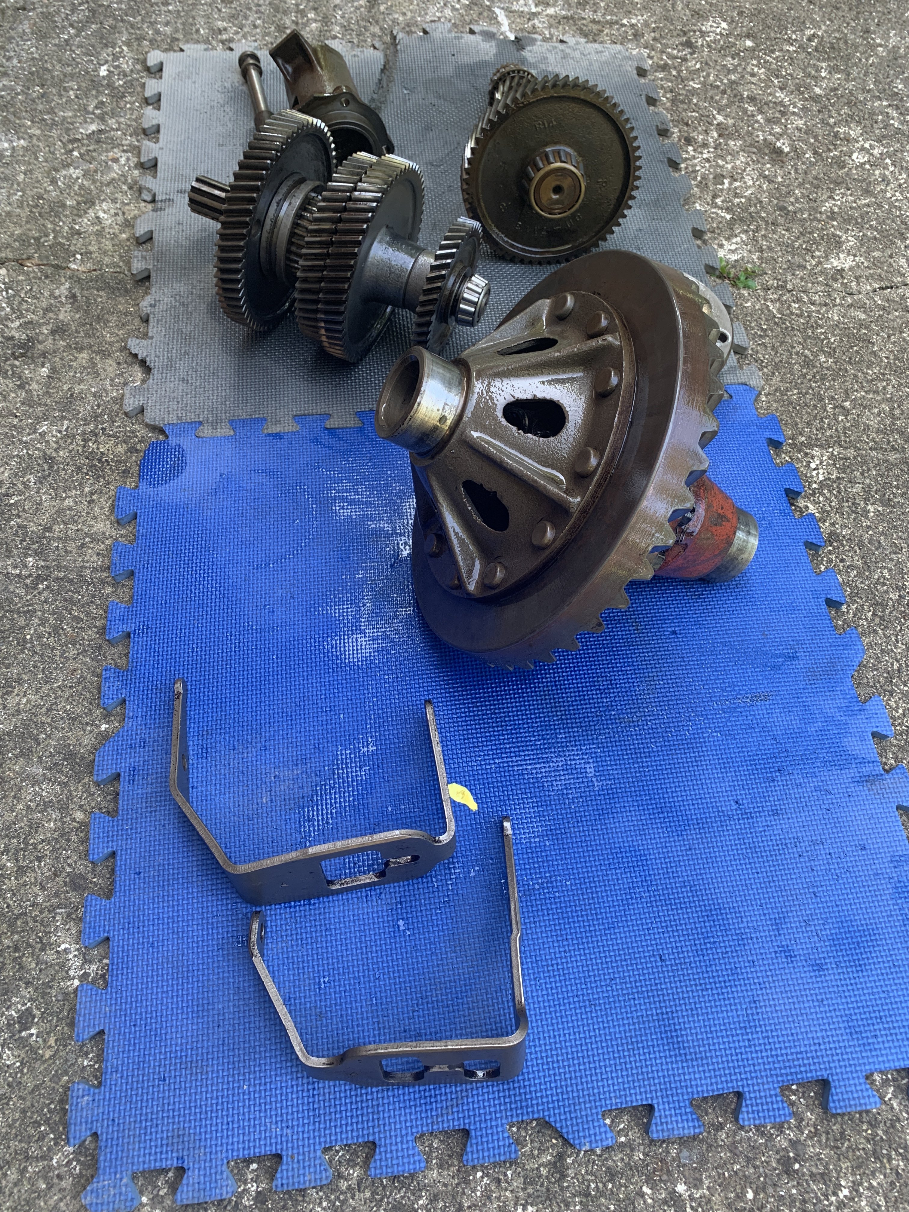

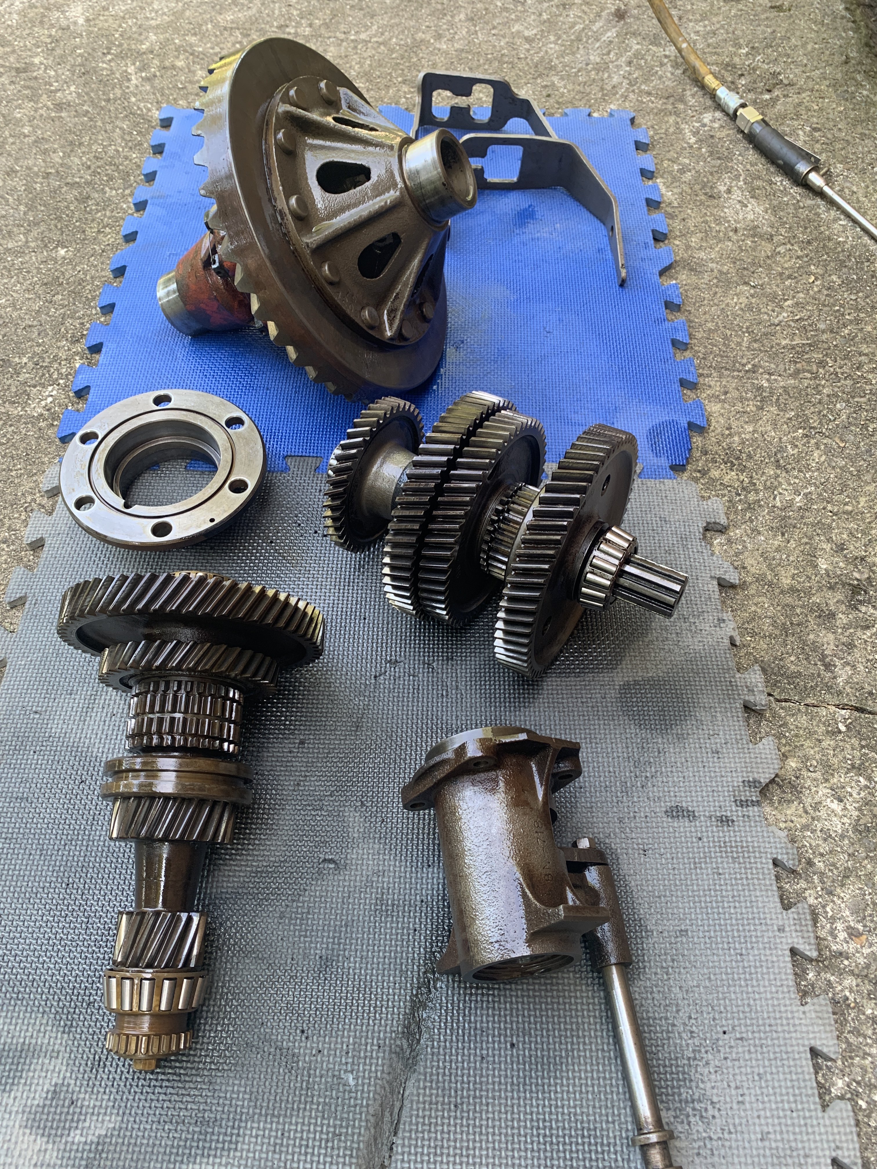

Got the trans gears and rear diff cleaned up today.

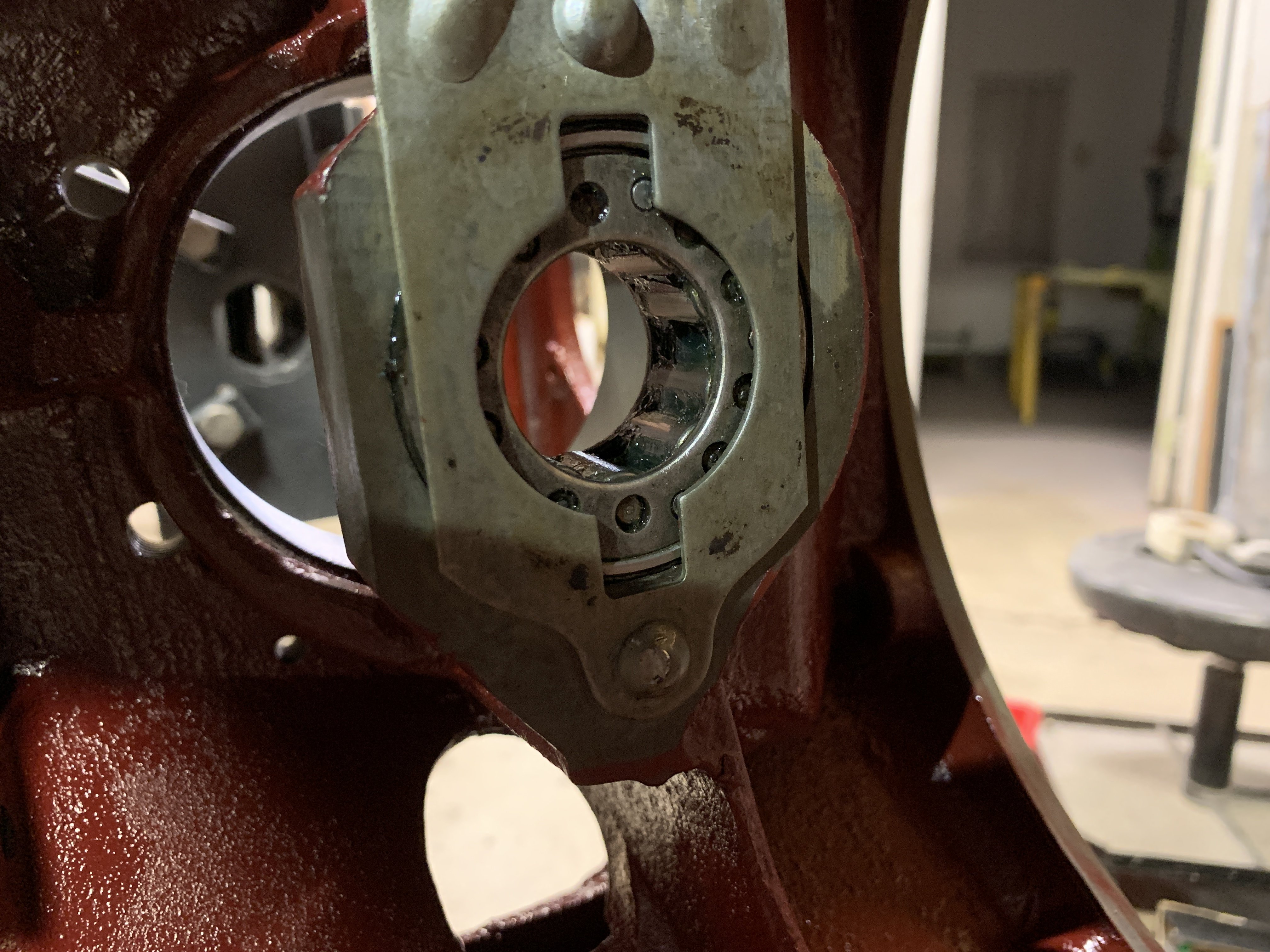

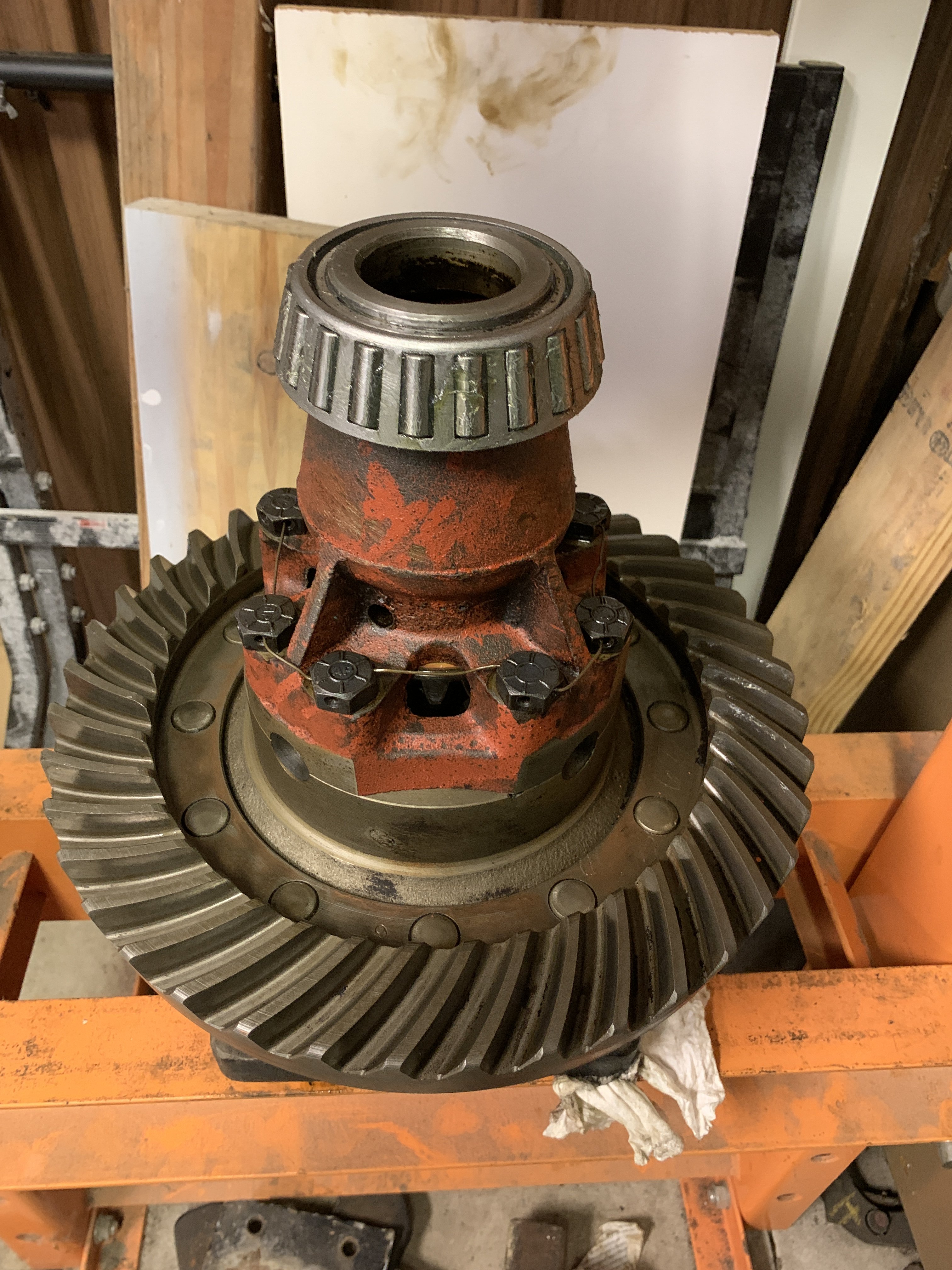

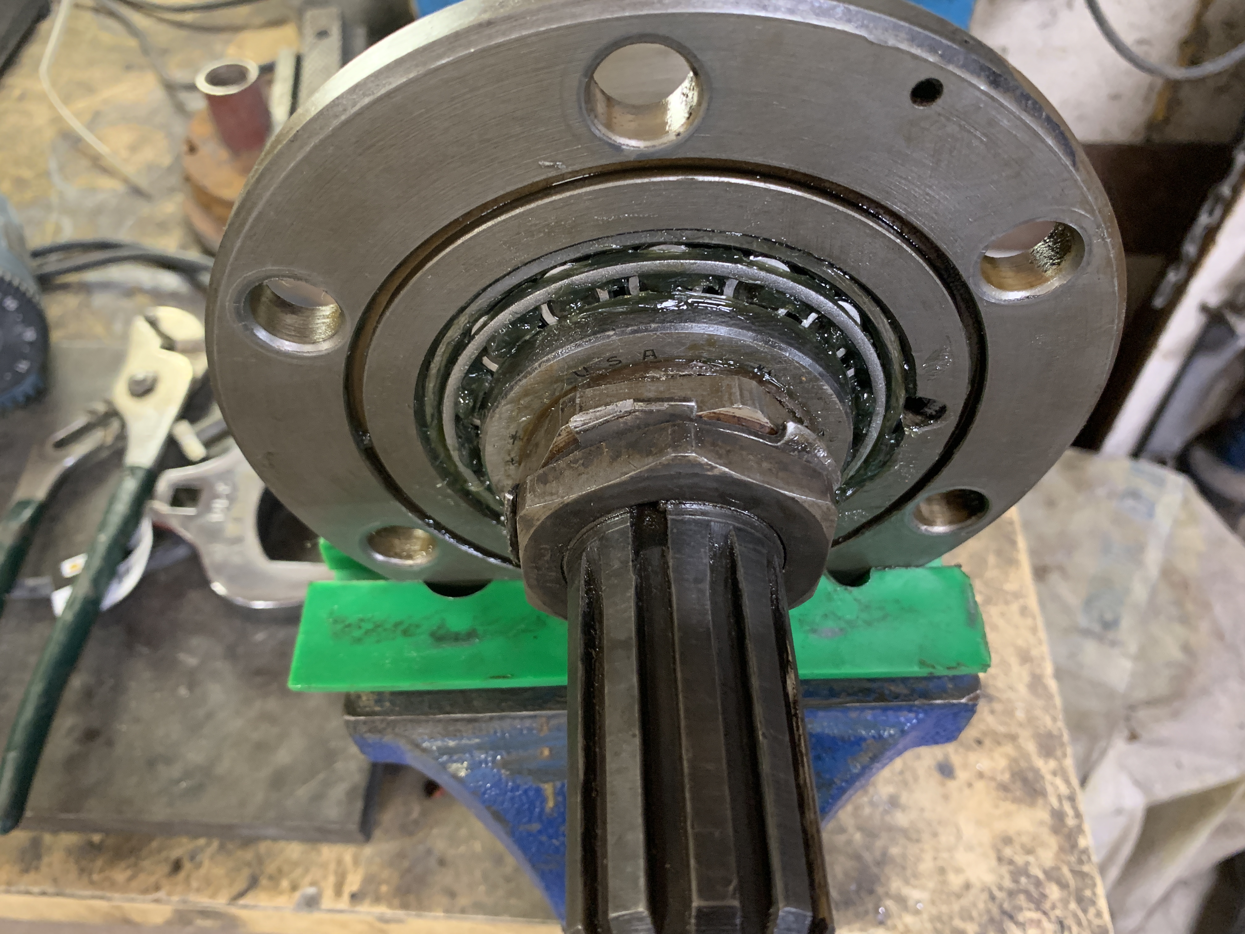

Got the pinion back together with new bearings and races. Set it right around 14in-lbs while turning.

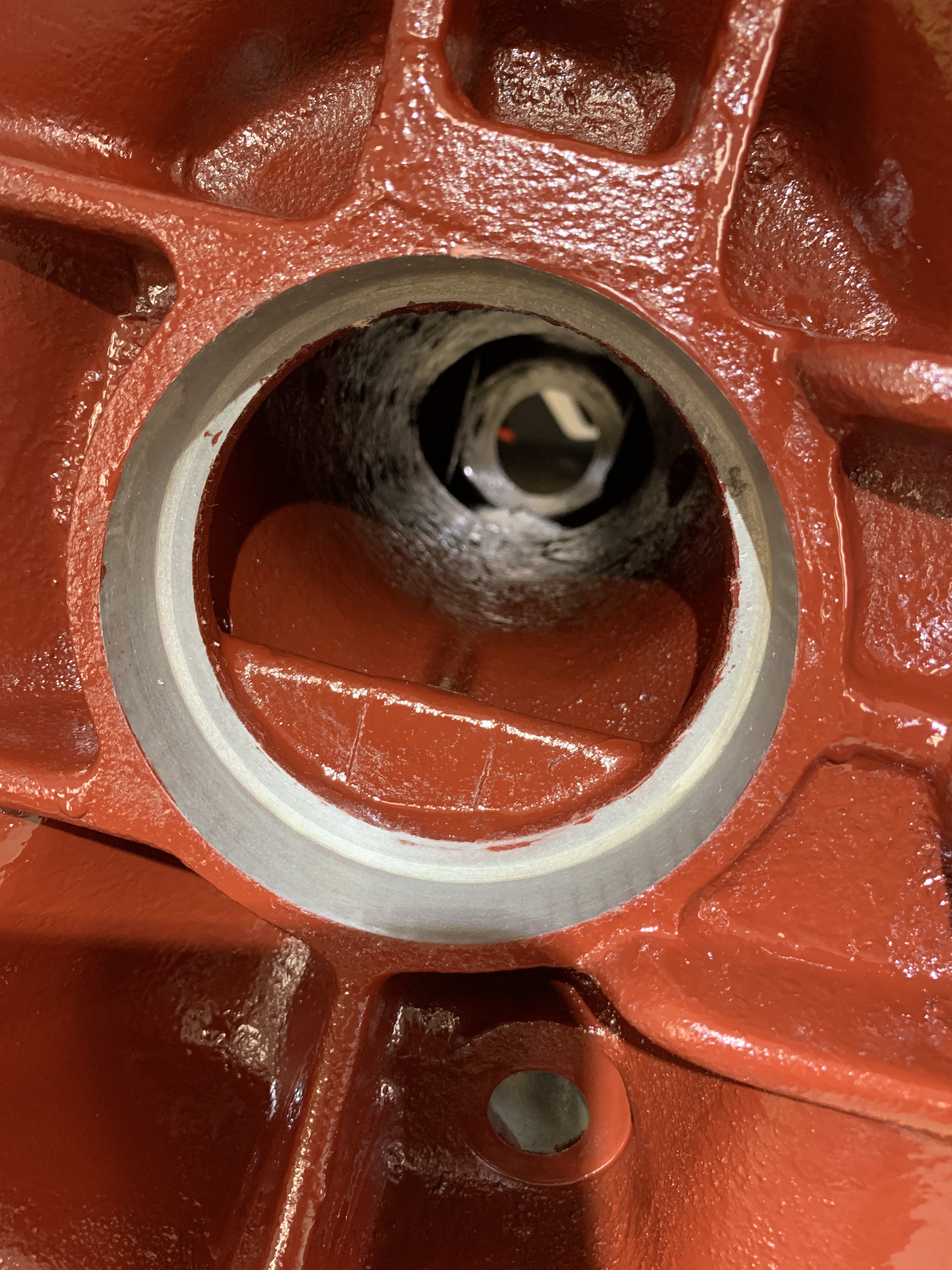

New races in the axle housings, bearings on the diff, and the new pilot bearing in the diff case.

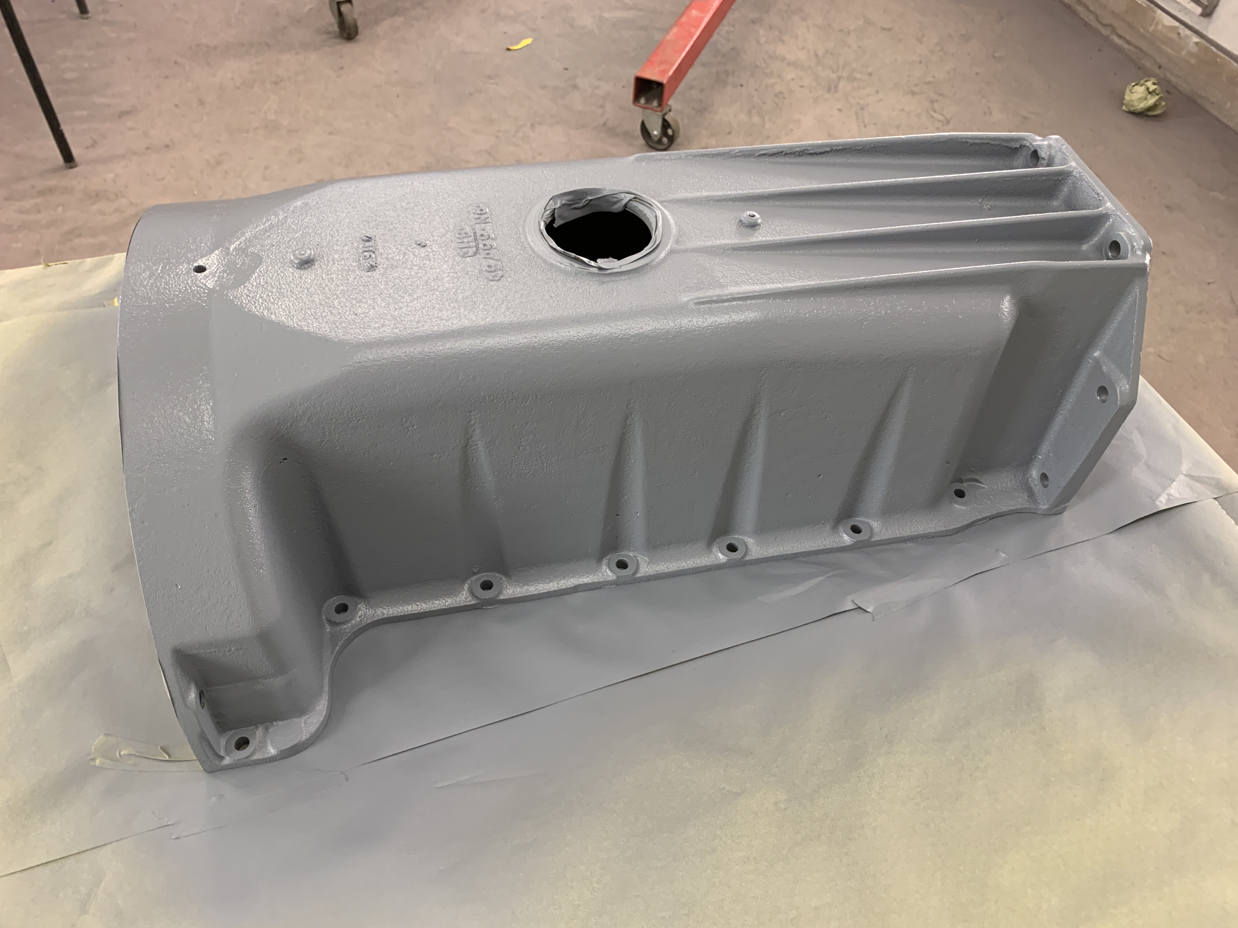

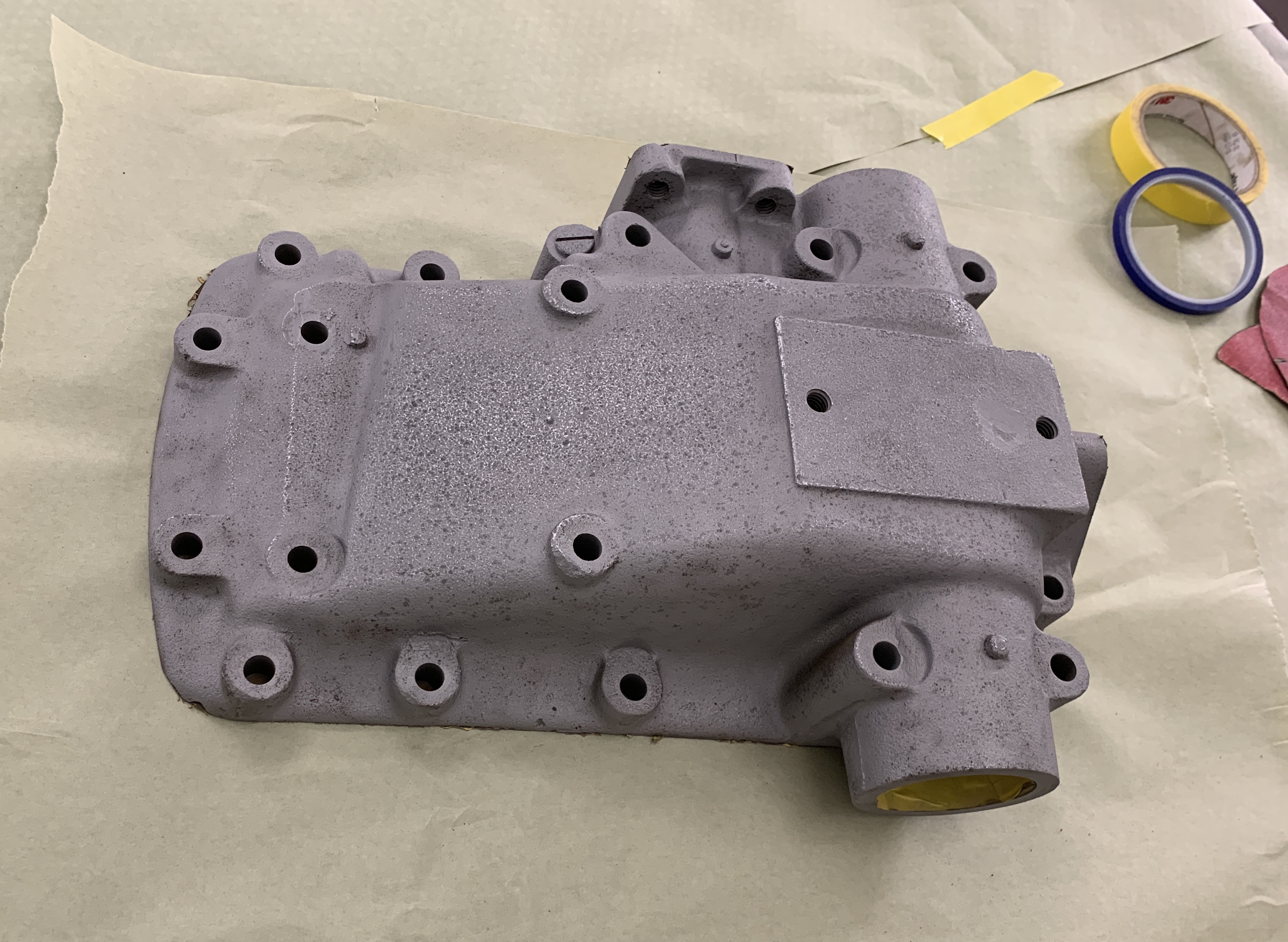

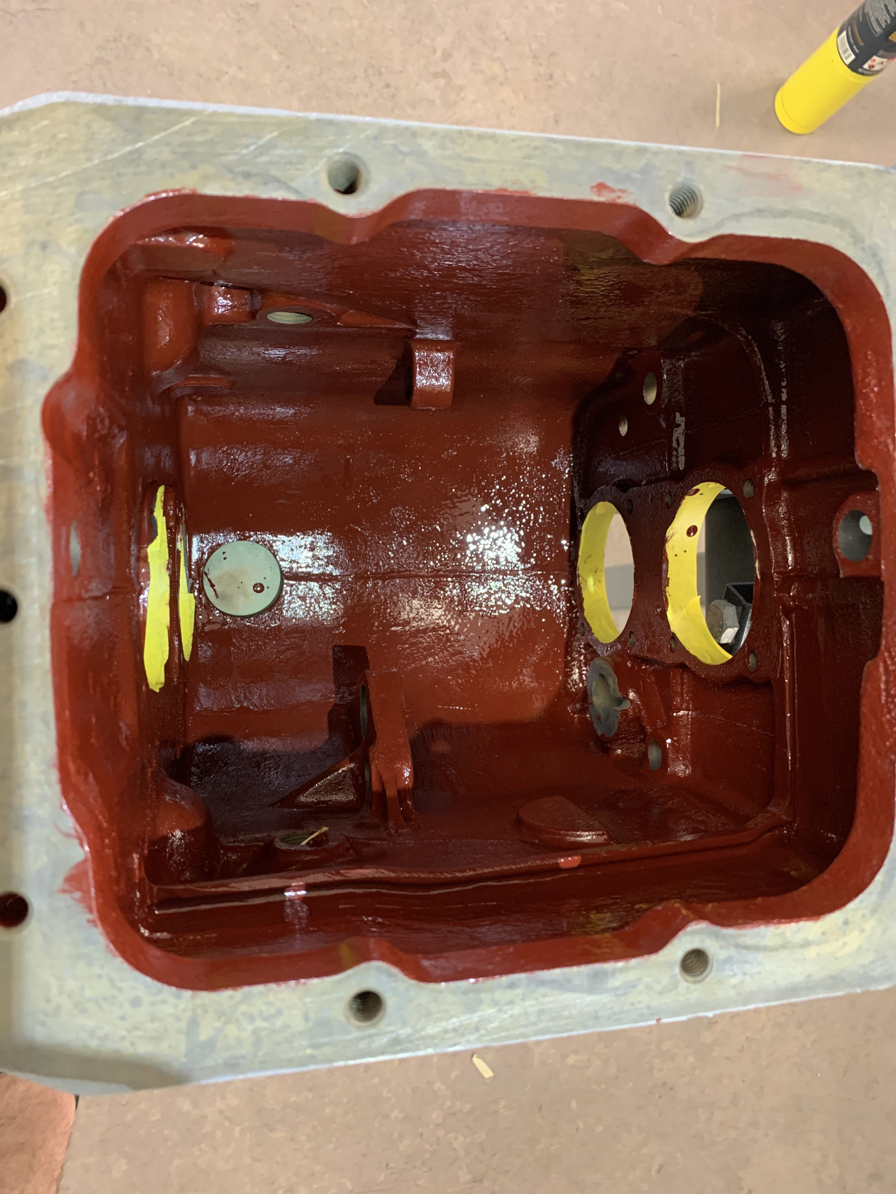

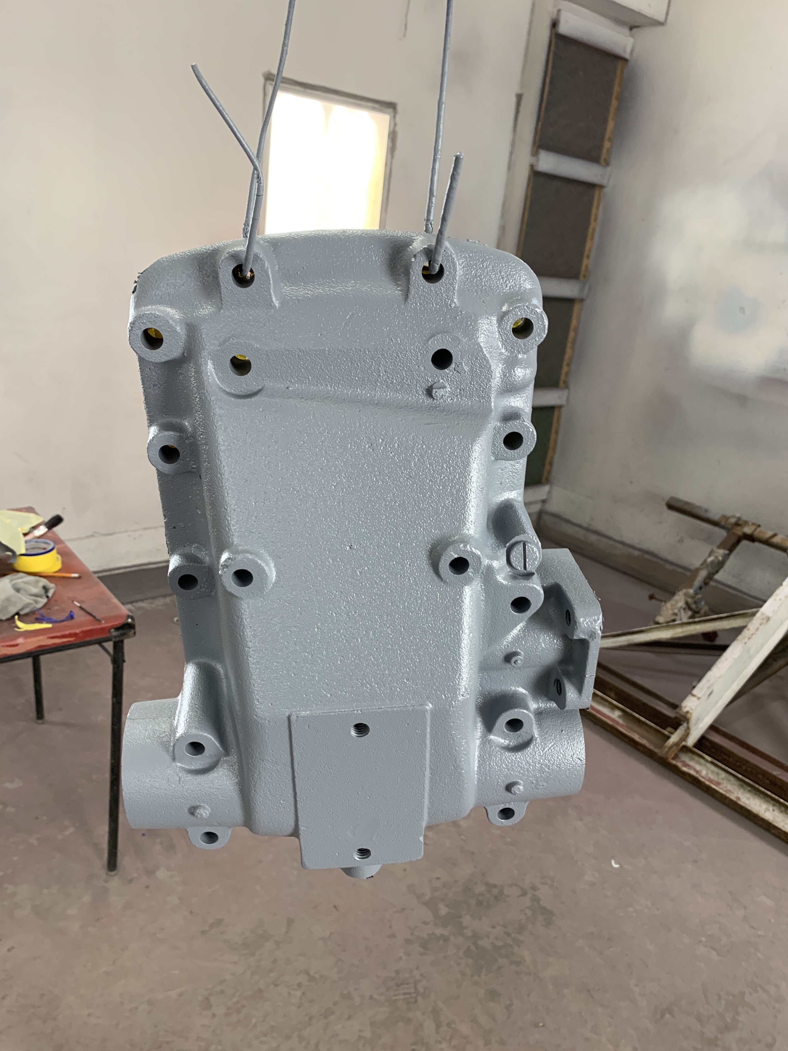

Top cover sandblasted and primed it along with the oil pan. May paint the glyptal tomorrow on the inside. Going to start sandblasting more parts now.

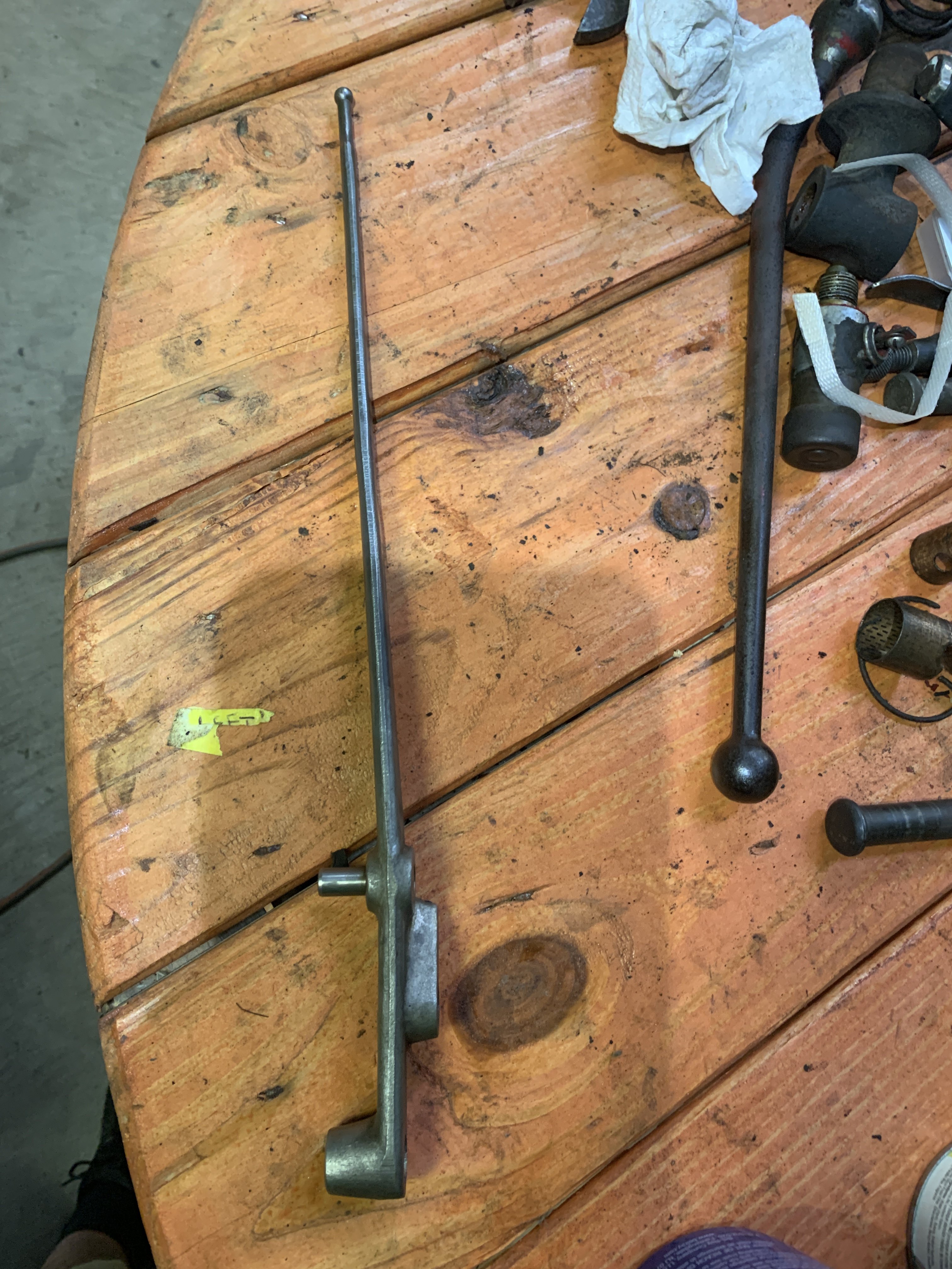

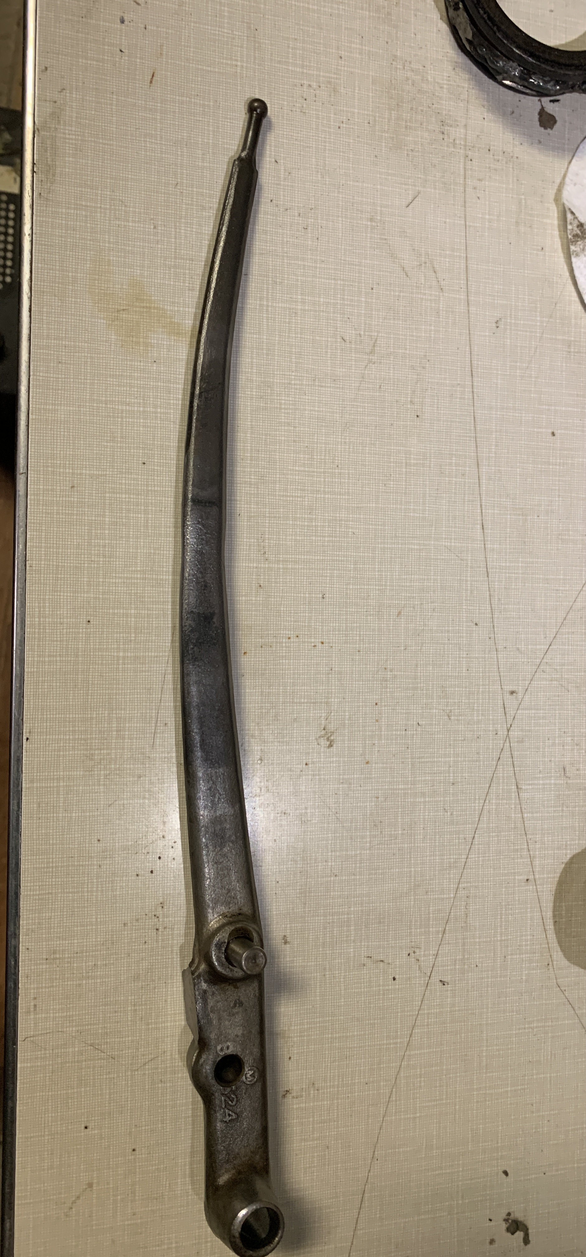

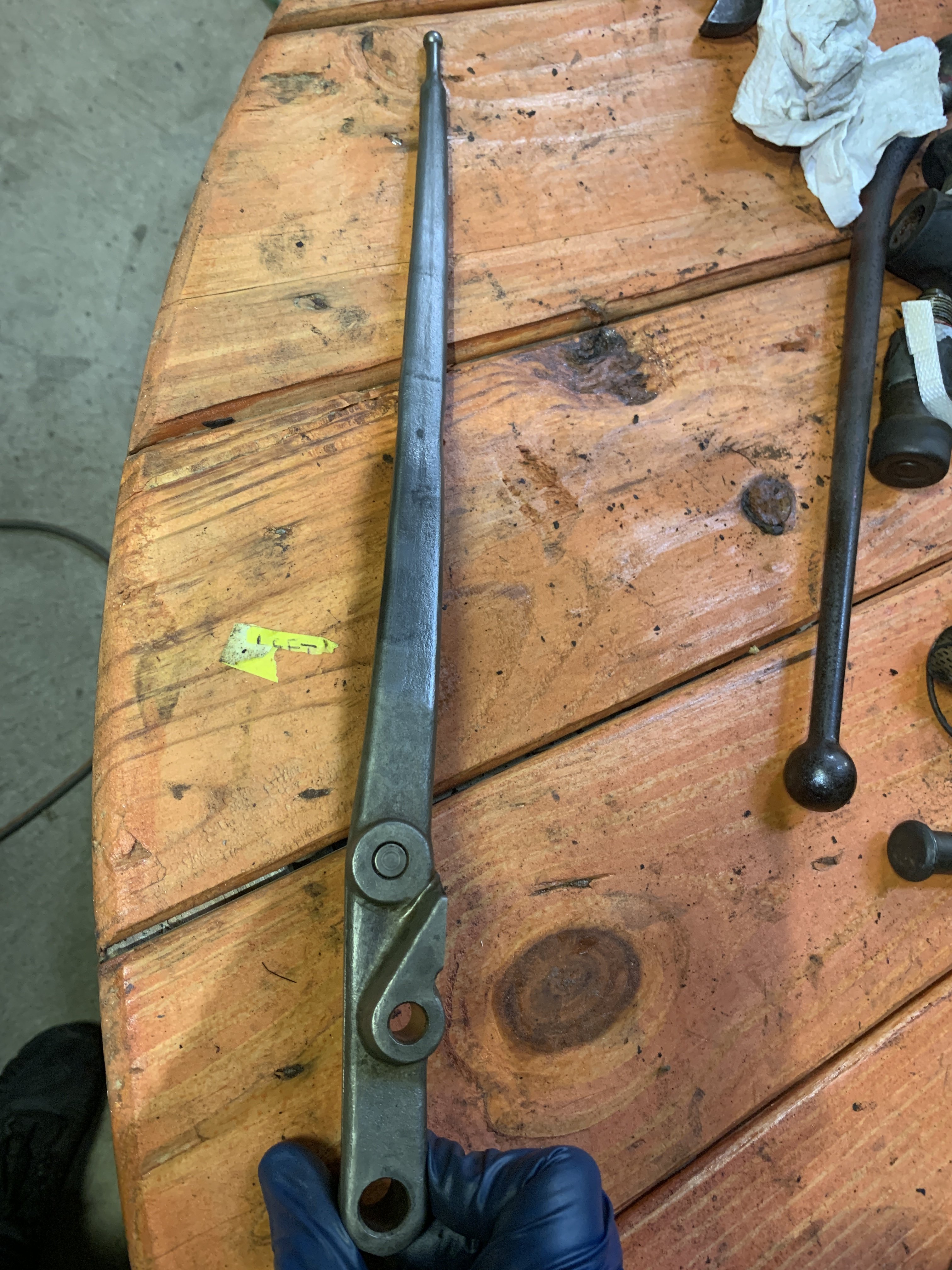

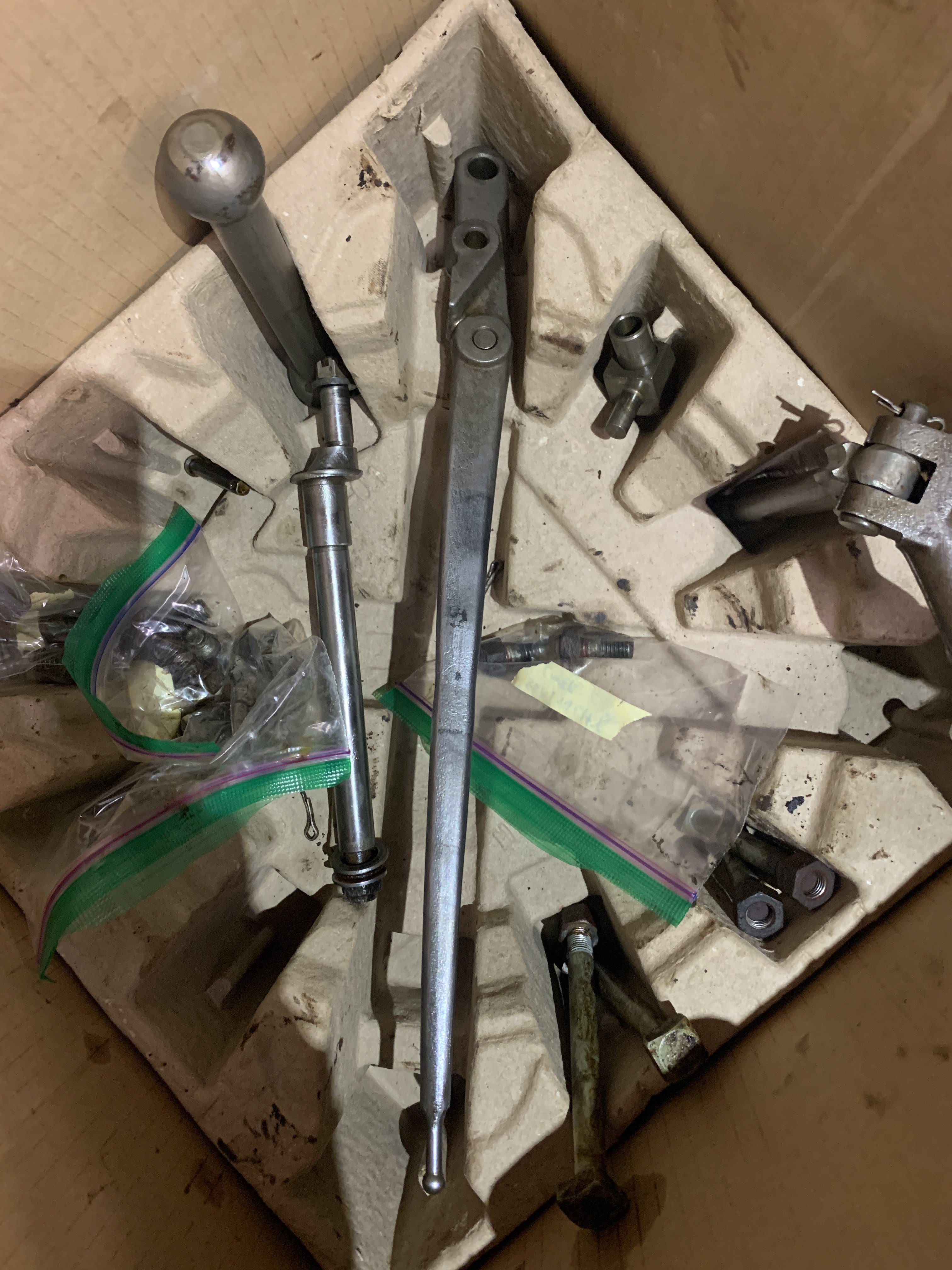

I cleaned up some more parts today and straitened the hydraulic control rod some. Does this look good enough? Im not sure exactly how it should look as mine was bent pretty bad.
