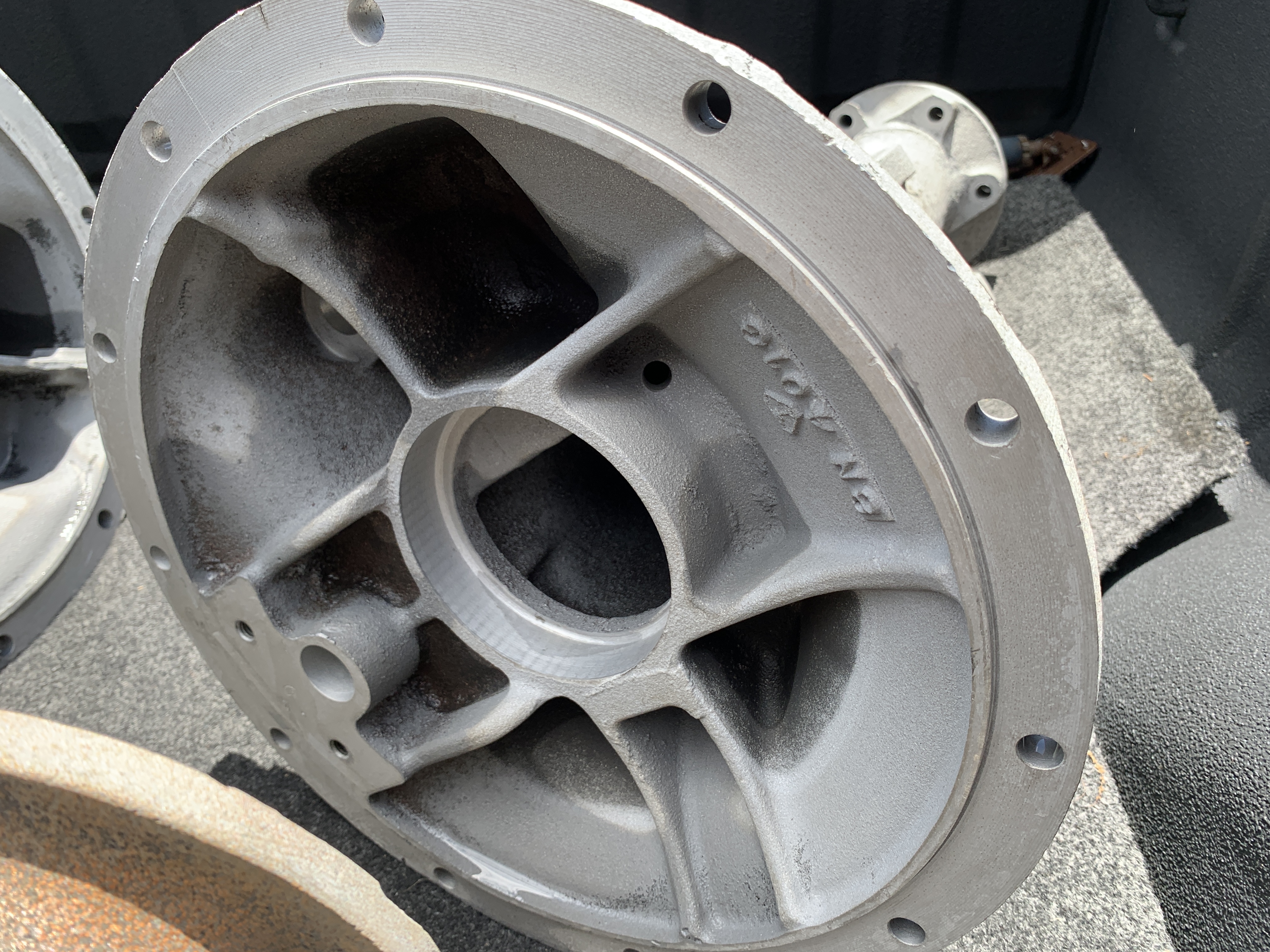

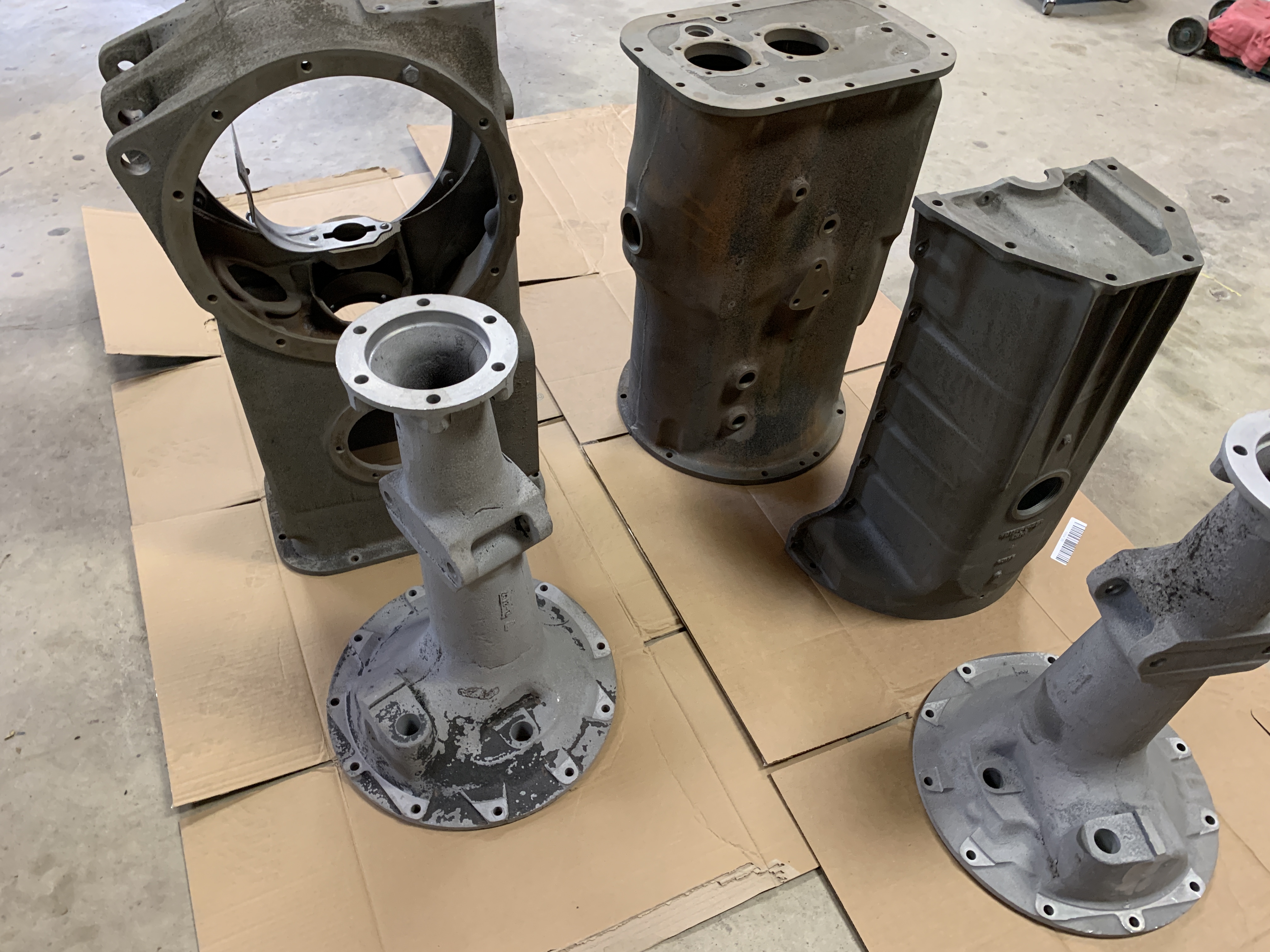

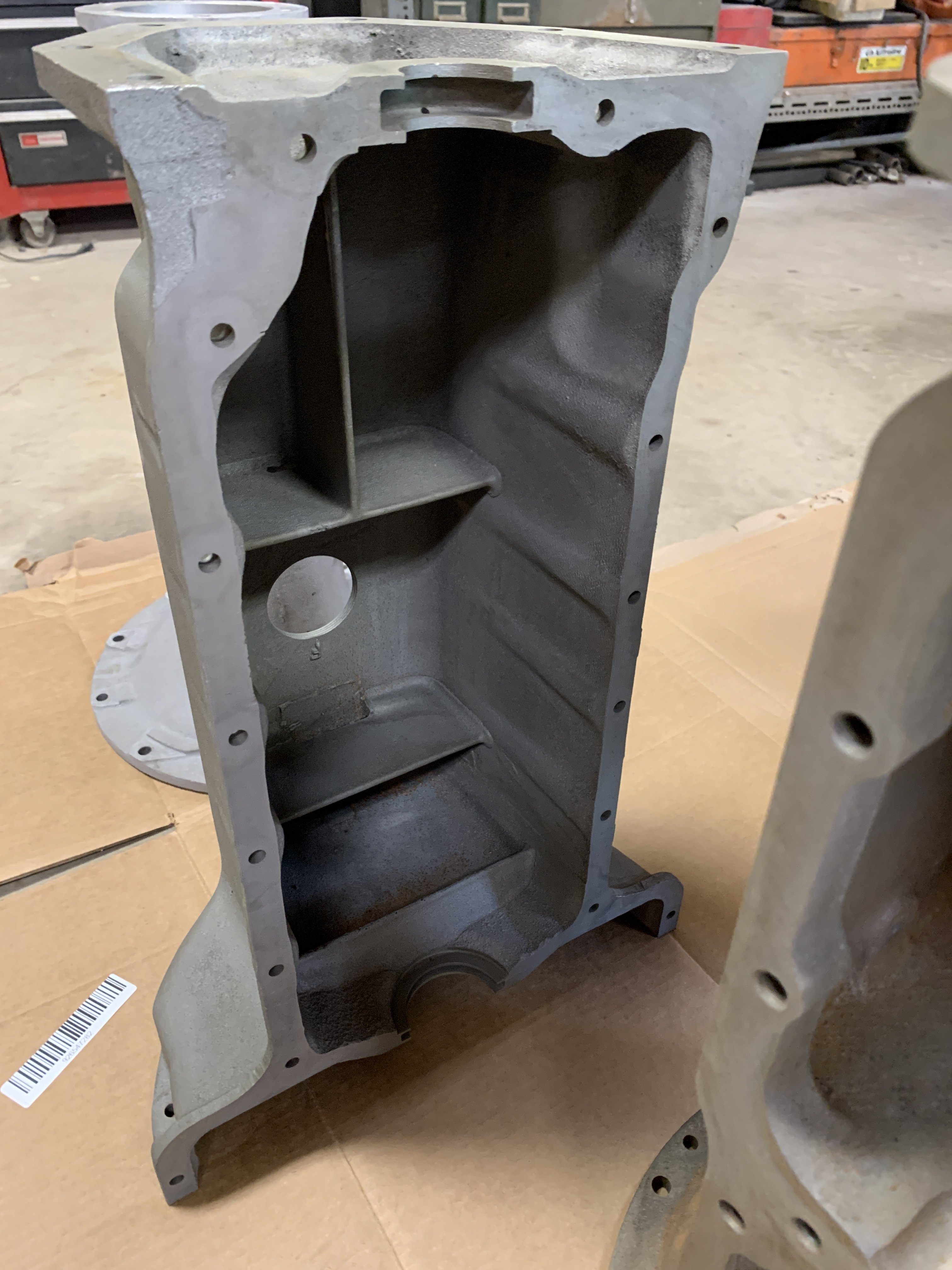

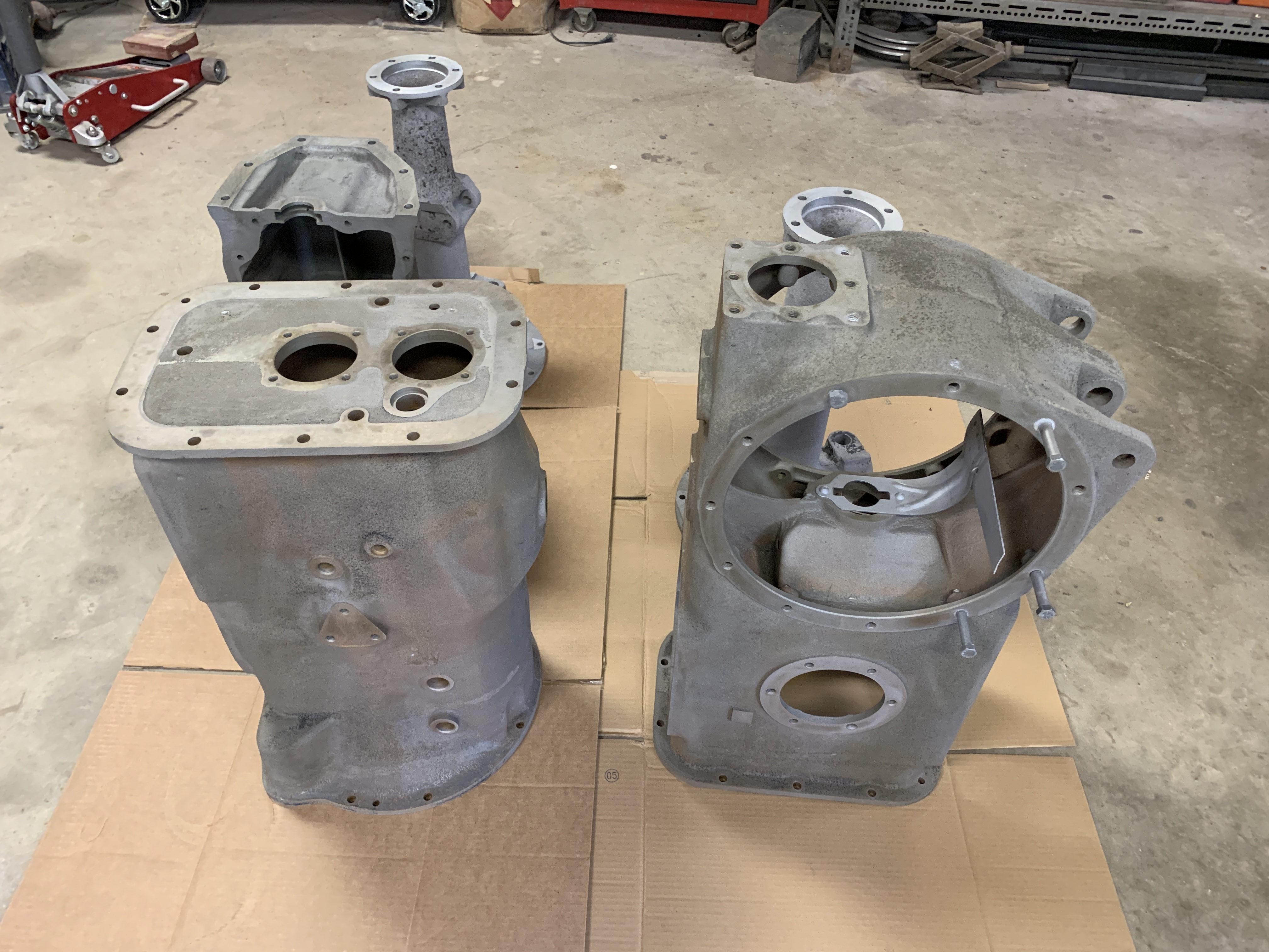

Parts came out pretty clean. Little bit of flash rust and lots of pits and imperfections in the cast iron. Going to coat them with some body filler most likely and sand that out. Getting a coat of epoxy primer first though and coating the inside with the glyptal. Will probably use some high build primer as well on the outside. She will be slick when finished.

I am going to prime and do some of the body work to get them smooth before assembly. Still deciding on when I want to paint the red but the plan at this point is to assemble the main structure minus the engine and the hydraulics when painting the red. I dont want too much assembled because it would be a pain to get the paint even and in all the little hard to reach areas. I know some guys paint them with it all together and thats fine but not the way I want to do it. The only thing is if you paint them apart is do you keep your bolts bare and have them cadmium plated or try to touch them up once everything is together. I had seen a tractor with all cadmium painted bolts and it looked pretty good.
The main castings you see in the previous photos I took to a metal cleaning shop to have them chemically stripped. They use an alkaline based solution. Sand blasting is a good option as well and if I was doing that I would mask the gasket surfaces and try to avoid them. The gasket would probably be hard to remove from a blasted surface in the future.
I have a large sand blaster but its just a pain to put all the plastic down and have to clean up after it. I thought the chemical stripping would be better to get the inside clean as well. I think if I go this far with another tractor I will probably make my own hot tank with a 55 gallon drum and use a lye/water mixture to strip the cast parts myself. This way I save time and money and dont have to worry about someone else dropping the parts and damaging them. I just have to be careful with the toxic solution but I can do 1 part at a time and minimize the flash rust before priming.
