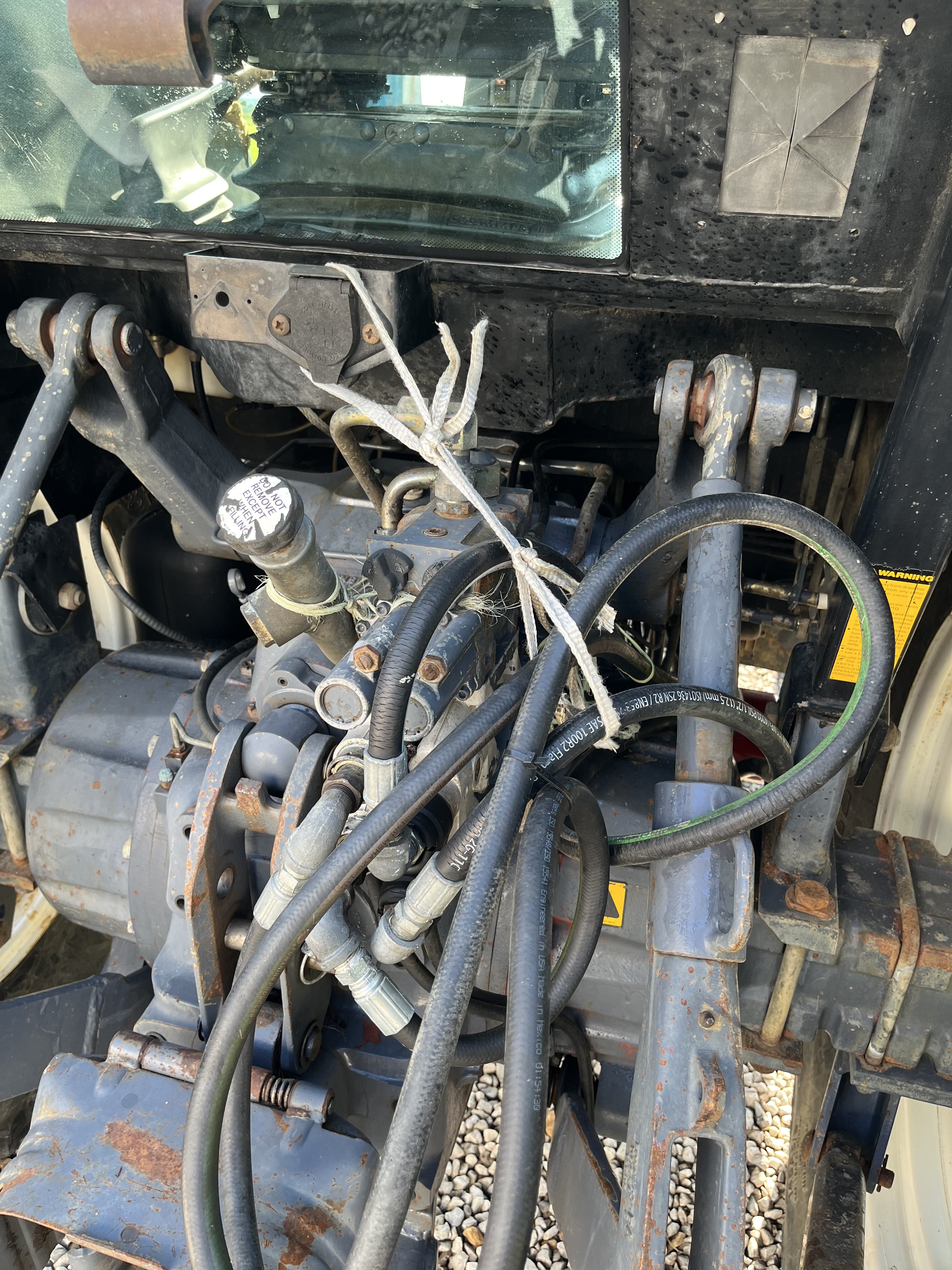

I have a new to me 5640SE with a front end loader, currently plumbed into the rear remotes. Does anyone have any info on how to plumb it in with a control valve and joystick to free up the rear remotes?
Post a picture of the rear remote valve to be sure, but Fairly certain that's a closed center load sense system, so you will need a CCLS valve, then tap into the pressure to the remotes, shuttle Tee in the load sense line, and return to tank.
This is how many chose to tap into the pressure side. There is a return fitting in the oil fill tube if you wish. The load sense line is the small line going into the remote valve, it will get the special shuttle tee.

Here is a picture of the current setup
Would something like a Akon lvm92 work? Or is there a more cost effective alternative?
CCLS valve. The best way to tap in and utilize both pumps is tapping into the pressure, load sense, and return line.
If you go that route make sure to use a closed center load sensing valve. Not cheap but worth it IMO.
Not a 40 series. But a very similar setup on a 30 series.
Tee in the pressure line at the tip of my finger in the first picture.
Return oil into the fill tube.
Shuttle check tee in the load sense line.
And the CCLS valve mounted up under the battery/cab with cables for joystick running inside.

How can I determine if the system is CCLS or open center? The manual shows the CCLS system to have an arrangement of 3 filters on the right hand side of trans., and only shows a single filter for the open center fixed displacement system. Mine only has the single filter on the right hand side, but also has a small 1/4” line running from the left hand side of the hydraulic blocks back to the rear remotes
Is the steel 1/4” line the load sense line? It looks like you have a tee in it, and then a second tee with two hoses coming from that in the picture you posted above. Is that correct? Is so where is the second hose going?
Correct there are two shuttle check Tees back to back. On the first shuttle Tee one hose goes to the priority valve on the tractor (original load sense line to the remote valve), 2nd hose goes to the loader valve, then it feeds the 2nd Tee. 2nd shuttle tee feeds two separate remote valves.
The New Holland number for a shuttle Tee with JIC fittings is 83954424 and is spendy. The NH part number for one with ORFS fittings is 81862791 and is much more affordable.
