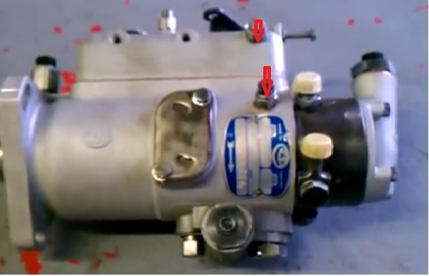

Look at the photo below of a CAV/DPA injection pump, does you 574 have an injection pump like the one below?
Early production 574s had the CAV/DPA injection pumps with a lift pump on the right side, later production models had the Bosch injection pump without the lift pump. Also some pump shops had a conversion kit to convert back to the CAV/DPA when the Bosch pumps broke and parts could not be found to fix them.
Please report back on make of injection pump as the bleeding procedures are different.

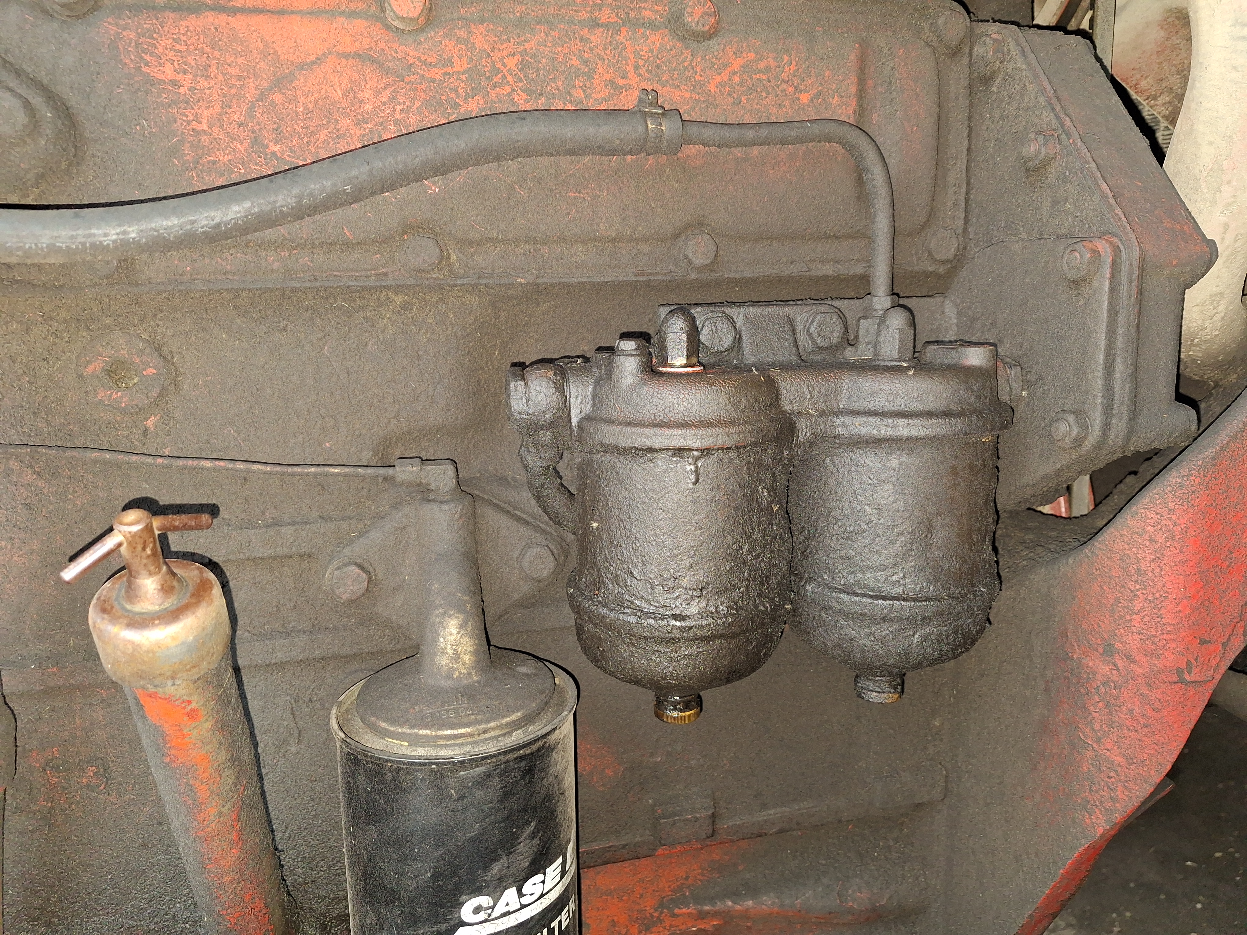

You'll have to excuse the nastyness as this one has been in the field, but there is a seal, oring, or washer at every connection point on these filter systems that utilize the glass bowl on the bottom. It is usually a good idea to replace all of them when a filter change is done. The last several filters that I have received from my CNH dealer, the oring that goes between the filter and the glass bowl has been a bad fit, and can leak. These tractors did not come with a mechanical fuel pump. The fuel supply is gravity fed. To be sure you have a good flow, remove the upper metal line that supplies the fuel to the filter base and blow back into the tank with an air hose to ensure there is not an obstruction partially covering the exit port in the tank. Another rare possibility could be that the line where it leaves the filter housing to supply the injection pump could be collapsing internally as it is a braided rubber hose. I'd replace the fuel tank shutoff petcocks if they are leaking. Hope this helps.

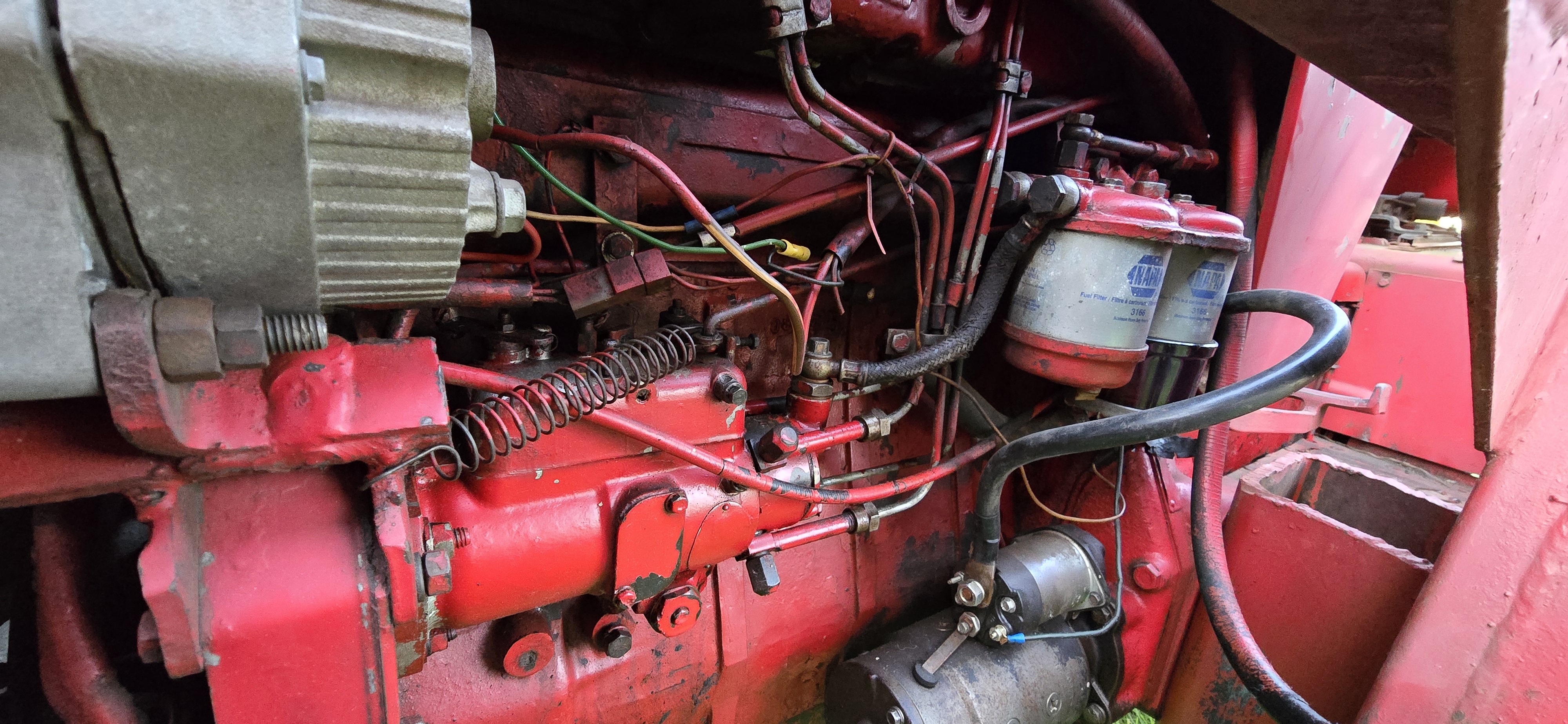

The right aide above the oil filter, there was a mechanical lift pump. It was bypassed and now there is an electric pump, top left.
Injection pump looks like the cav/dpa. Dual filter assembly and injection pump on the same side.
I posted pics of the right side of the engine, showing the lift pump. I will disconnect the electric one and blow back to the tank and then put a section of clear hose there to see if there is a leak upstream and get back.

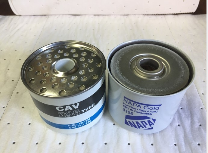

Yes, definitely a CAV/DPA injection pump another quick check, see the photo below of fuel filters, note the NAPA Gold on the right that it has a sold top with the opening around the outside. In some applications the upper sealing O-ring can become displaced a slip into the opening around the outside restricting fuel flow.

Do you know how to bleed a CAV/DPA injection pump?

Just watched a video on bleeding these pumps here
The top bleep screw never once let diesel out no matter how long I let the pump run or cranked the engine. Started to feel crazy cause i hadn't seen anything confirming it was actually a bleeding screw til now. Like I said though, it did run for about an hour after the initial bleed

I have seen that issue with the filter, and I was very careful assembling them to ensure the right o ring was in the right place. One is slightly larger and goes on top. No leaks, not rolled over, seems to be installed fine. Will replace entire assy with an aftermarket one soon regardless and go from there.
Found a video here on bleeding,
The upper bleed screw never let out any fuel. Bottom one shoots it out like a hydraulic leak when it's cracked open haha. I did not check to see if the upper hole was letting fuel after it started running though. I'll try rebleeding before any disassembly.
