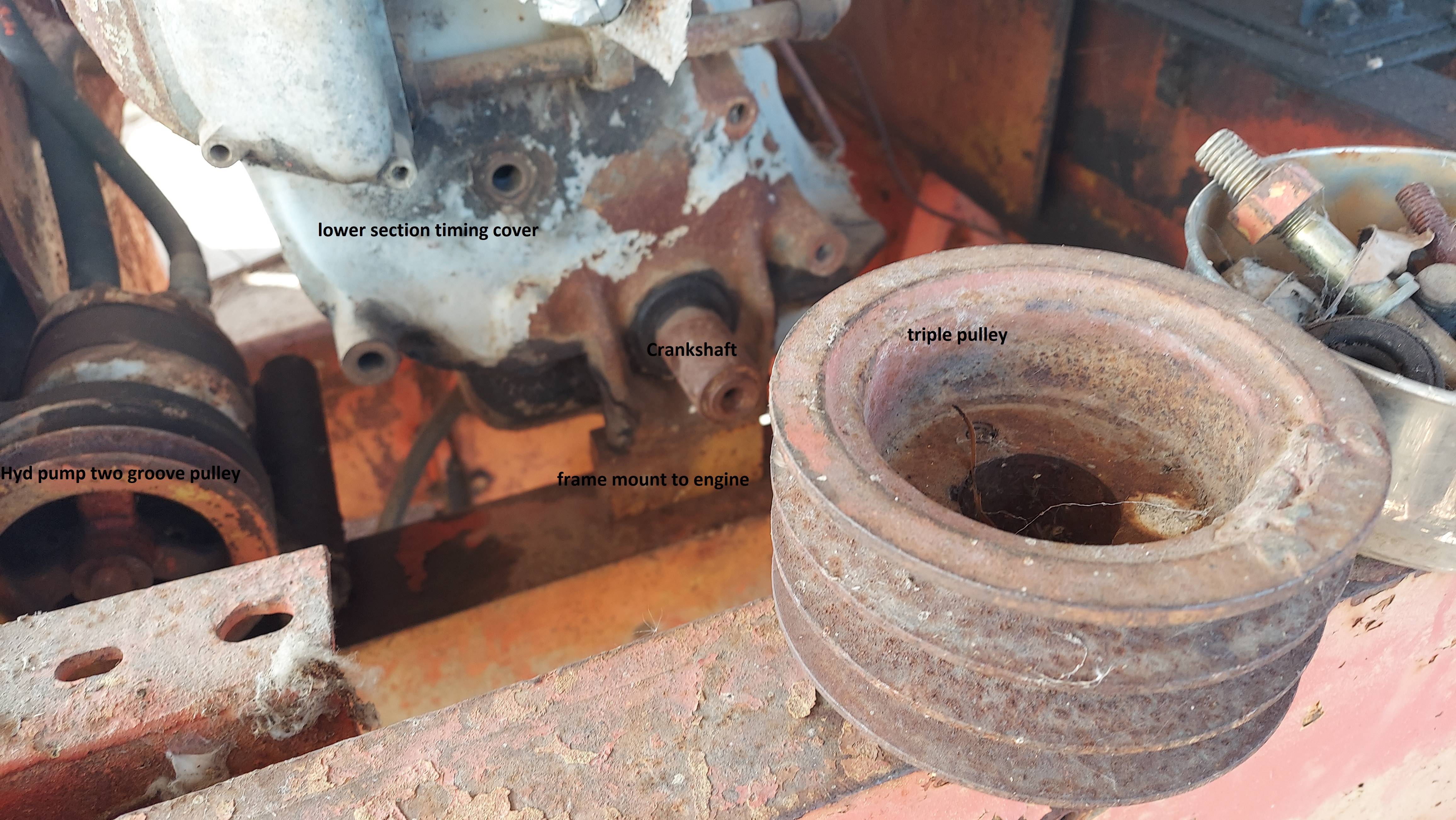

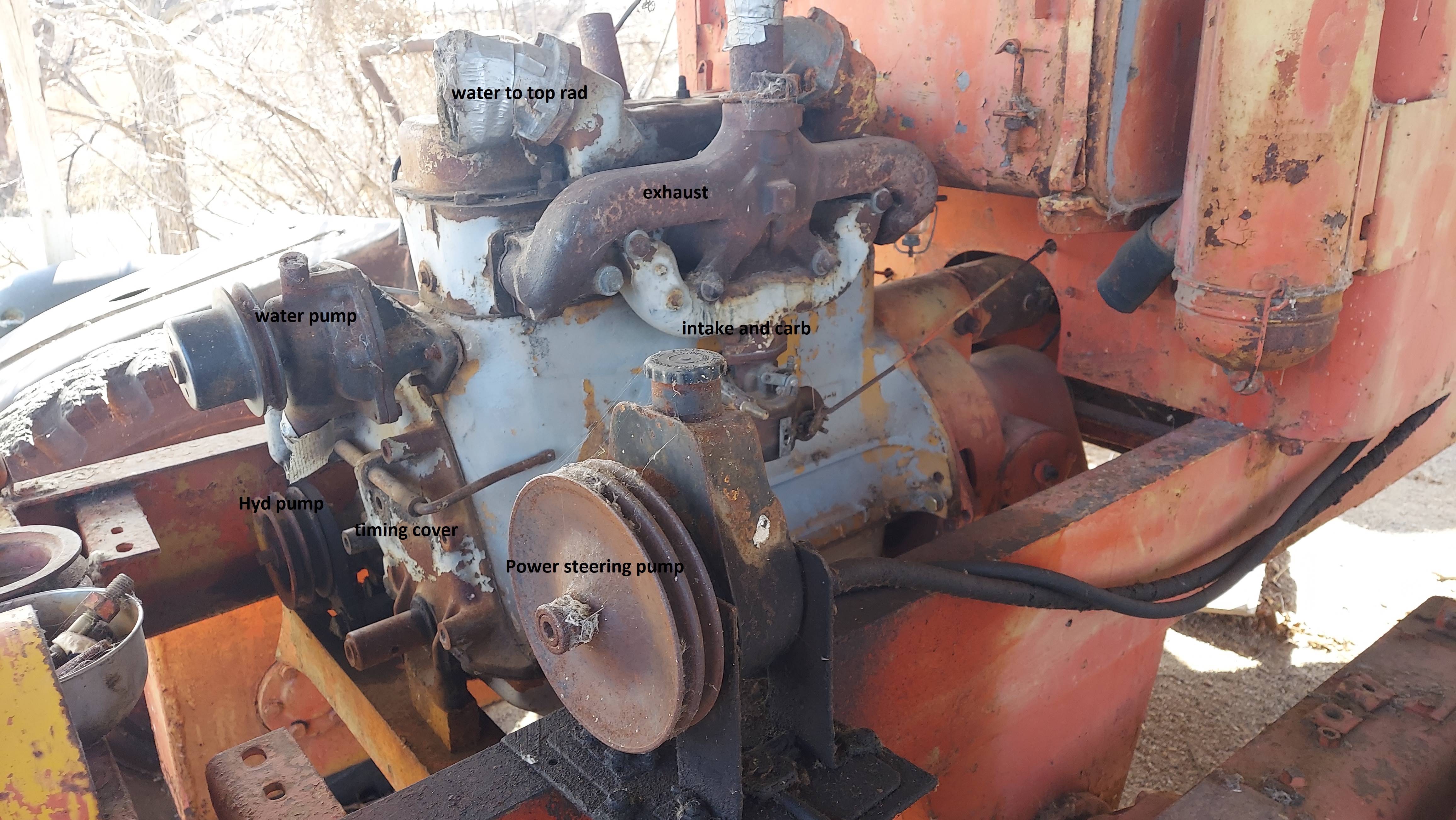

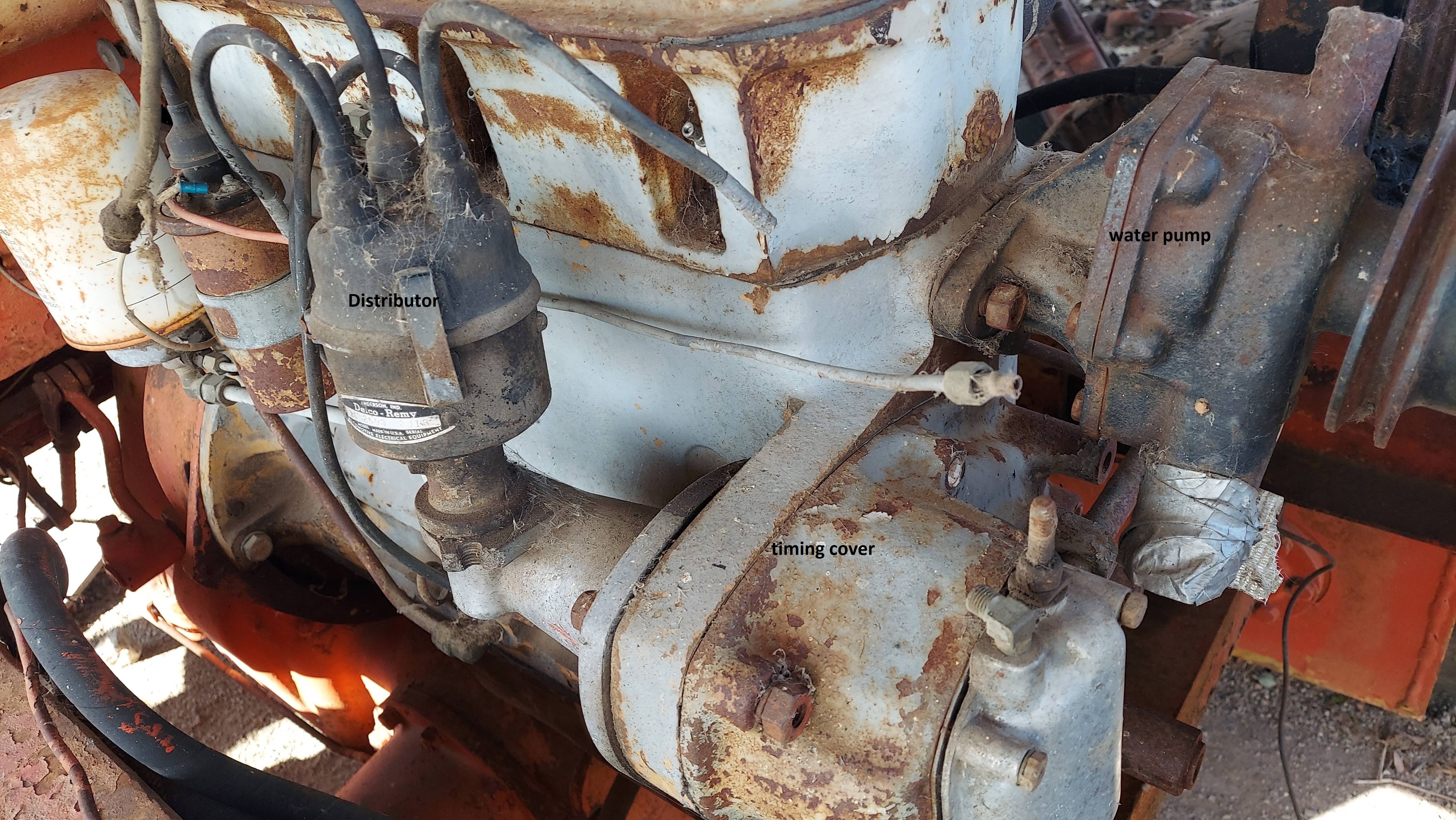

Whew, time gets away from me. I'm making good but slow progress on both graders. I'll refer to them as the 'big' one and the 'small' one. On the big one, I'm just finishing up getting the engine from the Gleaner E put together. I've had to make some upgrades and modifications to the engine for it to fit. In another thread here, I've noted the install of a WD-45 clutch, flywheel and pressure plate. I've had some issues with the timing end too, and had to change the water pump as the belt didn't align. I'm also using a triple belt pulley to drive everything, and fitting it is getting a bit tough.
I'll be putting the completely assembled engine in next week, and as long as it all lines up, and cranks I'm hoping to start the engine soon. I'm concerned about the fuel tank been sitting for so long. I should take it off and clean it, and see if I can re-seal the inside with some of the tank goo.

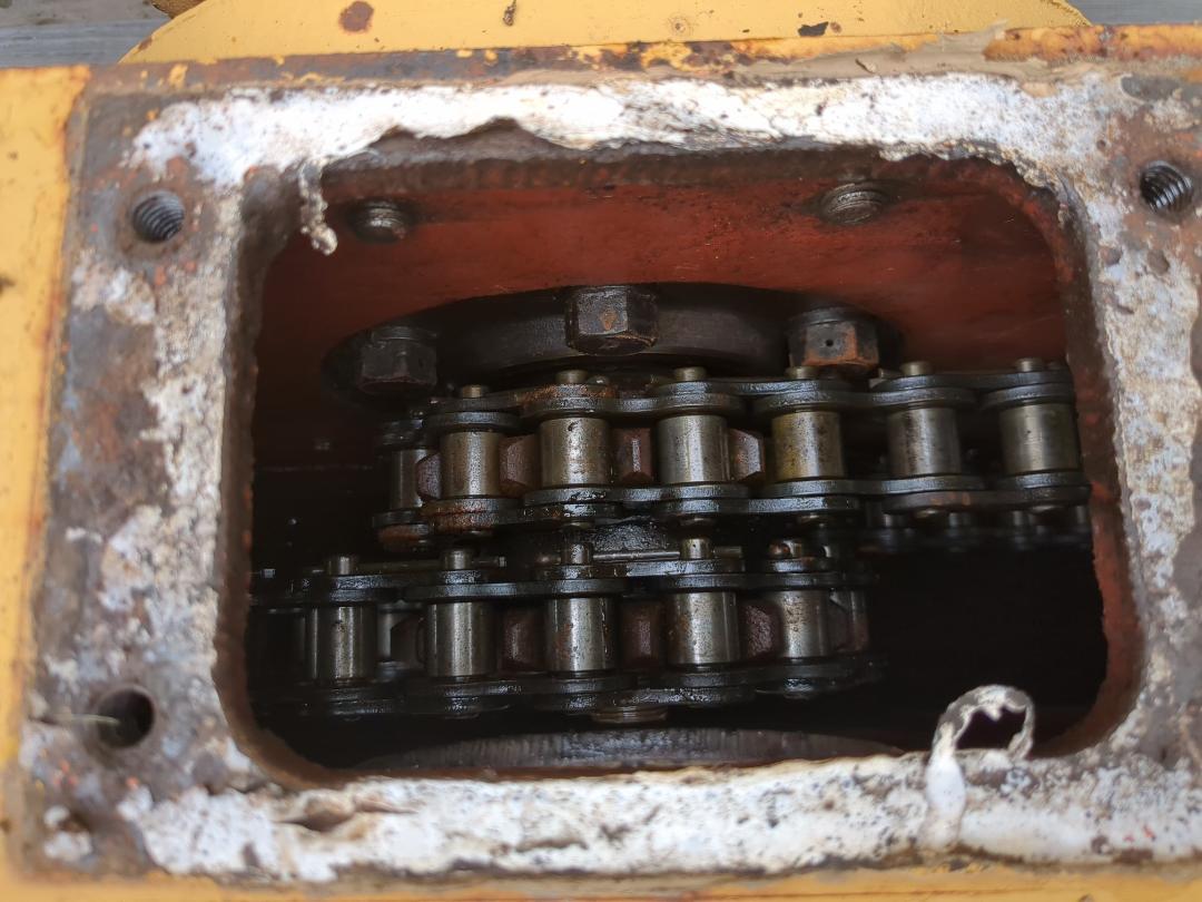

The small grader has four new tires on back. It's got a WD engine, but it's locked up. I've started on cleaning out the chain boxes, and will be developing a tension system for the original chains found. They have a lot of slack and I don't want them jumping. Three bolts on the left chain box to pivot hub have snapped off, which could be from chain jumping. The small grader is in slightly better shape overall. It has the hyd for a scarifier but the frame and teeth are gone. Hoping I can unstick the engine without disassembly. I figure maybe a 20 percent chance I don't have to pull it apart.
"will be developing a tension system for the original chains"
Remember, this is a "dual direction" chain drive, it's not just a matter of putting a tensioner on the slack side of the chain, if the operator dumps the clutch in reverse the slack side of the chain suddenly becomes the load side and unless your tensioner is VERY HD the loaded chain will simply push it out of the way.
IMHO, you are overthinking/worrying too much about the chains "jumping". Unless the chains are so worn they need to be replaced the original setup will be FINE.

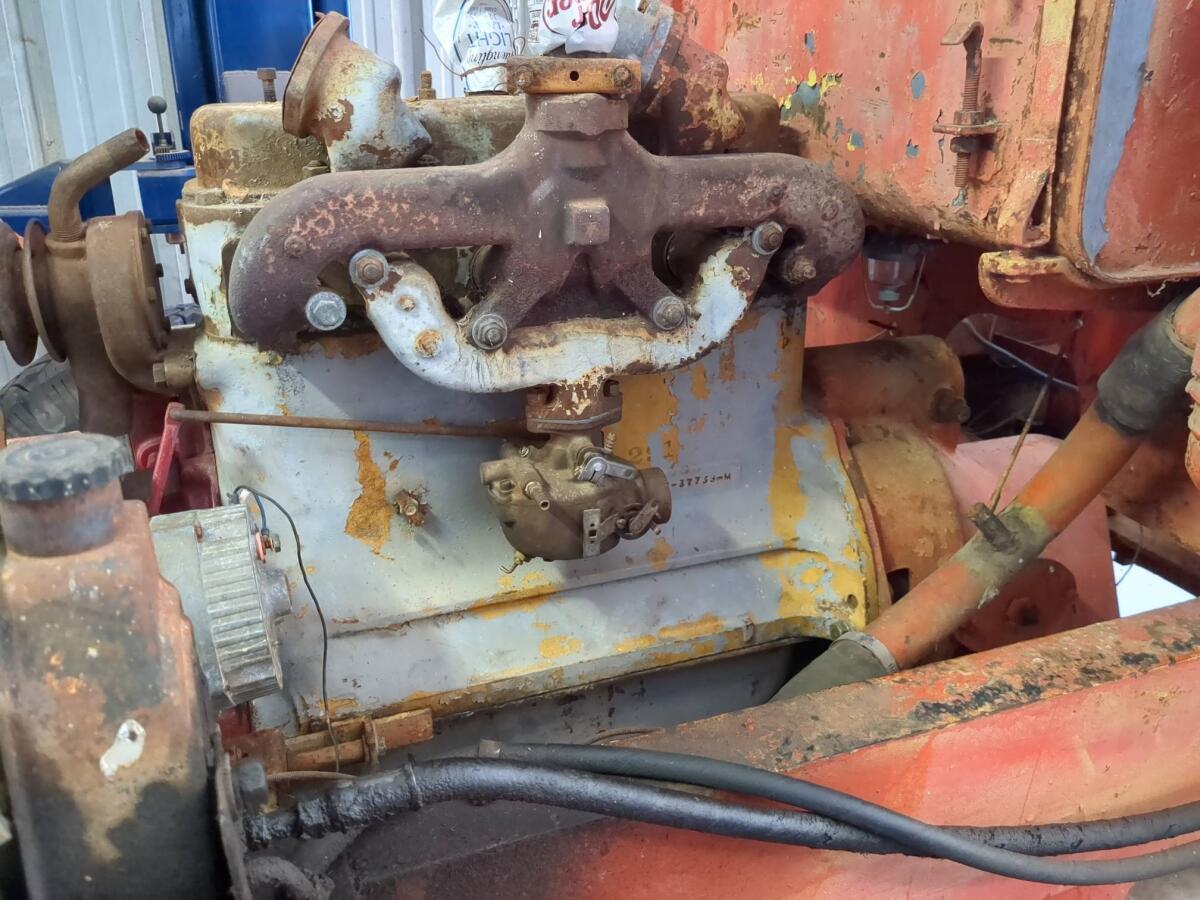

Fairly big day in the grader refurb process. I got the engine in today. It has most of the acc on it, and the right flywheel this time. Stabbed it in by myself, and learned a cool lesson. I put one of those belt type oil wrench tools on the back pulley so I could walk the crankshaft a bit when going in. Got it lined up right, and waiting on the splines to line up, just rocked the oil filter wrench a bit, and click, it lined up perfect. Tighten down the four bolts, and put the two rear bottom bolts in, it took less than 20 min.
The manifolds are on, the rebuilt carb is on, the alt is on, front gearcase, water pump, and the small oil lines all in place. New filter is on. I need to block off the Gleaner fuel pump hole, and get the wiring and cooling lines done and be ready to fire up soon.
The rest of the machine is more or less ready to go. I have to change the front end alignment. I already have the tie rod off, but getting the giant jam nut loose is giving me trouble. I need a 3' long pipe wrench, and a long piece of pipe.
