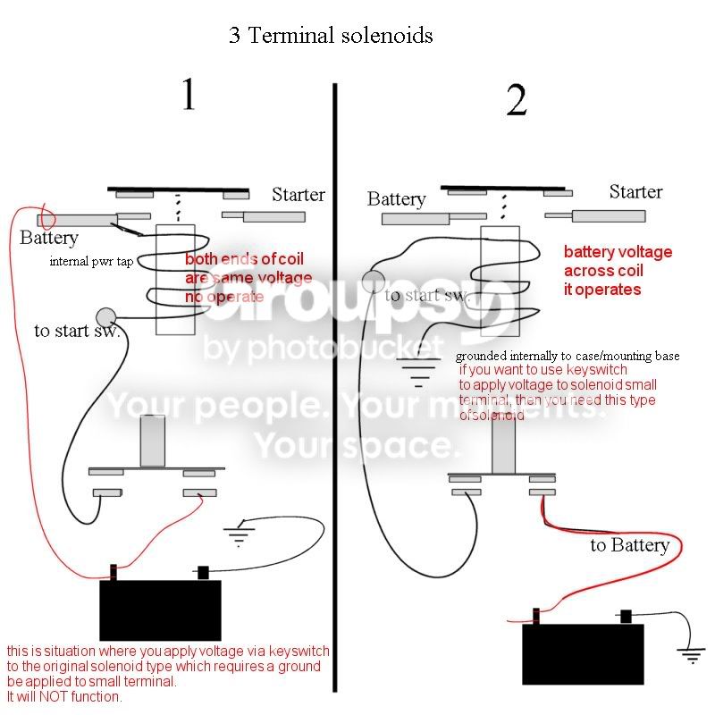

I started by putting in a new 12 volt coil and ran the "+" wire from the positive side of this coil to the resistor block, the negative side of the coil to the distributor. Once at the resistor block, I ran another wire from the oppposite side of the resistor to the new key switch, which I installed. I ran the "+" wire from the altenator to the "+" side of the new ammeter and another red wire from the wiring harness that the instructions told me to mount to the negative side of the ammeter. I then ran a wire from the battery connection post on the key switch to the Solenoid. I went over the directions several times, but don't seem to be getting anywhere. No turning over, no spark, nothing.
I ran to a near by John deere dealership three times on this day, in an attempt to get some advise. I showed the mechanics the wiring instructions and did everything they told me to do and then some, by still the key will not turn it over and if I jump the Solenoid with a pliers I still have no spark., nor will the key turn anything over.
I will be the first to admit, that I'm not very mecanically inclined, but really didn't think that this was that big of a job. Willing to take anyones advise on this issue, unless it is to sell the tractor. The directions seem very straight forward and don't feel so bad, since the guys at John Deere getting 100 plus an hour labor can't seem to figure it out, since I tried everything they told me to try.
I should mention that when I bought this tractor there was no ignition swith and that the previous owner had installed a cheap toggle switch that once flipped to the opposit diretion, you could use the standard push button in order to start the tracotor,under the 6 volt system. Since then I removed the toggle switch, no longer use the push buttoin switch and was hoping only on relying on using the new key switch in order to start and shut off the tractor.
The directions I have tell me to run the white wire from the wiring harness from the positive side of the coil to the resistor block, the other wire goes from the distributor to the negative side of the 12 v. coil. The the instructions tell me to run the one a red wire from the altenator to the positive side of the ammeter. Also within this wiring harness is a additional red wire and a yellow wire. Instructions say to run the other red wire to the negative side of the ammeter and the yellow wire to the ignition switch. This is what I did, but nothing. I also tried to run an additional wire from the ignition switch to the battery, just to see, but nothing. Oh, I also ran positive wire from the resistor to the switch as suggested, but still nothing.
