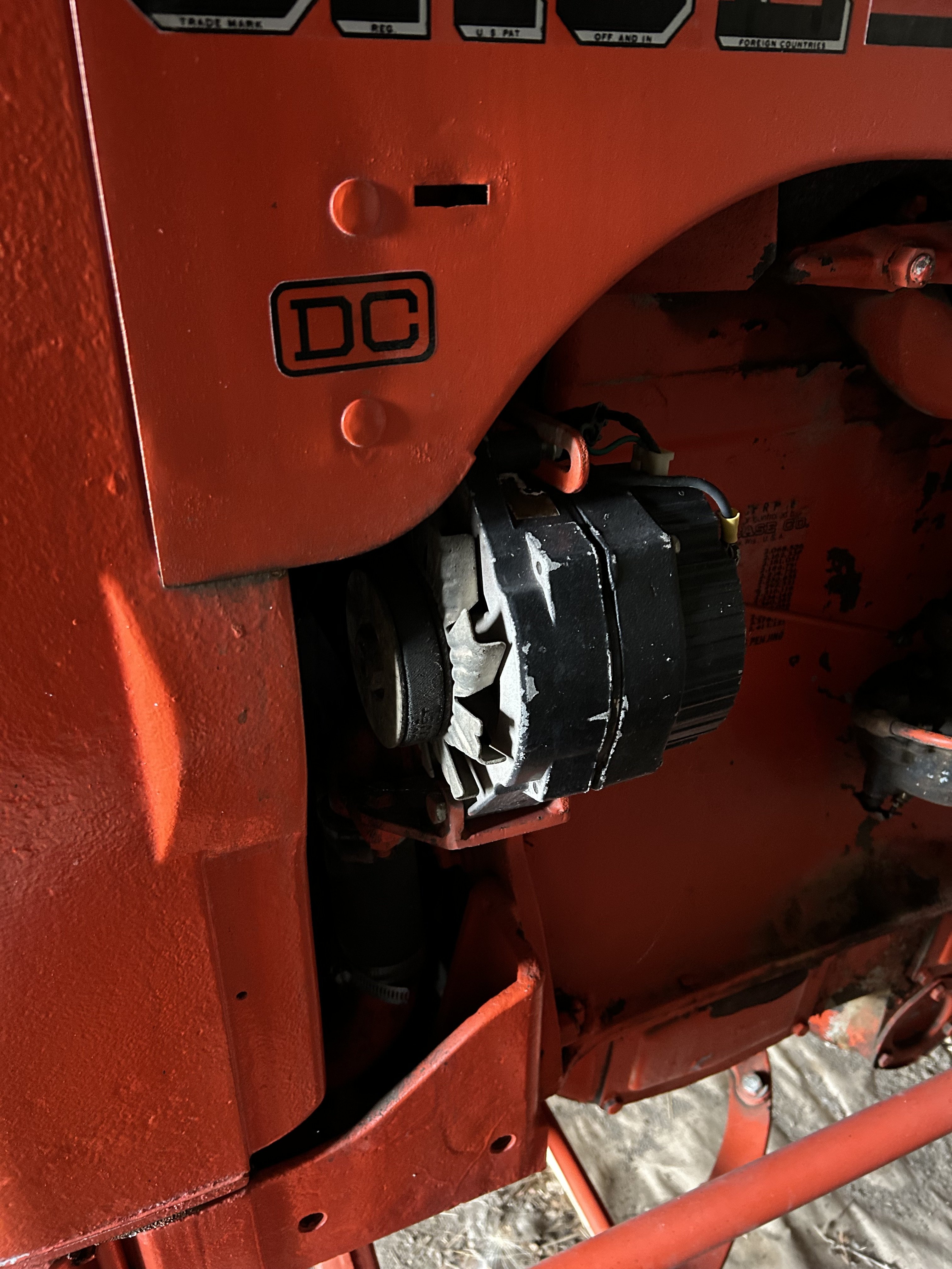

got new gauge installed and made a new gasket .I drove it around up hill full throttle and new the temp gauge slowly(20 minute) went up to near 220 . I stopped and let it idle and slowly the temp went to 205. The new gasket seems to have eliminated the steam. It was a warm day which Im sure didnt help. Belts are good and tensioned ok. Not sure what I should do next. Water pump looks like a bear to change.

I dont have the shutters. Spent all afternoon trying to get grill off. 2 bottom bolts were a bear, but I finally won. Removed generator but I cant get fan belt off. I loosened those 3 bolts after soaking with Blaster and hammered on them till they moved to the end of those slotts. Belt loosened but I still cant get the belt off the pulleys .Im about ready to just cut the belt off and worry about getting new belt on when I get it. After dark I'll do the suggested light test. 2 questions: Should I use the strong cleaning vineger? And is there a particular alternator I should get or just get any one wire alternator with the regulator in it? Thanks again guys

Did the light test last night and could see the light in front good. I'll hose it out anyways now that its open. NAPA store had a remanufactured alt. that I didn't see a name on but that's what I'll use. Gonna replace antifreeze with vinegar next

Good on both of you making progress! I don't remember doing anything special when I changed the fan belt on my DC but that was long ago, I did have the radiator off at the time so that may make it easier, it also seems to me that I had to take the fan off to install the alternator belt, but I'm not sure on that point any more.
I was.hopeing I wouldn't have to pull the radiator but your comment on the alternator belt makes sense and getting to the fan bolts looks impossible without pulling the radiator. Pulling it would make a lot of things easier so I'm gonna bite the bullet and just do it.
