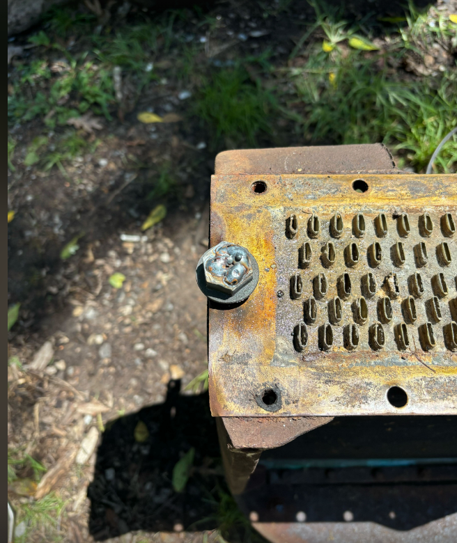

There are 14 bolts in the bottom and 16 in the top. The extra 2 in the top are those flathead screws on the outer edge. I welded nuts to the top of mine to get them out. Once all of those are out everything should separate, make sure the little shroud piece at the top is removed, if not the sides wont come apart. I did not see any shims in either one that I have just had a part.
If you are trying to get the core out then this is what you needed to do. Honestly at this point you might be money ahead to just put a new core in if you have it all apart, $350 for the core and gaskets plus the ride, mine is supposed to be here today, ordered it Friday

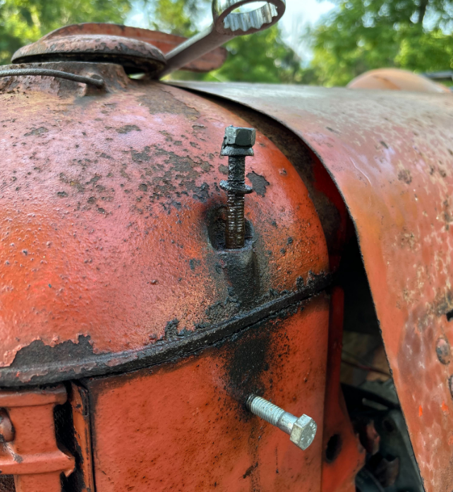

Nut welded to flat head screw ( work it back and forth even if it only "squeaks" a little bit of movement and spray a lot. Took me about 35 minutes to get both of mine out without breaking them. You can also see the burnt paint where I was heating the portion where the threads are, heat is your friend here)

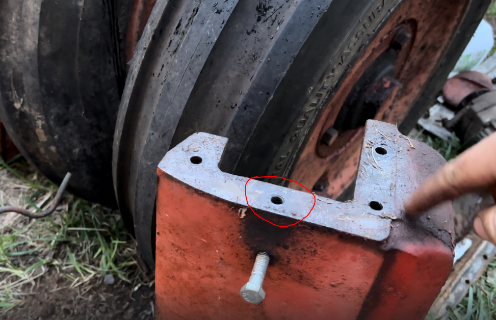

Top of the side piece, the circled hole is where that flat head screw threads into.

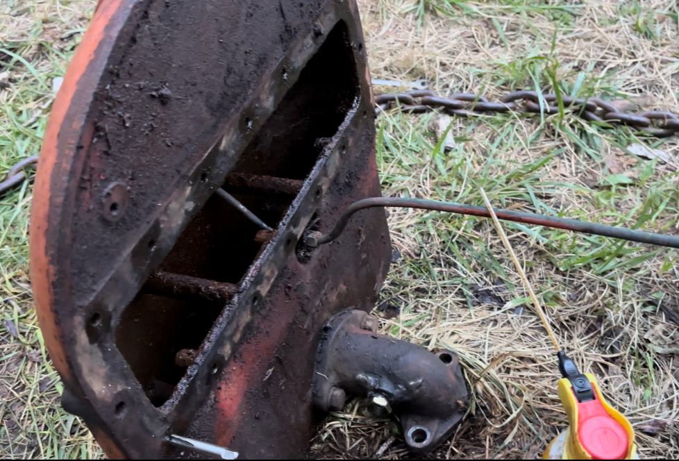

Top rad tank separated from the core
