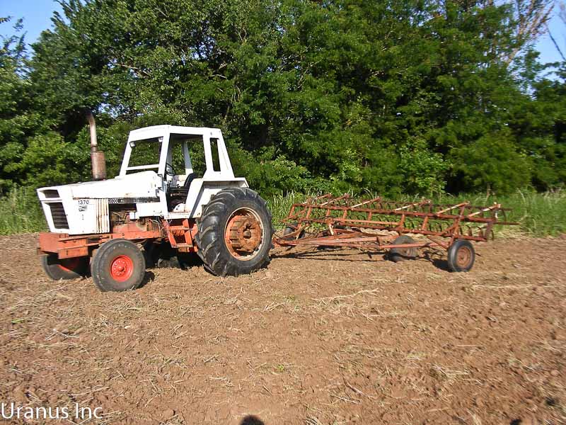

I know both a spring tooth and spike harrow like a harrowgator
are used as finishing tools, but whats the pros and cons of
each? Ive never used a spring tooth, only a harrowgator.
Pa had a spike tooth harrow, I had a spring tooth harrow. I always figured I could set mine to go through heavy trash without leaving bunches better then he could with his spike tooth. If no heavy trash there is no difference in performance.
Spring tooth could be set to go deeper and work the top layer of soil. Spike tooth or drag harrow would just smooth out the top. Neither one worked very good if there was still a lot of straw or stalks left on top.
What is the difference between those style harrows and a field cultivator? I use a field cultivator that is spring tooth on the front and has sturdy spike tooth drags on the back as levelers. Works well.
Same principle. Spring tooth and spike or drag were common decades ago. Modern field cultivators incorporate the same principle with the two often combined into a much larger, heavier, higher capacity implement.
You can start a hour sooner in the morning with a spring over a spike harrow---Tee
A spike tooth will break up large clods and leave a smooth surface, working the ground down. A spike tooth fluffs the ground, working deeper ground up, works well if the ground is still a bit wet to help it dry faster.
Put the spike tooth behind the spring tooth for a nice seed bed. I have used both pulled in combination behind the field cultivator,

We used a spring tooth to dig up weeds, the vibration would leave them on top to dry out and die. Like summer fallow but over a short time, then plant in the spring. Spike tooth was used to level and settle the soil, making a better smoother seed bed. We also had a springtooth with very narrow teeth or points that we ran through the clover and alfalfa fields to rip up the old dead crowns, rejuvenating the crowns and ripping out grass sod. This allowed the rain to penetrate better and allow fertilizer into the soil. Now I use a S-tine harrow, works great with the vibration....James

Pulling a spring tooth harrow across established sod just stretches the teeth out. It's not meant for that. It's meant for use on plowed ground.
You use a springtooth to finish before drilling. Disc the field, then run the springtooth at an angle to the furrows you make with the disc. Because you're at an angle,, the teeth will level the field, and fill in any furrows left. It also provides a cross hatch pattern which is at an angle to the direction you will pull your drill.......thus letting you know where you are, in respect to the last rows drilled.
Think of the teeth as little shovels that move the dirt in the direction you want.
