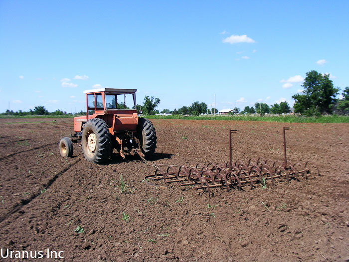

It looks like I'm guilty of misunderstanding. I've always used a springtooth to finish out before planting........not as a tillage tool.
Prior to getting a larger tractor, I used to use one that probably dated back to the 30"s or 40's. The process I was explaining can be seen here. Angling to the remaining furrow left by the finishing disc.

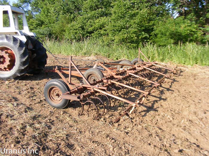

The "new" updated version was the same system, just wider. Probably not much newer vintage ROFLMAO. This was about the time I switched to using an offset disc to beat the weather. Climate change has hit us hard here. The Fall, and Winter, have become too dry to expect moisture for plowing when it should be done. I had to switch to an offset to get on/off the field faster in the Spring when we DID get moisture. Bigger tractor, wider faster implements.
