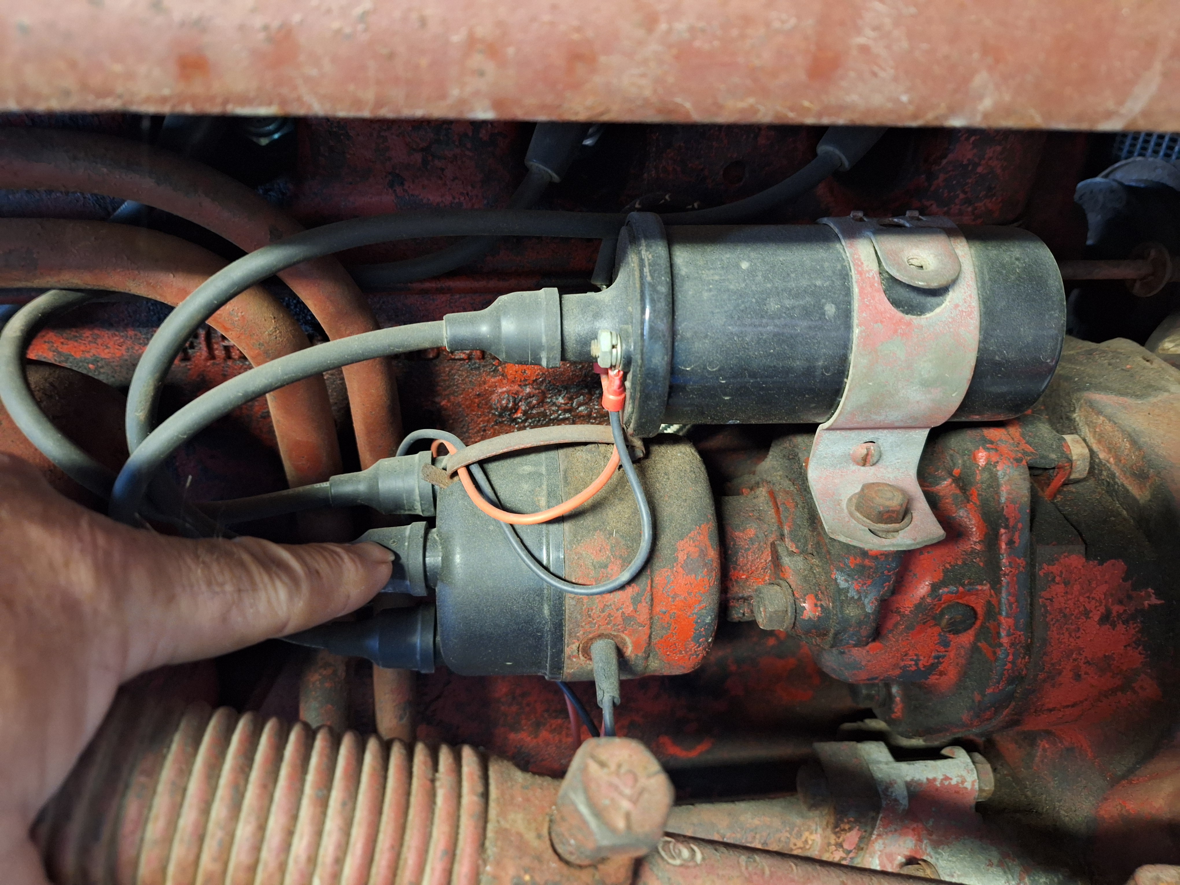

I'm going to assume that you have a battery ignition distributor system on your Super A like pictured, and not a magneto, although I don't see why one couldn't be installed if so desired in place of a regular distributor. A battery distributor will never have an audible click. The cap terminal that my finger is pointing at is terminal #1 for cylinder number 1, which is closest to the radiator as mentioned before. I suspect that it's very possible during the cap replacement that the plug wires were unintentionally plugged back into the wrong terminals. As stated before in prior post,the correct firing order is 1-3-4-2 with the rotor button turning in a clockwise rotation when viewed from the drivers seat. The plug wires need to correspond to the same firing order. An easy way to verify that the engine is timed correctly is to remove the spark plug in cylinder #1 and hold a finger in the plug hole while slowly spinning the engine over with the hand crank. Once significant air pressure is felt, stop and with a light, start looking into the cylinder and watch the piston move to the upmost movement while turning the engine over with the hand crank or fan blades. Once it's at the very most movement upwards, this will be top dead center (TDC). There are more sophisticated ways to get to this point, but this has always worked for me. Just be sure there is no way it could start while doing so. Once TDC has been achieved, pop the distributor cap off and see if the rotor button is pointing at tower #1 or REALLY close to it. If it's way off from being in the correct location, the distributor will need to be withdrawn from the drive housing by removing the 2 half inch wrench headed bolts that hold the half clamps down around the barrel of the distributor shaft stem. Once removed from the housing, turn the gear and shaft in the direction that it needs to go for the rotor to align with cap tower #1. While re-installing the complete distributor back into the tractor, be sure to try to keep the tower placement oriented at about the 1 o'clock position and not turn the shaft. It may be necessary to rotate the distributor a little both ways to find the best timing position ( aka....where it runs the smoothest) before locking it back down with the hold down bolts and clamps upon start up. Also to note....assuming it this distributor has points, they need to be gapped at .020 while on the high point of being open. If the distributor has to be removed from the tractor, this would be an excellent time to check on they're condition. Sorry for being long winded, but hope this helps.

He has a magneto, his original post was tacked on the end of a 2014 post on a Super H with a magneto and no spark.
Here is what he said there
“Im working on my grandfather's old farmall super a no spark not even at the points but the magneto had spark so I changed the points and now I have spark coming off them but not spark at the magneto”
