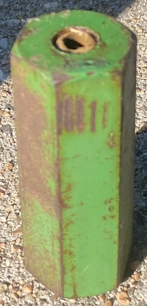

How remove broken bolt?
What's the appropriate tool to remove this broken bolt? This is a hydraulic limiter/regulator from a JD 7100 planter, for the markers.
The adapter broke off, at the top, in this picture, I want to get it out.
It's hollow.
Is there a screw that I can screw in one way, tighten it up against the the broken bolt/adapter, then turn it the other way to back it out?
What tool/screw should I use to remove the broken part?
Thank you!

Put that fitting on an anvil and hammer on all the flat sides around the break with some penetrating lube. Then use as n easy-out to remove that broken piece. That’s the tool for the job. I don’t think u need heat on it but you will see.

I don't know what's inside the flow restrictor you have. If it's heat sensitive, you'll have to rely on luck, and a long soak in PB Blaster before attempting to remove the broken piece.
They make lots of different tools for that job. Looks like an ideal application for a SCREW EXTRACTOR set like this:
This type simply threads backwards into the stuck fitting/screw/bolt until it wedges and if it's going to come out, it will come out.
If it was snapped off by something dropping on it, it should come right out. On the other hand, if it twisted off when you were trying to remove it, an extractor won't work. It will just strip out, or break off, leaving you with an even bigger problem of a diamond-hard piece of steel stuck in the hole that can't be drilled or extracted.
I would not try to extract that part without first applying a lot of heat. It broke because it was seized; it's not going to come out until the bond between the two parts has been broken. Rather than trying to heat the entire assembly, I'd use a brazing tip in an acetylene torch to focus heat on the small 'bolt'. Once the bolt is cherry red, an easy-out should be able to remove it.

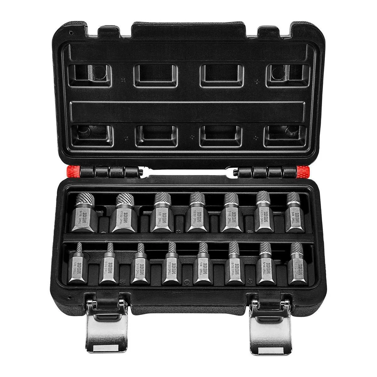

I have had the best luck with this type of extractor. I think that they have a wider cross section relative to the amount of engagement surface than any other so they will take significantly more torque without breaking. In addition they have a square cross section with four "blades" to dig into and hold onto the surface.

Those are what we used in our shop. They are much better than the spiral.
I never found any of them worked much on a good and stuck problem. Mostly drill or heat and then would come out. I always had to heat the outer piece then get it out before it cooled and sometimes had to heat it a second or third time but some times had to let cool completely before the second or third heating so it didn't all expand together. I suppose on your deal it will have some o-rings and such in it that you will need to replace upon reassembly or it wil leak or not work. So I guess I would try to weld a washer or nut to the top and see if it would come out . Being it is a hydraulic fitting vale it should not be to difficult to get out. I would probably squirt some diesel fuel on there or soak it in some for the day then try it. Better than heat ing if you can.

He said it was a hydraulic regulator of some sort. If there are any precision surfaces in there, heating it red hot and/or hammering on it is probably not a good idea.

What are those called?
