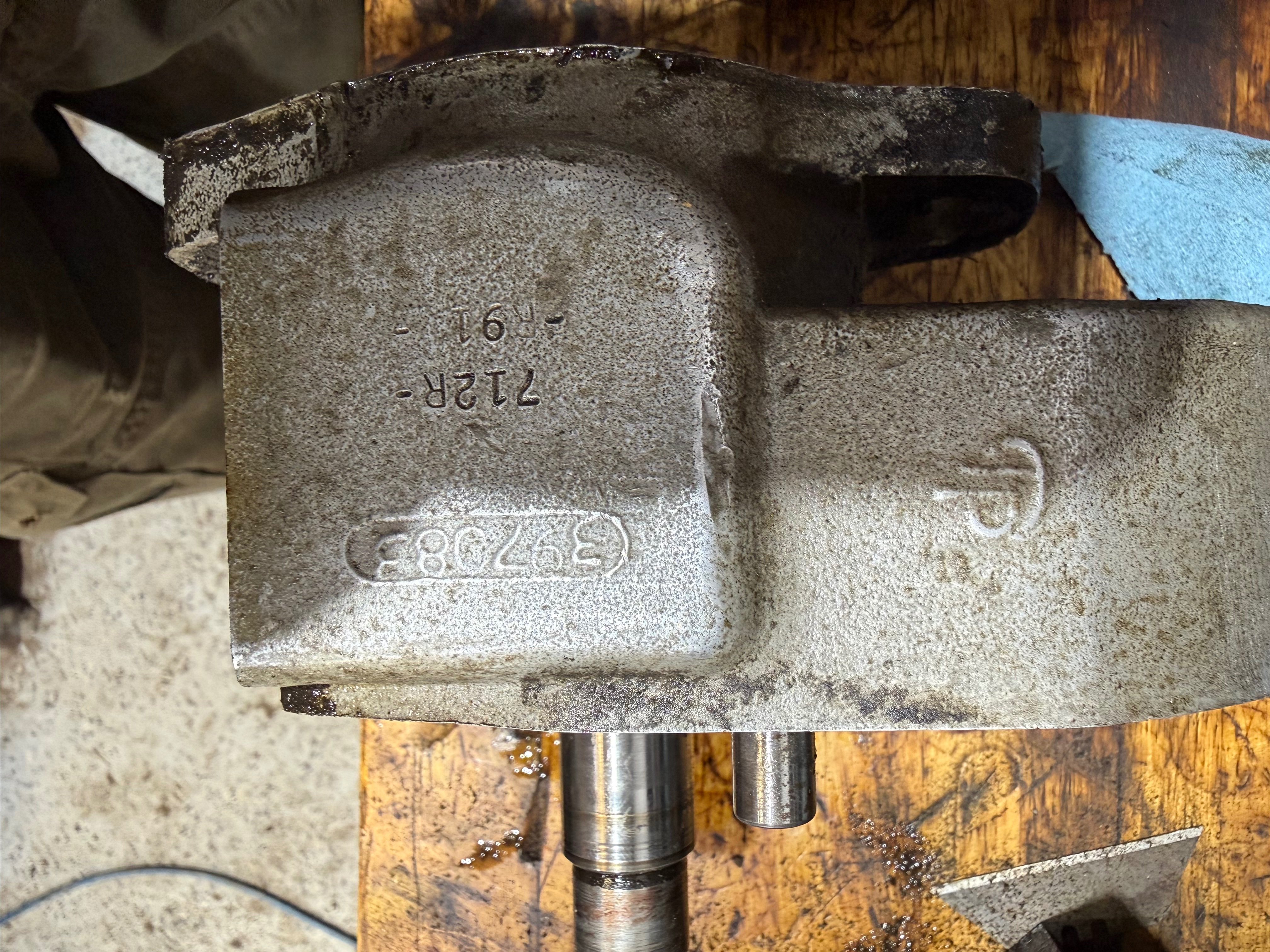

Does anyone who knows what they are talking about know if this pump is a Thompson or a Pesco or something else. There is a part number on the pump and a logo if that helps. I just need to know what it is so that I can order seals for it. TIA
That’s a Thompson pump that is what the TP cast in there stands for and the squarish bumped out protrusion also identifies it. See the link to the manufacturers parts catalog. CNHI 300U Thompson Hyd. Pump diagram
Arrow left on that web page to see the Pesco. If you save that link it will allow you to see all the parts diagrams for your tractor if you select different Functional Groups and Diagrams. On a phone click Table of Contents to get to the main index.

I will clean it up this ain’t my first rodeo lol. I figured it was a thompson based on the T on the logo and how it looked more square in my parks book but the part numbers just did not match up at all which is what led me here. Thanks for the speedy reply.
