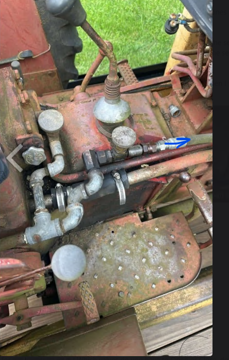

Hi, see photo below, does the hydraulic line that I drew the BLUE arrow on go to the loader lift cylinders?
If so we can have another go at getting the loader to lift.
1) With the hydraulic line to the rear capped.
2) Start tractor, make sure Draft control lever fully forward,
Move 3PT Raise lever to about half way up, mark this position as H for Hold.
3) Stop tractor, open both valves with the Round handles.
4) Close the Isolating valve.
5) Start the tractor at low idle and listen for any laboring of engine or hydraulic whine.
6) Move 3PT Raise lever towards the rear about 1" or so (Lift Position) and loader should lift then move lever back to the H mark
and loader should Hold its position, to lower loader move 3PT Raise lever about 1" forward (Lower position) and loader should lower,
and move lever back to H and it will Hold that height. If you want loader to Float on the ground then leave the 3PT Raise
lever in the same position as Lower position.
7) To Hold the loader at a constant position and then use the 3PT hitch, use 3PT Raise lever to Lift loader to desired height, then return to Hold position, next Stop tractor, Close both Round handle valves and Open the Isolator valve, start tractor now the 3PT Raise/Lower lever should control the 3PT lift arms and if there are no leaks in the Round handled valves or loader cylinders the loader should remain at the same height.
In the setup on your tractor to use the rear remote outlet to connect to a remote cylinder, you would use the same procedure as for the Loader but you would leave the Round lever valve by the right of the gear shift Closed.
I always recommend stopping tractor engine when Opening or Closing Isolator valve as there is a small danger of Dead Heading the hydraulic system.
Hope this helps.
Hope this helps.

This pic of the 444 operator station has the DIY loader hydraulic setup that I can't understand.
Here I've "circled" one of the valves in red. It doesn't screw to open/close, it just turns 90deg or so from center position in either direction. Not sure why as it doesn't seem to do anything
The other valve that goes to the left lower side of the tractor manifold (when sitting) does screw in/out to open/close apparently. I played with it and the main isolator valve, but I'll go through that lift tomorrow and update you on what I find.
The 3 point works great, and turning the isolator valve in does make it non operational so that function works.
