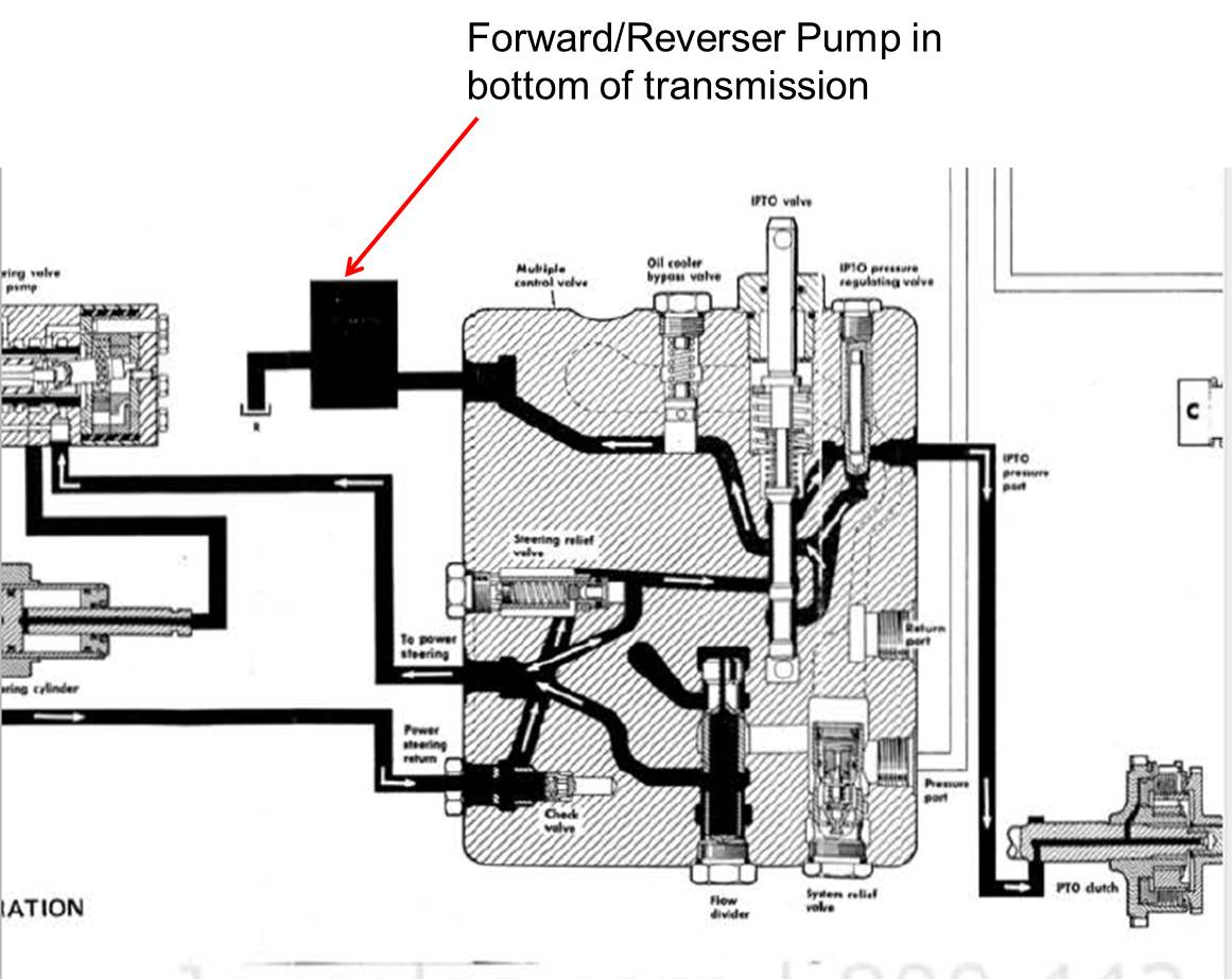

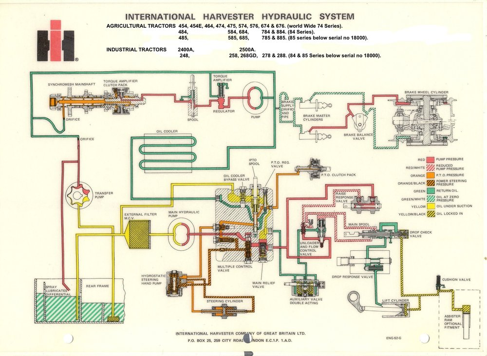

I have read other posts about the MCV (multi control valve) sticking causing similar problems - just wondering if the problems I am having sound like they could be an MCV valve or other issues like pump wear or leaking seals on the PTO or TA clutch packs. I would appreciate any suggestions on where to start looking.
Yes the Priority/Flow divider valve is sticking in the MCV, sometimes you can free it by dead heading the remote hydraulic valve.
The Hydraulic low pressure light is sensing the pressure on the return line from the oil cooler which is fed out from the power steering return from the MCV. The pressure sensors is under the seat with one wire on it.
See the two photos below, the first one shows Fwd/Rev pump but your 574 will not have that and this line feeds the oil cooler in front of the Rad.
There was a Poster on this site about a month ago with the same problem and he took the Priority/Flow Divider out of the MCV and polished it with fine emery cloth and that fixed the problem. The flashing low pressure light at low idle and hot is normal on these tractors as they age. My brother has a 684 that has been doing the same thing for 20+ years now. On the newer CIH 95, 32XX, 42XX series tractors CIH eliminated that sensor.
