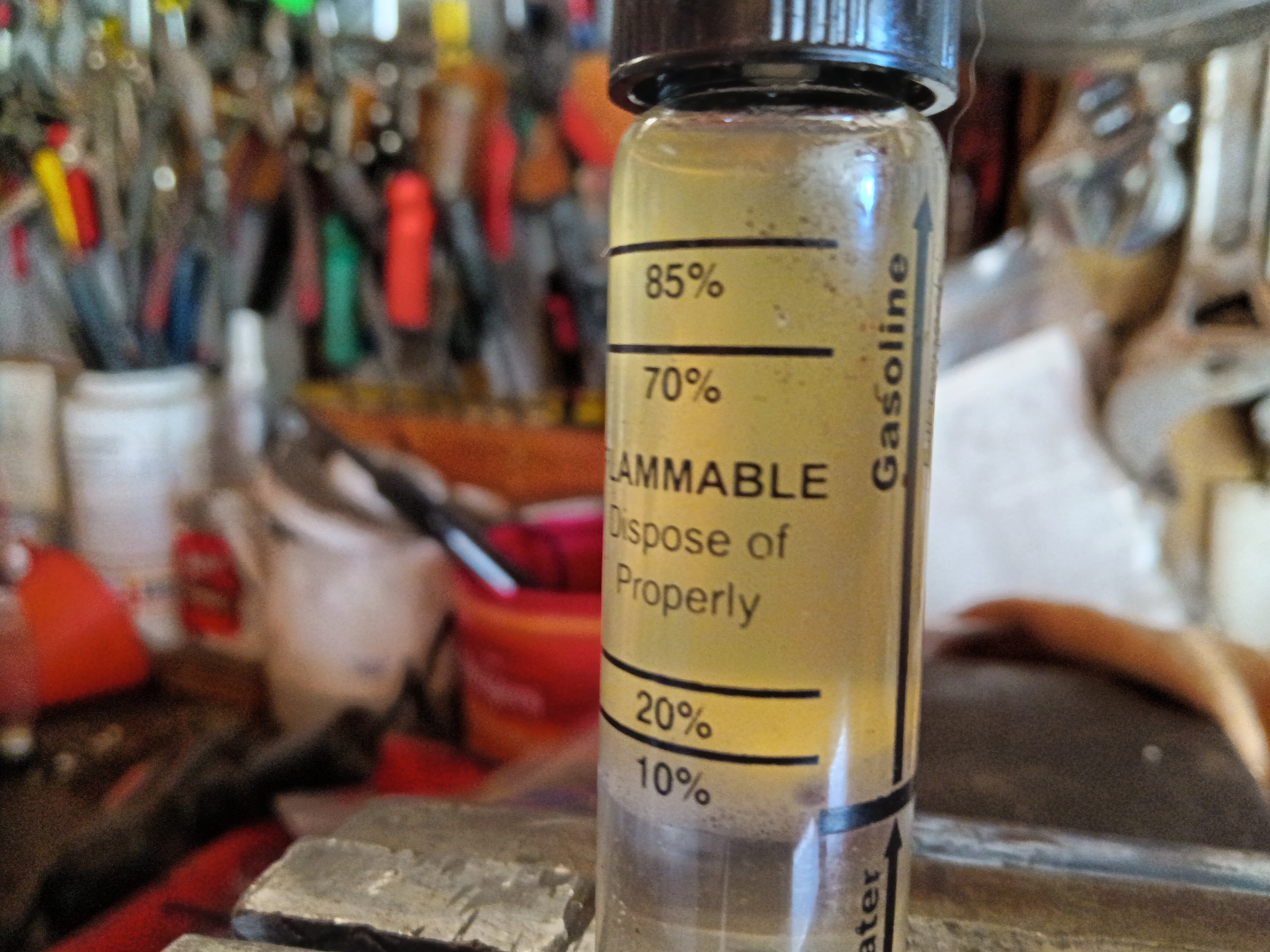

I have to ask. I have the same thing in my tank. they came to test for water as they were suspicious they had got water in the fuel. water test showed no water yet it looks just like yours in a jar.This is a cheap ethanal tester from Amazon,
Does water separate ethanol from gas?
Is the gas on top ethanol free? If so could one make a container to empty the bottom water Ethanol mix and leave the ethanol free gas on top?
It’s possible it will remove the corn squeezing’s. I drained a many tank with water in the fuel let it separate and pour the fuel back in the tank.This is a cheap ethanal tester from Amazon,

You are 100% correct! The base gas for fuel with ethanol is a low quality, low octane fuel. Usually around 84 octane in e10 where the ethanol brings the octane up to 87.Something to know about making your own ethanol free gas...
The gas that is used as a base for the fuel is much lower in octane than the 87 most cars use. The ethanol is added as an octane booster and to oxygenate the fuel. As such, the gas you end up with is much lower octane than the non-ethanol gas sold at the pumps.
So, you end up with low octane gas. Hardly practical to separate gas from the ethanol on any large scale.
