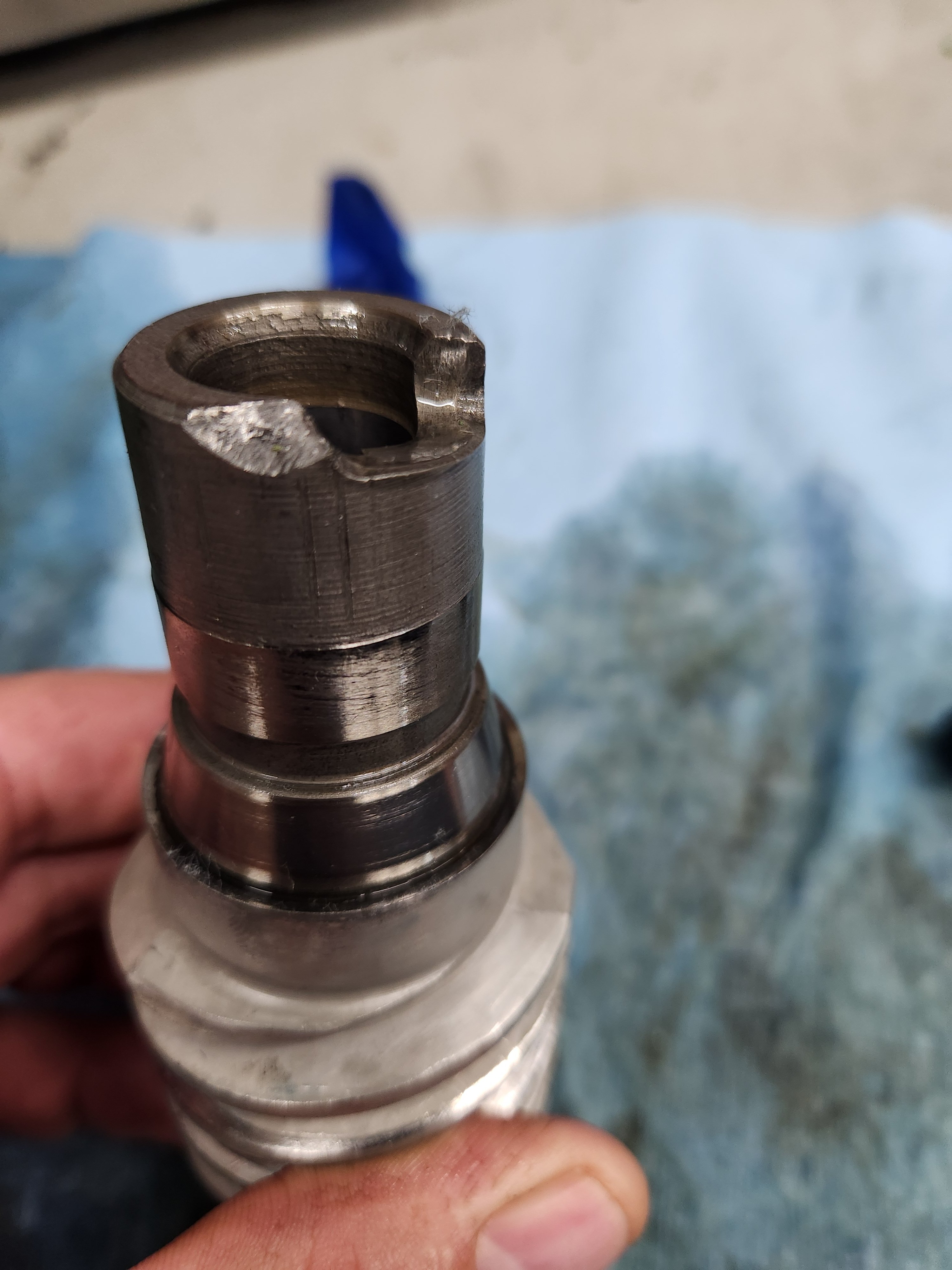

JD 620 Steering catch issue
Some wear, but considering age.
I replace all rings, and back up rings, when I have one apart, the vane seals go on easier if heated to 140 degrees in oil , hold the vane in a vise, and install seal, be careful with the vane seal corners, they tear easily.

In addition to warming up the vane seals in oil, file down the corners of the vane so there's no sharp edges. You'll find out it's not easy installing those seals without tearing or breaking them.
Another thing is try to get your steering gear 180 deg from the original place it was splined. This will give a new wear surface for the worm gear to ride on

I believe I now have all the parts and I am in the process of putting the steering cylinder back together and hoping to test everything together again this weekend. Started looking at the vane seals last night and removed both of the old ones, ended up tearing the first one while removing it and got the second one off in one piece. I am highly skeptical in my ability of getting the new ones back on without tearing guess we will see.
The vane seals were actually easier to put on then I had thought they were going to be. First used emery cloth to make sure there were no sharp edges on the vane, clamped the vane in the vise with the main flat face, pointing up, then heated one seal at a time in oil, started at corner 1 and worked my way around to 4. Used a small set of oring pick tools (more like a spoon on the end). Just be slow and gentle and didn't break either one.
Steering cylinder is back on the tractor as well as the steering worm/valve assembly. Seems to turn alright, but with front end off the ground and no load jury is still out. I have yet to put the front wheels back on yet since I am waiting on seals for the front hubs so I have not tried steering it with the front end on the ground.
