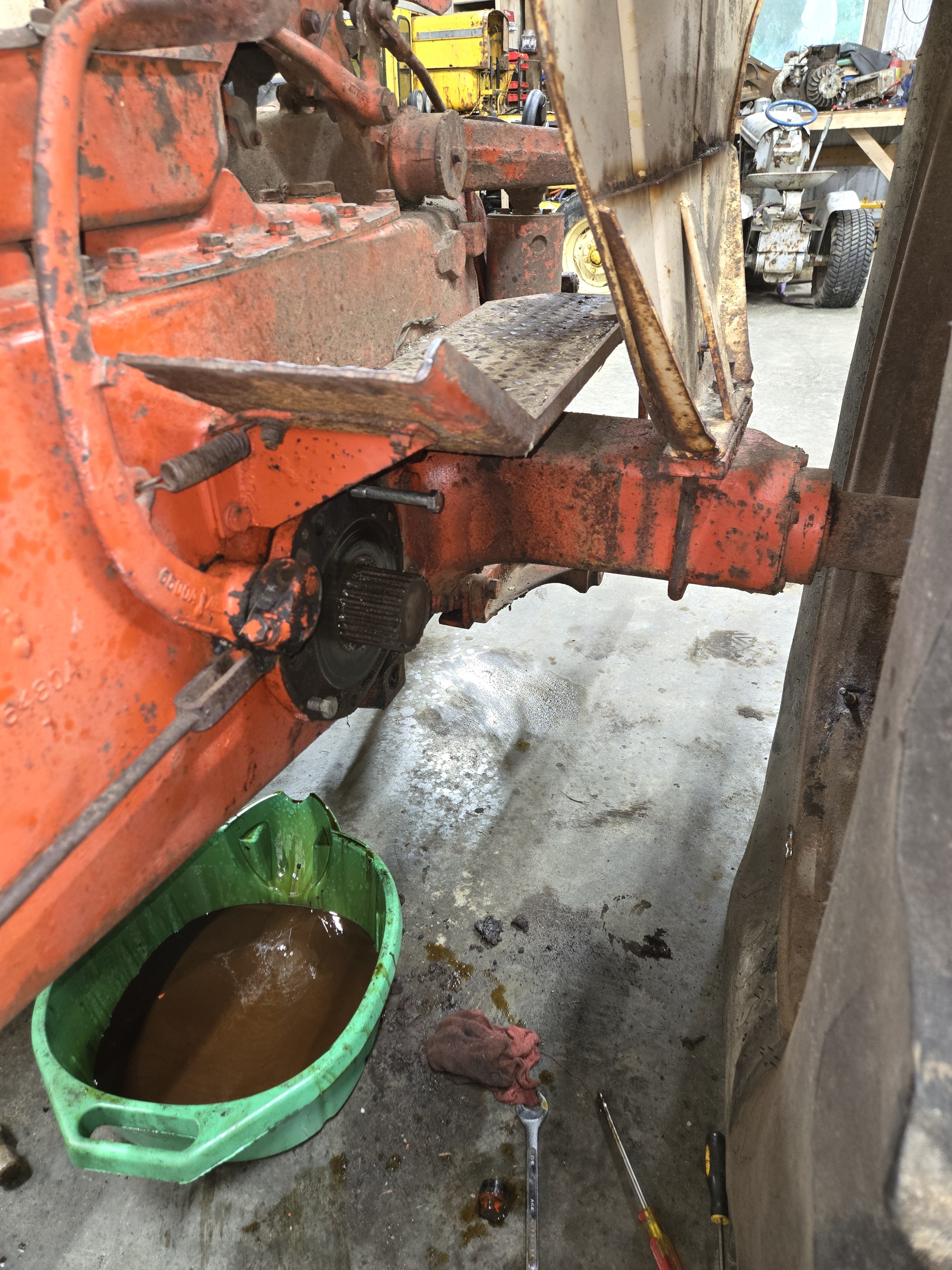

Okay so here's what we got going on now. Grease everywhere!! At least I think that helped get the parts off the shaft. Nothing rusted tight. Was a pain to find that sweet spot to get the cover off though. Only took 1 side off for now. I'd say the other side is probably in exactly the same condition. All the springs are broken, it pretty much just all fell apart. So monday I'll give john a call again for some more parts.
So my next real question is that seal. What's it supposed to look like? How do I get it out? Can I pull the inner brake surface that looks like it doubles as the differential bearing race? They have it off in the picture but are also supporting it above. They also have it alot farther apart then I plan on going.
Decided to go after the other side now as well. About half the grease as the first. Came off as one unit this time. Still can't really tell where the seal is.
The back plate needs to come off. The seal is in it, Make sure you keep the same number of shims on each side. Need to drain the oil down or it will run out when the plate comes off, Also need to cut a 20 oz. pop bottle down to wrap around the splines when going back together or you will cut the new seal on the splined shaft, Keeping track of the number of shims on each side is important for a quiet rearend when done.

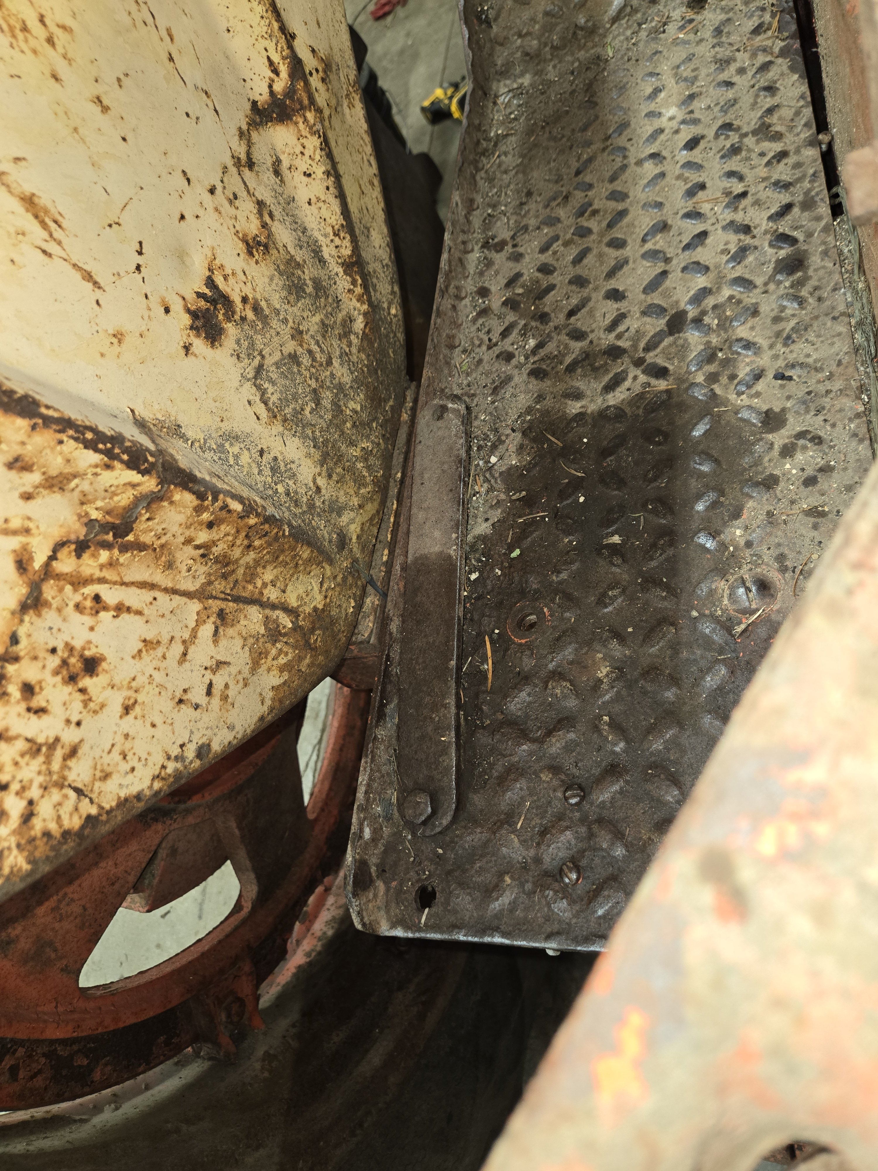

Thanks guys!! Got more parts on the way. But now im struggling to get those back plates off. Got one side to wiggle a little bit. Other side is stuck good. Got a couple through bolts applying some pressure to hopefully make enough room to get some penetrating fluid in there. Im going to pull the platforms off for more access so I can shove some wood wedges in places so it pulls more evenly. Anyways, what's the 1"x8" flat bar on the platform for? There's one on each side.
Well here's where we're at now. Got one side off, seals out. Parts showed up today. Still have some cleaning to do. The differential did drop so I'll have to jack it back up slightly to re align it. I like the idea of using some bolts with the head cut off to help realign the shims and set the cover. (Read that in another post on here). Pulled out 2 seals. Not sure if they are original or if someone has been in here before. John says one new modern seal will work, but im leaning more towards doing 2 seals each side. Im just a backyard mechanic, ill get that shaft as smooth as i can but im worried if its not perfect that oil will get past. Theres even a drian hole if oil does get past the seal. It was plugged though. I don't want to have to waste more time and money on this again.
Thanks guys!! Got more parts on the way. But now im struggling to get those back plates off. Got one side to wiggle a little bit. Other side is stuck good. Got a couple through bolts applying some pressure to hopefully make enough room to get some penetrating fluid in there. Im going to pull the platforms off for more access so I can shove some wood wedges in places so it pulls more evenly. Anyways, what's the 1"x8" flat bar on the platform for? There's one on each side.View attachment 117154
If I remember correctly, those strips of metal on my 400 had something to do with the heat houser mounting.
Well the brakes are back together and adjusted. Stops great now!! Thanks again everyone for the information.
