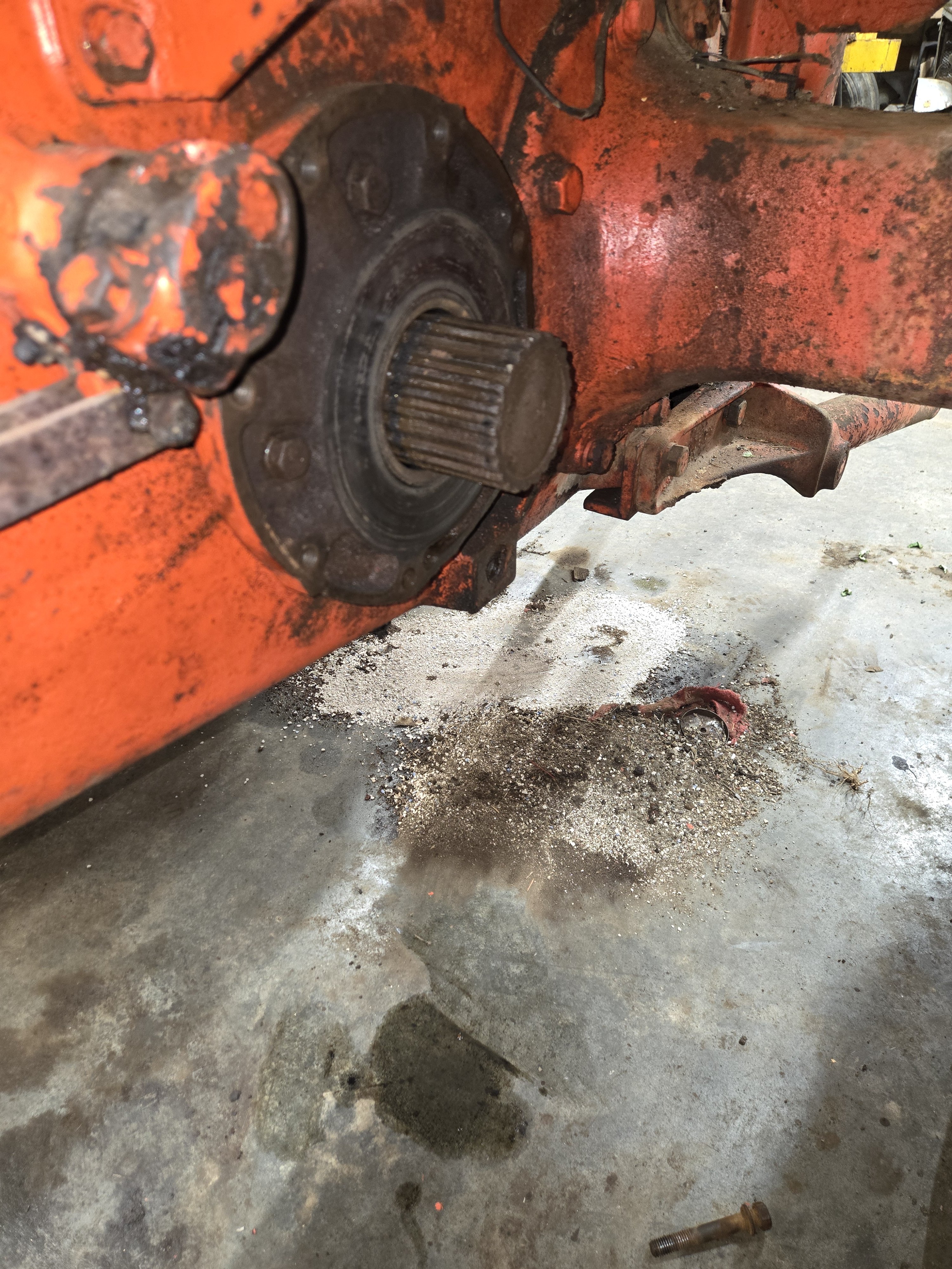

Nothing worse than having to go backwards. This side is leaking past the new seals. I put 2 new seals in each side. This side was in the worst shape when I originally took them apart. Going to have to pull it back apart and maybe clean the shaft some more. View attachment 119276
Cant belive it's leaking already. I've barely driven this tractor. Even put 85-140 in it.
85W140 is the correct oil. Any more than 1 seal is a waste. 930's & 1030's use only 1 of the same seal. If the shaft is messed up, a Speedie Sleeve will fix it. If you are determined to use 2 seals, they both go in the same way, spring side toward the oil. If they both don't go in spring side toward the oil, what good is the 2nd seal? If using 2 seals, put some heavy oil or grease between them to keep the seal wet.

Well back at it again. Currently have the differential cover off again, tried cleaning it up some more. Might have to speedi sleeve it as john mentioned. After measuring some, looks like the first seal sits about 7/16" off the bearing. Can kindof see a faint line. And the second seal isn't doing anything in that rough spot by the spline.

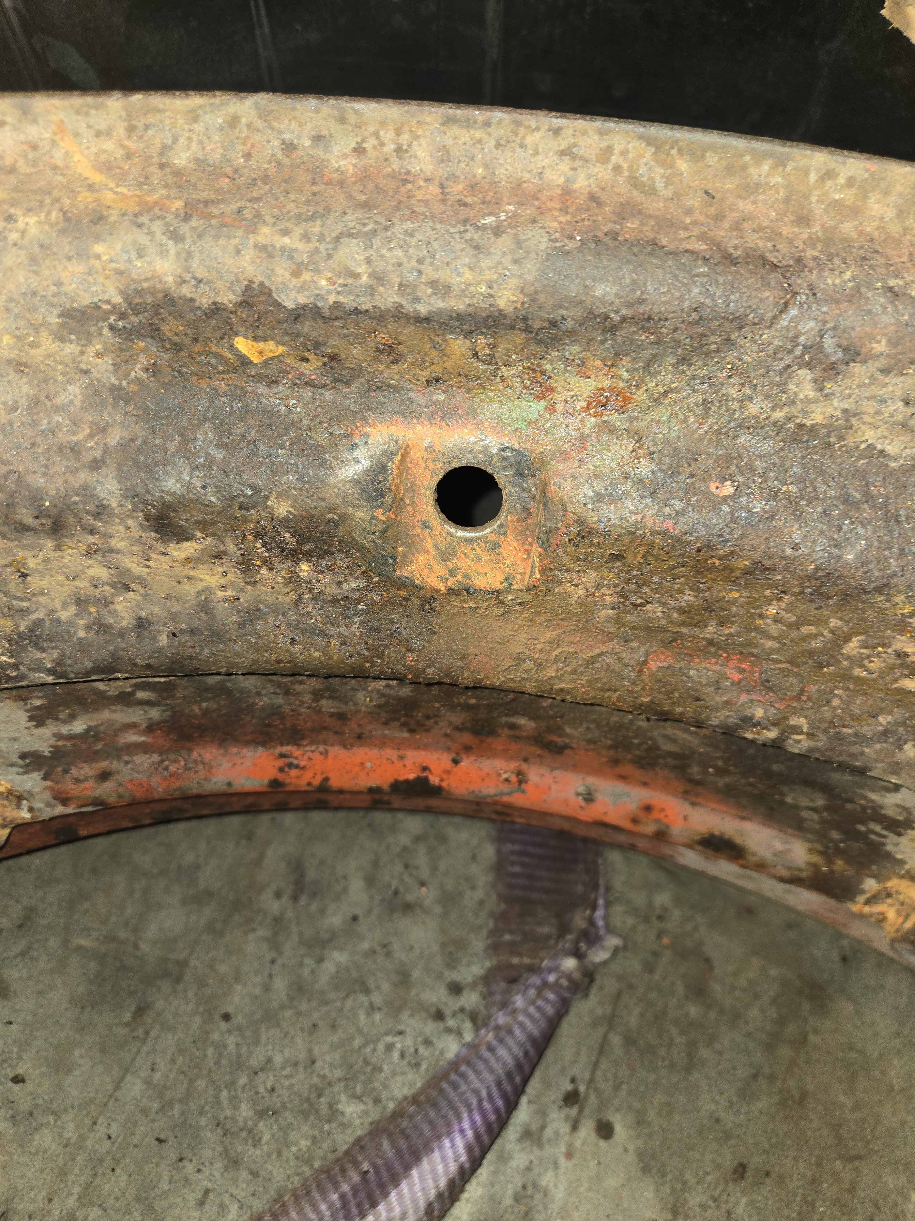

Also decided to attack the tire. Valve stem of the tube was cracked. Just enough to let the air out, and just enough fluid to alwasy be wet. Biggest tire ive worked on so far. Last one was the rear of a farmall a. This one kicked my butt at first, then finally gave in. That orange bead breaker is a life saver. Made that part easy. Hard part was trying to get that bead to initially come over the rim. Never messed with ballast before. I saved it in a couple barrels, pulled almost 600 pounds out of it. Fluid is clearish, has a hazy to it in the barrel. Wondeer what it is? Will it last in unsealed barrels? Might try to use it in a smaller tractor if possible. Only this side has it, other side is just air. So anyways, tonight's project is to put the new tube in and tire back together.
It fought me a bit, trying to get that last bit of tire over the rim was a pain. Im 5'-10" and 160 after i eat dinner. You need strength to get that last push. Kept telling myself "don't pinch the tube". The tire bead didn't want to fully seal. Had it up to 20 psi and was hitting the lugs with a sledge. Ended up lifting the tire up (which was really heavy because of all that air i put in it haha) and slamming it down.

You got it fixed, so problem solved. A couple thoughts. It looks like you only broke one bead down. I think that may have been one reason you fought it so much. I break both beads down. To me it is much easier to work the bead off the rim if the tire is not locked to the rim by the other bead. I also take the tire off the rim to clean things good. Some good paste type tire lube helps as well. Tru-Flate/Camel Tire mounting Compound, Murphy's Mounting Compound, and Ru-Glide are a few. Others will have their favorites. I keep a gallon bucket of the Tru-Flate around. It doesn't spoil and you can mix some with water if you want a liquid. To me brushing the paste on is better than the liquid when working beads over rims. Each to his own.
