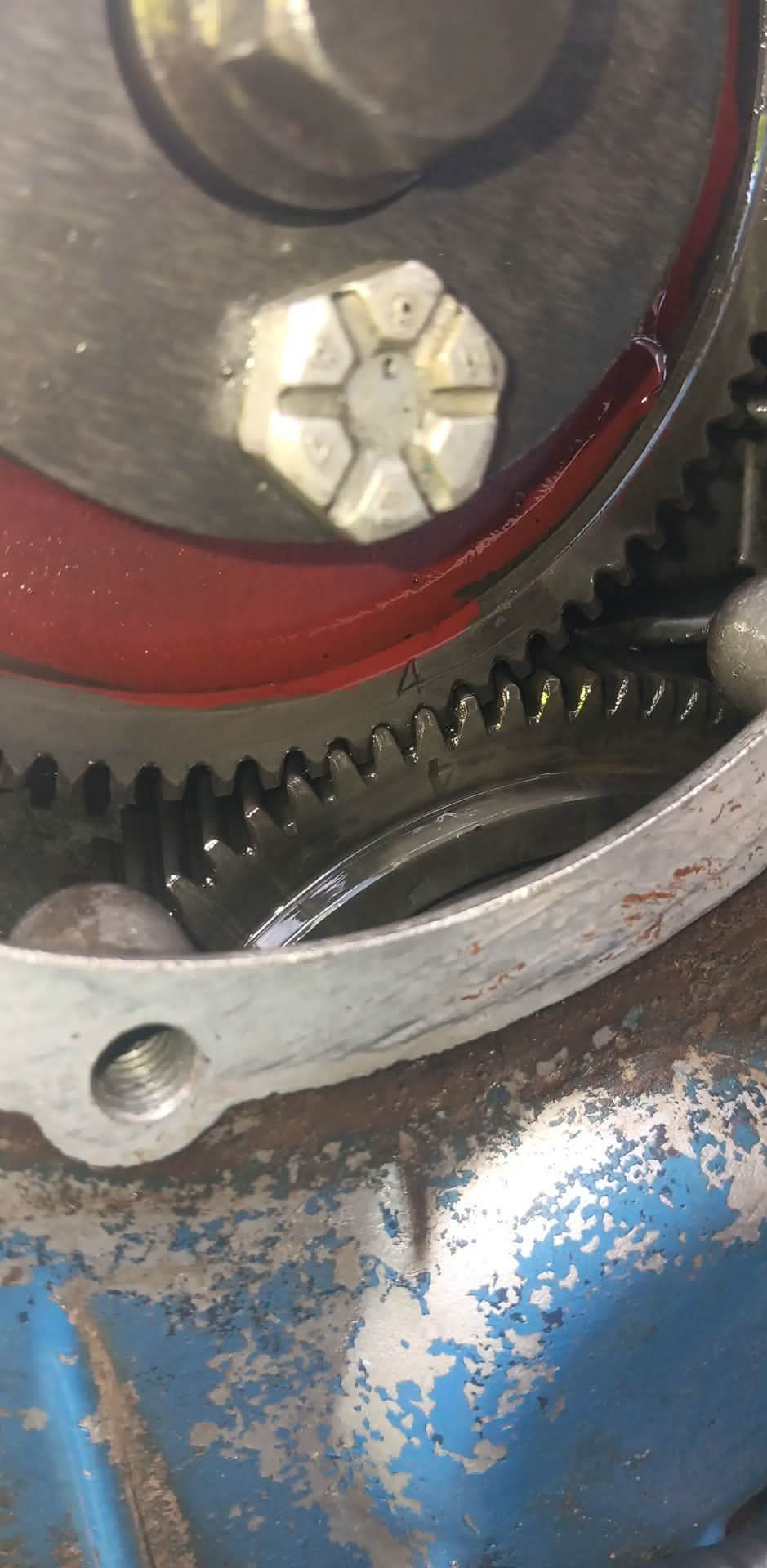

Long 610 injector pump timing
NatWester
New User
Does this look right?

Hello Nat, it looks like it could be right. Usually the timing marks on a diesel at the front pulley are a bit more refined broken into degree marks. Of course I believe those Longs are known for some short cuts.
What I really want to say is you should keep this all in one thread. If you step back and then come with a new development just keep adding replies to this thread. Otherwise folks have to look all over for past details.
I moved it 1 tooth.... 🤔
Oil pressure is almost 50psi @1500 rpm

Here is a.pic from a Long 360, 460, and 510 service manual that shows the timing marks
These are all 3 cylindet engines, but I believe they are very similar to the 4 cylinder engine in 560 or 610.
We have had Long tractors in the family since the 1970s. A brother has had a 610 for several years
I have only owned some of the 3 cylinder models.
