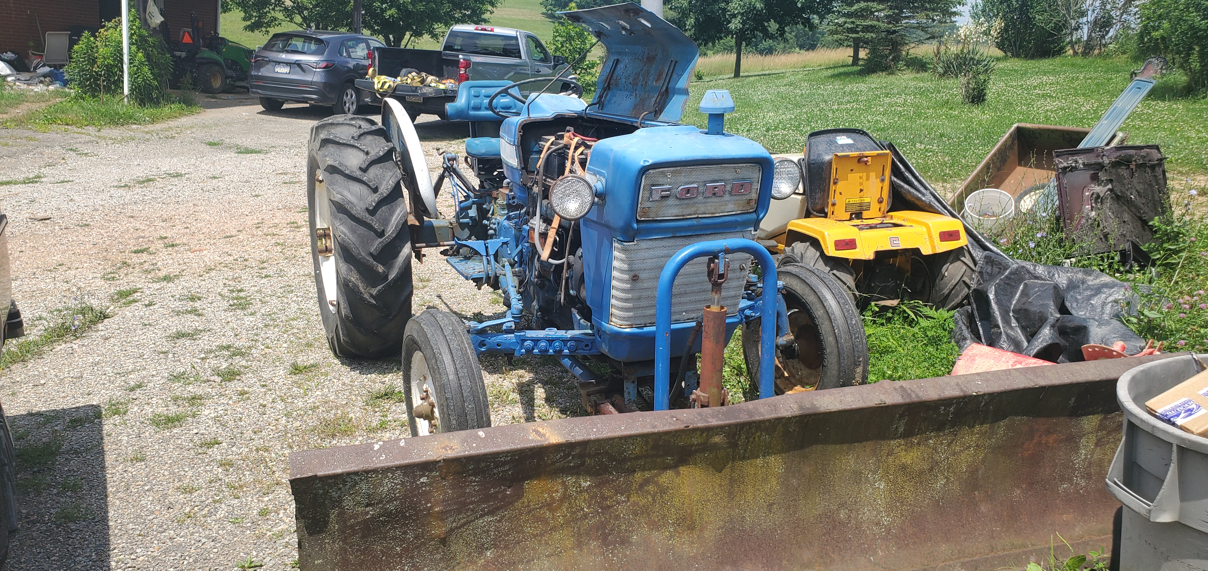

Just picked up a new toy:
View attachment 155963A mid 60s 3000 diesel select-o-speed.
I am well aware of the reputation of these machines, but for the work I'm doing and the price it was the best I could get. Eventually I plan on 8 speed swapping it, but for now it's keeping the select-o-speed. Lots of little things to fix and questions to ask.
-The steering cylinder on the right side needs seals, how does the end of the cylinder come off? I know it unthreads but it's tapered so it looks like it'll need a special tool.
-The radiator constantly leaks out of the overflow. Cap seems like it's barely holding pressure, what rating is it supposed to be?
-The blade is coming off because it is SHOT. It's a mess of torch cut steel, fabricobbled brackets, and booger welds. It's a 3 point moldboard stuck onto a modified Dearborn built workmaster blade frame. The hydraulic valve has a lift and what seems to be float position but it doesn't quite act like float. Am I correct in it being just two positions of float and lift? I want to add rear hydraulics eventually for lifting attachments.
-The PTO handle pulled out normally but now it seems the cable is stuck in the engaged position. How do I get access to free the cable up?
Looking forward to getting it all working good again!
Looks like my 1965 3000 sheet metal.
7* on the radiator cap pressure as I recall. The tank on top of the fins in the radiator is for liquid expansion when the tractor gets up to temperature. If you fill the tank all the way to the top when cold, it will vent out the overflow tube. Proper coolant is just above the top of the fins when cold.
I replaced my "packing" on one of my ford PS cylinders but don't remember the procedure. Seems that there are several different types of sealing mechanisms in the cylinder industry. I didn't need special tools once I figured out how to get it apart.
If you plan on pulling a roto-tiller with that tractor, keep the SOS.
If the bands start slipping, tightening is easy....on one side (left as I recall) of the tranny, about half way up is a threaded stud sticking out with a lock nut.....roughly 1" wrench size as I recall. On the other side are 2 such studs.....3 bands total. The shop manual tells you how to adjust the tension......recalling and may be somewhat in error was the procedure whereby you loosen the nut and screw the stud in until you feel tension then back off slightly and lock the nut. The amount of "band" material left on the internal shoes is obvious by how much of the stud is sticking out past the lock nut. Mine was worn to the point where the stud was at the end of its threads at the nut but still worked. If you have an inch of threads sticking out you are in great shape.

It's a 65.
I already got the coolant overflowing issue fixed with a new cap, the old cap only built 3 lbs of pressure, and the system was building more than that. Radiator has just enough resistance to flow across the core that the water pump's output slowly fills the top tank, causing it to overflow the rad.
I already resealed the steering cylinder but found a seriously scored part on the rod right in the middle so I don't anticipate it lasting.
I don't plan on running a tiller, and the SOS is already acting up: the inching pedal barely stops the tractor and it creeps in reverse, the PTO drags even when disengaged, the rockshaft seals are blown so the 3 point doesn't lift, and the position control doesn't work at all. Also, the brakes do nothing. I already have the 8 speed parts tractor to swap the diesel onto, since I got it running good.
It's a 65.
I had the PTO drag you mention also.....never did anything about it....just turned the tractor off when hooking up an implement......but that was on a '63ish 4 cylinder 4000. All my current, and most of those over the years were 8 speed, Live PTO........perfect for digging holes for fence posts in a row.
