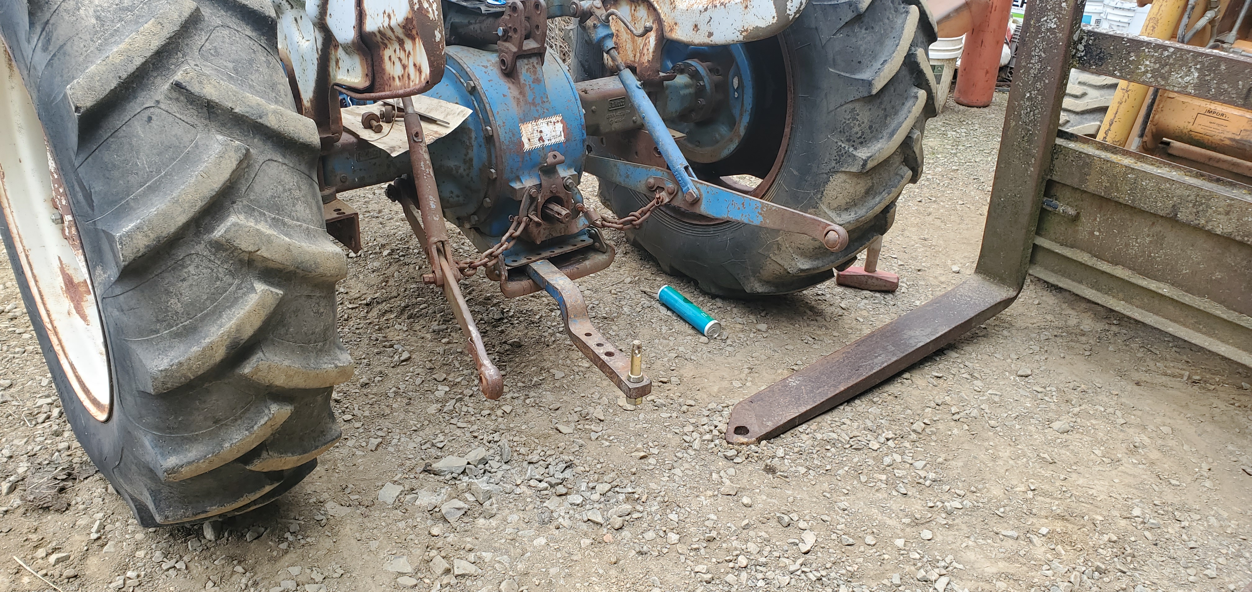

Drawbar obtained, had to fight it to get the drawbar into the bracket, and unfortunately the swing plate bracket is bent just enough that it doesn't swing freely... oh well, it moves with a hammer at least.
It was a nightmare to find since I haven't seen a single 2000 or 3000 with the drawbar for sale or parted out.

Sounds like you put a 4000 draw bar on your 3000, they look the same but 4000 draw bar is slightly thicker
