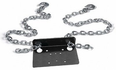

An old pig pole, a little scrap metal. Or just buy one.
Throw in a Portal winch mount.
Add a good winch and couple of snatch blocks.
You would not need to call anyone.
