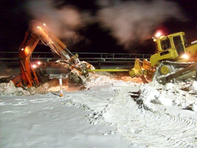

That excavator ain’t going anywhere… not with that setup… maybe if he backed up 2 feet and poured the coal to her , it would slingshot out
We slowly let that 8 dig a hole in the frozen pad and a very good operator in the hoe drug himself out. We did not have a winch cat available to us this day. Experience, patience and three 6 inch straps did the the job for Sam and I on this cold arctic morning. We did not stick the hoe, just tasked with getting out and back to the shop.
The OP may be gone but some of us are still out here trying. lol

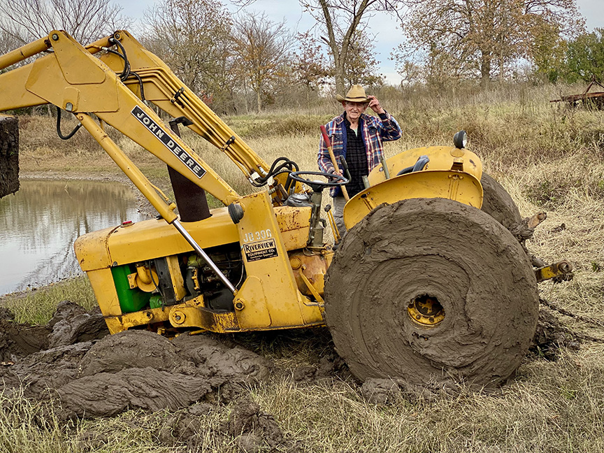

Going down the electric winch rabbit hole today. Right now the Harbor Freight 12,000lb Apex winch with wireless remote has my attention. My four wheel drive is an '02 toyota tundra and makes for a pretty good anchor to have a winch on with the tires chocked. I figure with a wireless remote in one hand and me back on the tractor would be a pretty good 1,2 punch of getting out of these messes. Bogged it twice this year and plan on more. :)
