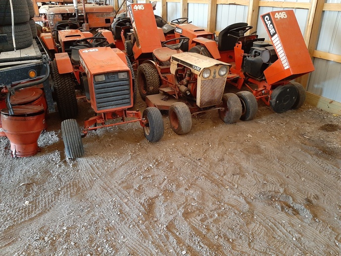

You will do well with this one, I think I have 10
