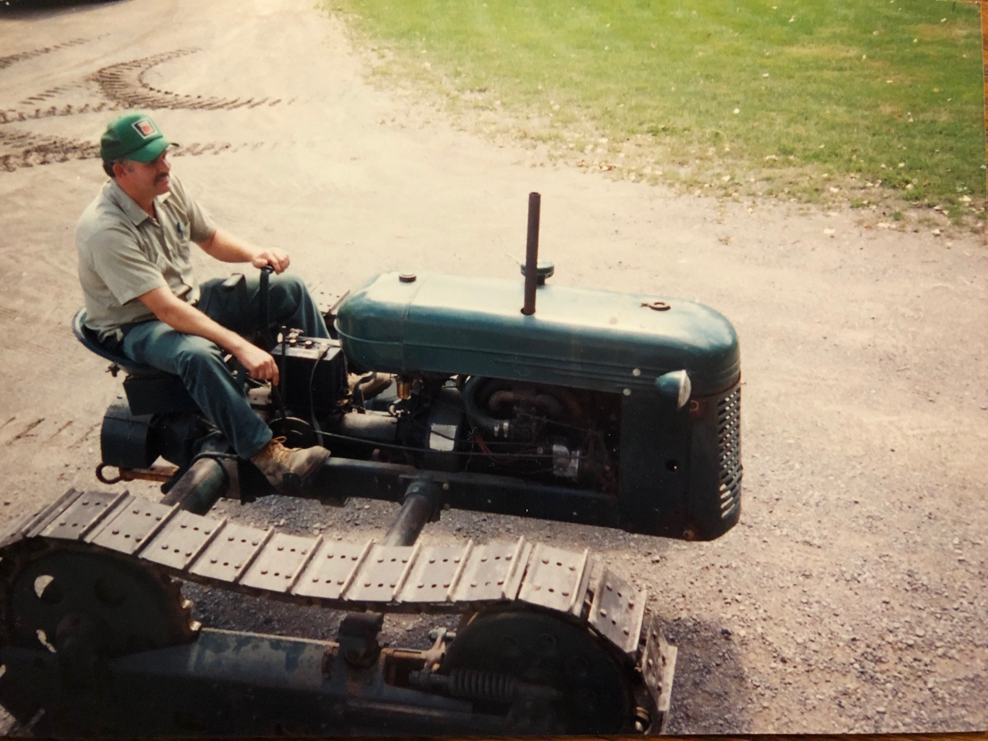

You know, my first thought was "Pass". It would be better if it only needed an engine than all the things that it does need. Then I was in the shower and started thinking. If I had a chance to buy it for that and it was close to home, I'd bring it home and sit on it until I could find a running tractor with rotted tires or a bad rear end. Something with a frame, like an AC WD, Massey Harris 22, I believe I even saw not too long ago where somebody used an Oliver 70. Take a torch and welder and modify the frame as needed and use the entire tractor engine, radiator, gas tank, hood and grill. You could make quite a conversation peice out of it.
I believe they built one using allis parts.
Is this the one you were talking about?
