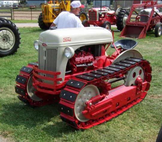

Ya, Ford bought a few undercarriages and built a prototype or two also, but it never went in to production.
No I thought someone home built one on here in recent past. It used an allis wc motor hood etc. I thought you and I were in on the conversation? There were pictures I even thought it was in Michigan.
How would the engine and transmission be coupled together if I put a 70 engine in it?
I don't think it would be too hard and there would be many options. You could have a second transmission in line. You would have to build a type of jack shaft to connect the two.
That's the one I was thinking of. You'd have to do some machining. Maybe a stub shaft and a chain coupler?

How hard do you guys think it would be to replicate this?
AM from what I see you could put a lot of combinations on that undercarriage and people have done so. My biggest issue is second transmission to slow them down (or uses a 4 speed). I think most of these are built as a street rod as such, not for work.
Looks like that little beauty has a flat head V8.

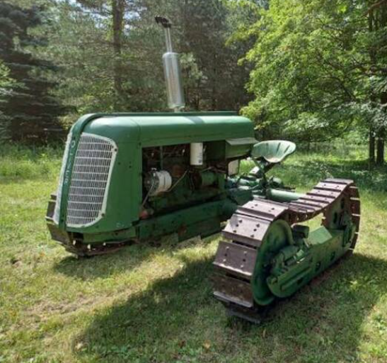

So I ended up buying the crawler. and over the last few days I finally got around to working on it. And I was surprised by how good of condition the motor is in. There was minimal surface rust on the one cylinder wall and two stuck valves. but I got everything freed up and cleaned now. I just put the head back on today and got it torqued to spec. It's got great compression and very good spark. so tomorrow it will be on to the fuel system.
Would any of you guys know if a starter from an Oliver 88 or some other tractor would work on the ixb-3 engine?
Very easy engine to work on. Doubt 88 starter will work. Any I ever saw had a worm drive and was hard to get. Do not expect t much power out of it and oc3 and hg needed lower gear.
