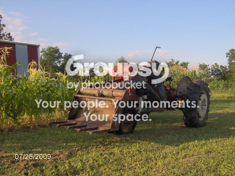

I got the 1 arm loader installed that I bought from FordFarmer. I see the ram bouncing up and down as I drive around, and I lost hyd pressure for a while. Shut it down and restarted and it started working again. Ran it for another 20 min and it worked fine.
Suspecting that I have air in the system. Is it possible that while it was setting, that air got into the ram? If so, how can I bleed it out? don't see any leaks and the hose had a connector on it so the hose was sealed while it sat.
Sure do like that big bucket on it. Will have to get a pic for you guys.

Soundguy/NWMO, thanks for the replies,
My sump holds 6 gallons of fluid and it was slightly overfilled prior to the install. When I extend it all the way, I still get some fluid coming out the overfill port (no stick on this tractor). I am getting erratic operation. Mostly it is slow, sometimes it will not move and rarely it will move at a good speed. Perhaps do I need to bleed the hyd pump again? We just rebuilt it, bled it and it was operating good prior to the loader install.
Also, if I lower it quickly I hear the hyd pump rattle. Should it do that?

Had a call with UD, and he set me straight on this. Valve is frozen in DA mode (Mode change screw broke off, badly rusted). We now have a workaround by plumbing the other port back into the sump. That should resolve the deadheading the pump issue and give me some time before winter to rebuild the valve. Not going to run it until I get this resolved or I risk blowing the pump. Is was just rebuilt last week so I would not be happy to mess it up.
